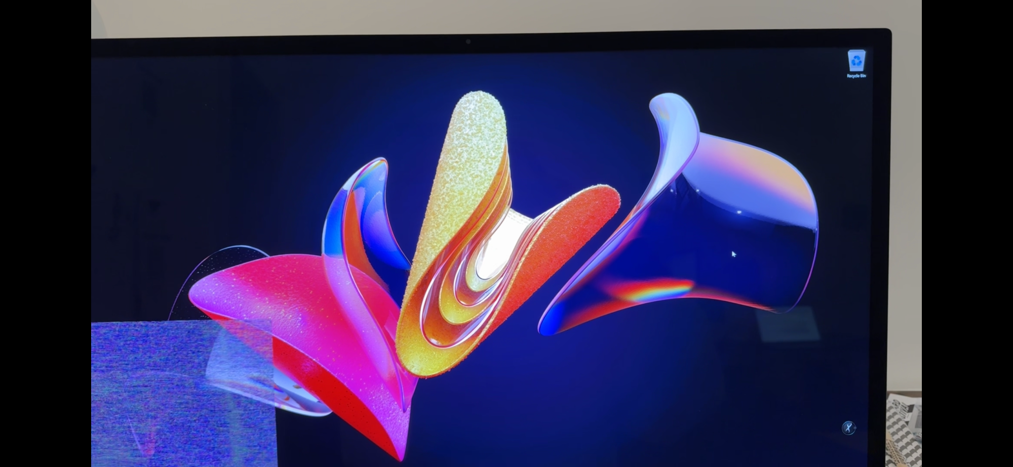

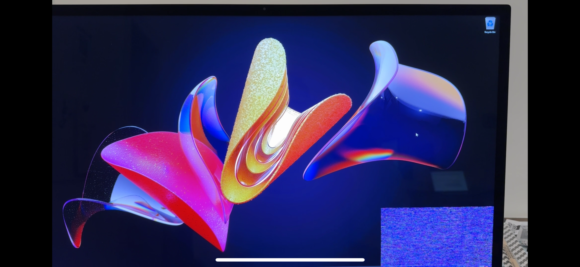

I’m having trouble with my newly purchased Studio Display. If I connect it to my mac, it works fine as expected. If I connect it to my work laptop, the display will briefly flicker on but then go black.
The USB ports work, so does the webcam and speakers. Windows is also detecting the display and detects it at the correct resolution. I’m able to move Windows to the screen and take a screenshot even though the display is black. When my IT department remotes into the machine, they can see the external display rendering as well.
Here’s a demonstration of what’s happening (please watch video).
First, it’s plugged into my wife’s laptop (we work for the same company but different model machine). You can see it’s fully functional, mirroring the display (which is expected).
Then I plug it into my mac. It shows an extended display (as expected) and the image remains.
Then I plug it into my work laptop, and it briefly flickers on for about a quarter second before shutting off. Peripherals all detected and working as expected.

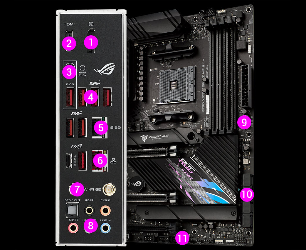

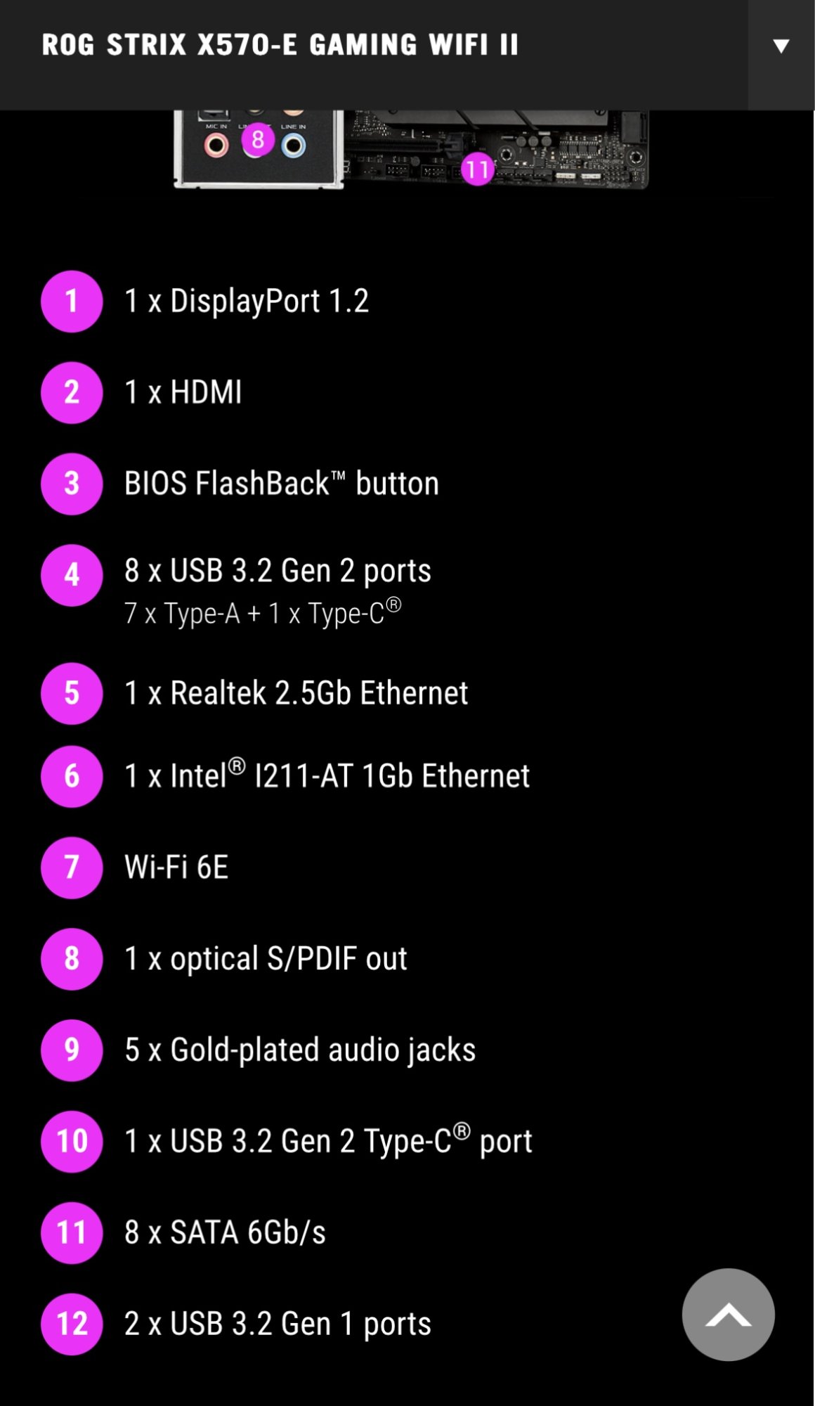

I am switching back and forth on the fly between a MacBook Pro M1 and a PC with the following setup and have a lot of issues with the PC‘s signal.
I have an ASUS ROG STRIX X570-E GAMING WIFI II motherboard without Thunderbolt Port, but with a Displayport 1.2 and a few USB 3.2 ports:
And I have the ASUS ROG Strix GeForce RTX 3090 OC with 2x HDMI 2.1 and 3x DisplayPort 1.4a

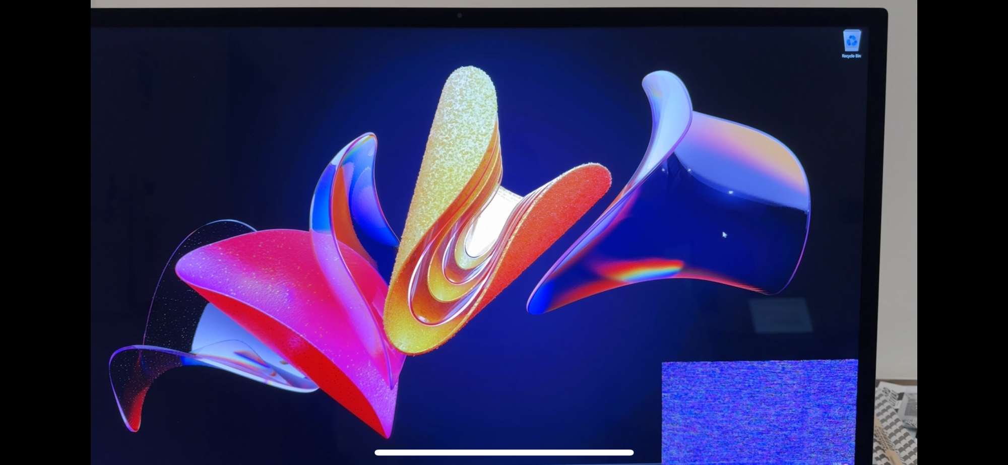

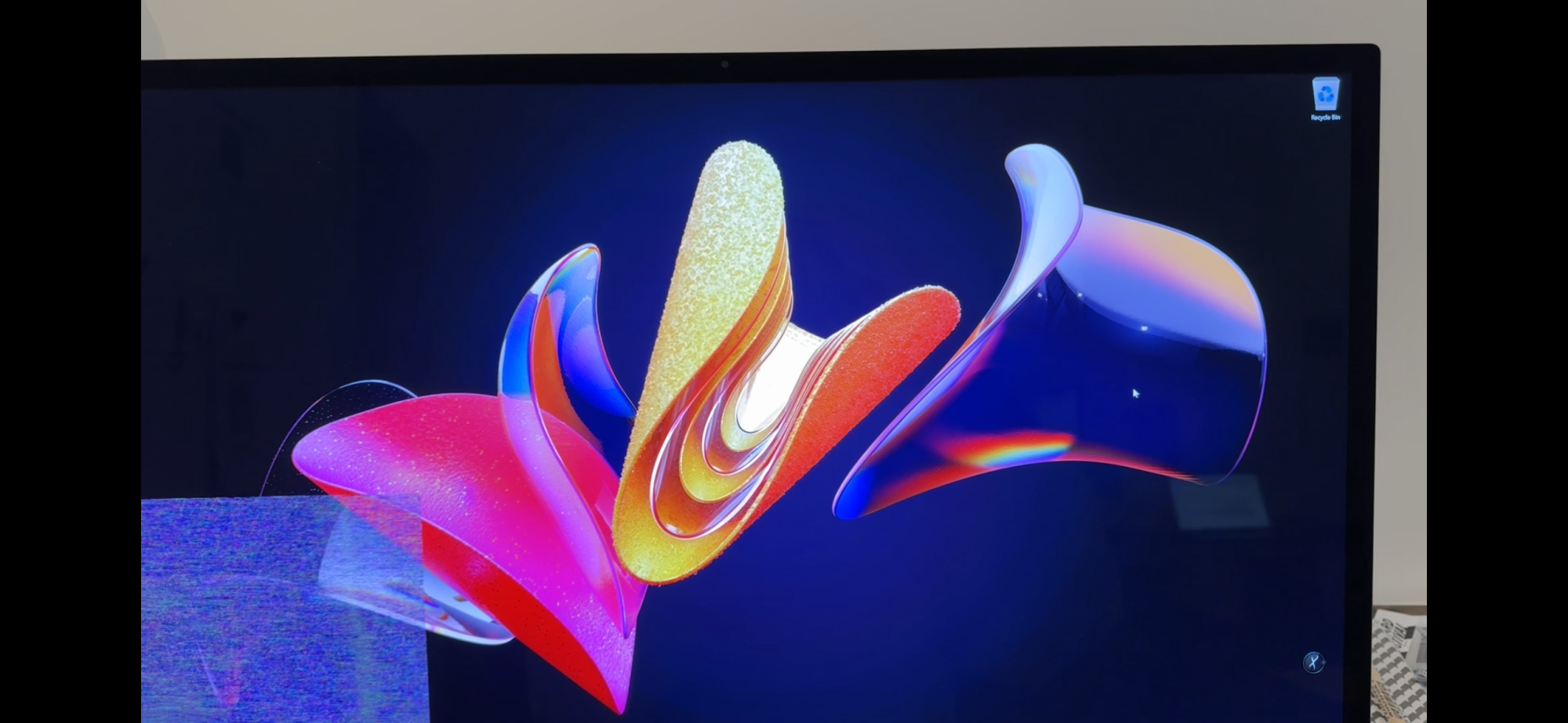

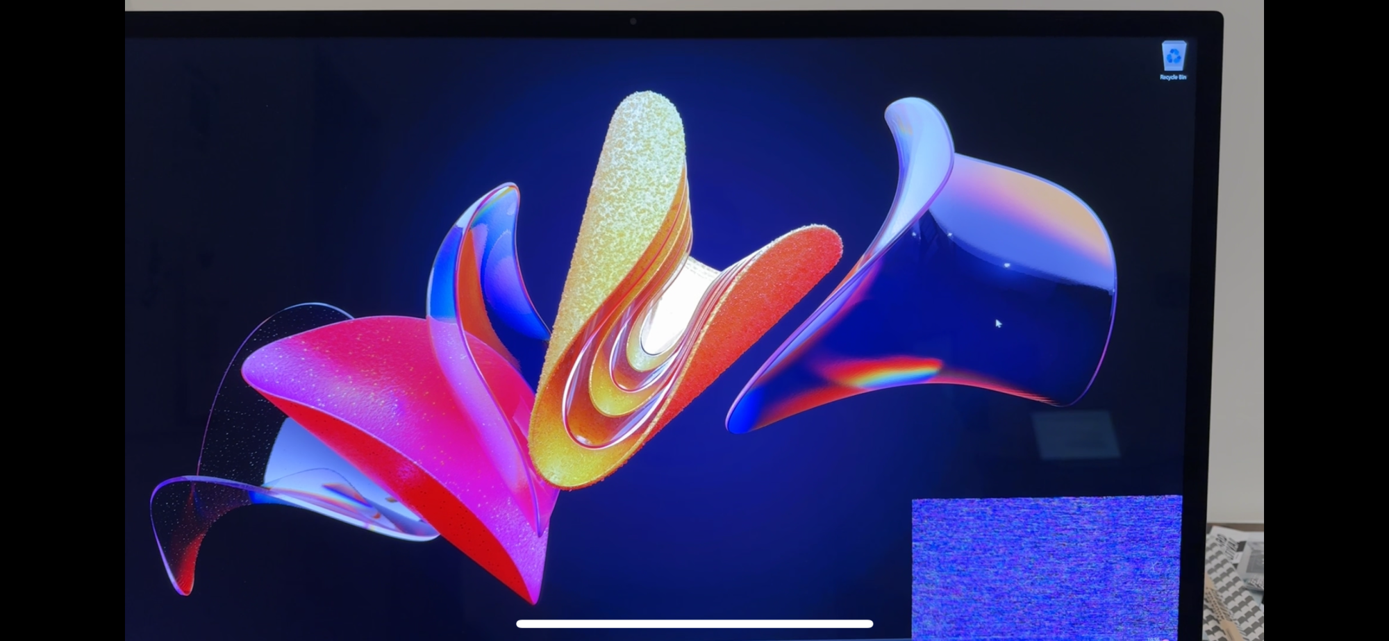

In the meantime I have tried the Cable Matters cable which works without speaker, camera and brightness support.
Same for the Moshi cable.
On top of this both of the cables above make scary and ugly glitches and screen outages in a frequency of seconds on my ASD:
With the Moshi cable there are times without glitches when I newly turn on the power of the PC or sometimes when it awakes from „Sleep“. When I switch from the MBP on the fly by switching the cables manually on the Apple Studio Display, glitches are guaranteed.
Both cables have to be connected to one of the RTX3090 Displayports in order to work.
The motherboard‘s Displayport 1.2 doesn‘t seem to provide any signal to the Apple Studio Display.

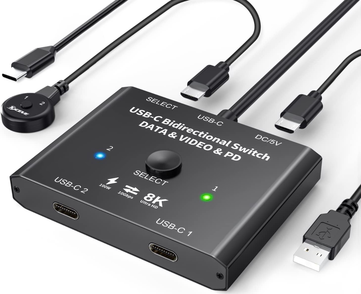

I also tried this bi-directional KVM from Amazon Germany https://amzn.eu/d/4YHE3ra which seems to have fried my Moshi Cable while MacBook Pro and PC have been connected. While I was working on my MacBook Pro and the PC was in Sleep mode I switched to the PC output port and the PC just didn‘t wake up anymore, where the RTX had a red blinking light on only. I then shut the PC down via the PSU Switch and restarted, without success, the ASD kept staying off. I then tried it again with a Cable Matters cable I still had and fortunately it worked again.
Returned the KVM and will probably never use such a device again after having this horrific experience.

Make sure your Belkin is the bidirectional 32 Gbps one and double check you are plugging into the right port on the ASD, otherwise with that setup it should work.
Thanks for the response @goodthymes. How do I know if the cable is the bidirectional 32 Gbps one? I just bought one off Aliexpress from one of the links here, but nothing on the box seems to indicate this.
@natsukosen those garbled squares are the result of a poor cable/connection, in my experience. Try switching to another DisplayPort output on your GPU. I use the WJESOG cable for best results.
