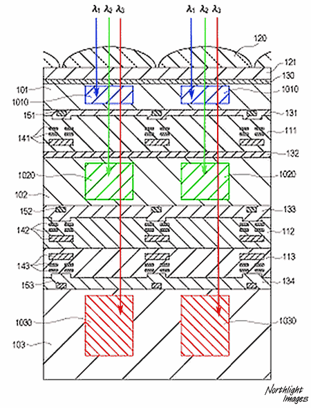

What I personally would like to see (maybe not 2015 but soon)
* bigger (1/2.4") sensor
* curved sensor with an alternative color layout (similar to Foveon or Sonys new patented color shift layer)
* 9-10MP (4k need about 8.4 MP and then people finally shut up about it ^^)
* other improvements in sensor technology

I'm not sure about what Sony's definition of "stacked sensor" design means, but from what I've read about it in general and particularly regarding potential upcoming sensors from Canon, you can pretty much throw what you know about more megapixels in a small sensor = worse quality out the window. Well, that's not entirely true, but it is to a certain extent. Let me explain.
From what I understand, you usually need three photo receptors to capture each of the red, green, and blue colors. These take up space on the sensor in two dimensions. The stacked sensor design utilizes three dimensions. Each photo receptor detects the level of red, green, and blue values depending on how far each wavelength of light penetrates through the various filters vertically into the chip. Thus you can get around three times the resolution because you have three times the surface area now without necessarily reducing image quality.
So, in theory, a 21 megapixel stacked sensor with the same dimensions as the current iPhone 6 sensor could actually have better image quality because tripling the current 8 megapixels gives you 24 megapixels, and the new design is 21 megapixels stacked, so more similar to a 7MP sensor pixel pitch. So there would be less photoreceptors per square milimeter, thus potentially reducing noise and other factors. POTENTIALLY. It all depends on the specifics of the stacked design and whether or not the interference between stacked receptors is worse, the same, or better than a standard array of receptors.
No, the 10-megapixel sensor would provide the better image. Each pixel would be bigger on the sensor, so allowing more photons in. The more photons, the more accurately each pixel is recreated.
Surely 4 pixels would collectively receive roughly the same amount of photons as 1 pixel, if they covered the same physical area. I would have thought the extra data would reduce the effects of noise etc, when scaled back down to the same res.

Also wanted to quote you for my response above. Do you know the specifics of Sony's stacked design? I don't have time to do a bunch of research right now but would love to hear some more answers on this.
A phone with proper optics and a larger sensor would be cool to enable shallow depth of field. That's the next 'breakthrough'. Until then it's all just gimmicks.
The development is the stacked arrangement - integrated on-chip signal processing. This, arguably, is a bigger deal for manufacturers than photographers - reduced component count, reduced space requirements, etc.
Do on-chip, column A/Ds count as on-chip signal processing? Or is the new thing here that we now have one A/D per pixel instead one per column? Or that things like raw conversion now occur on the sensor silicon?
And we don't really know whether the iPhone 6/+ sensor uses an integrated on-chip signal processing because Apple only tells us about the consumer-facing features like PD AF.
