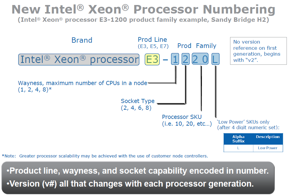

It likely isn't going to be 36xx. Intel has to adding "v2" after the product to indicate Ivy Bridge. The first two number prefix will stay the same.
Intel is deviating slightly but in general:
