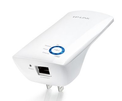

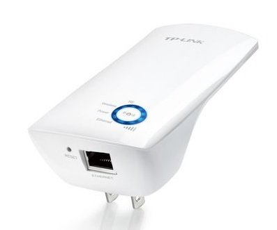

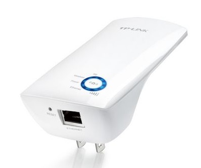

To get around the problem, I purchased a used 2.4 Ghz TP-Link WiFi extender that has an Ethernet port to provide Internet access to my a1427 via Ethernet. I've been using it this way for about a year.
Thanks for the advice! Apparently I will have to go that route to keep it alive.
