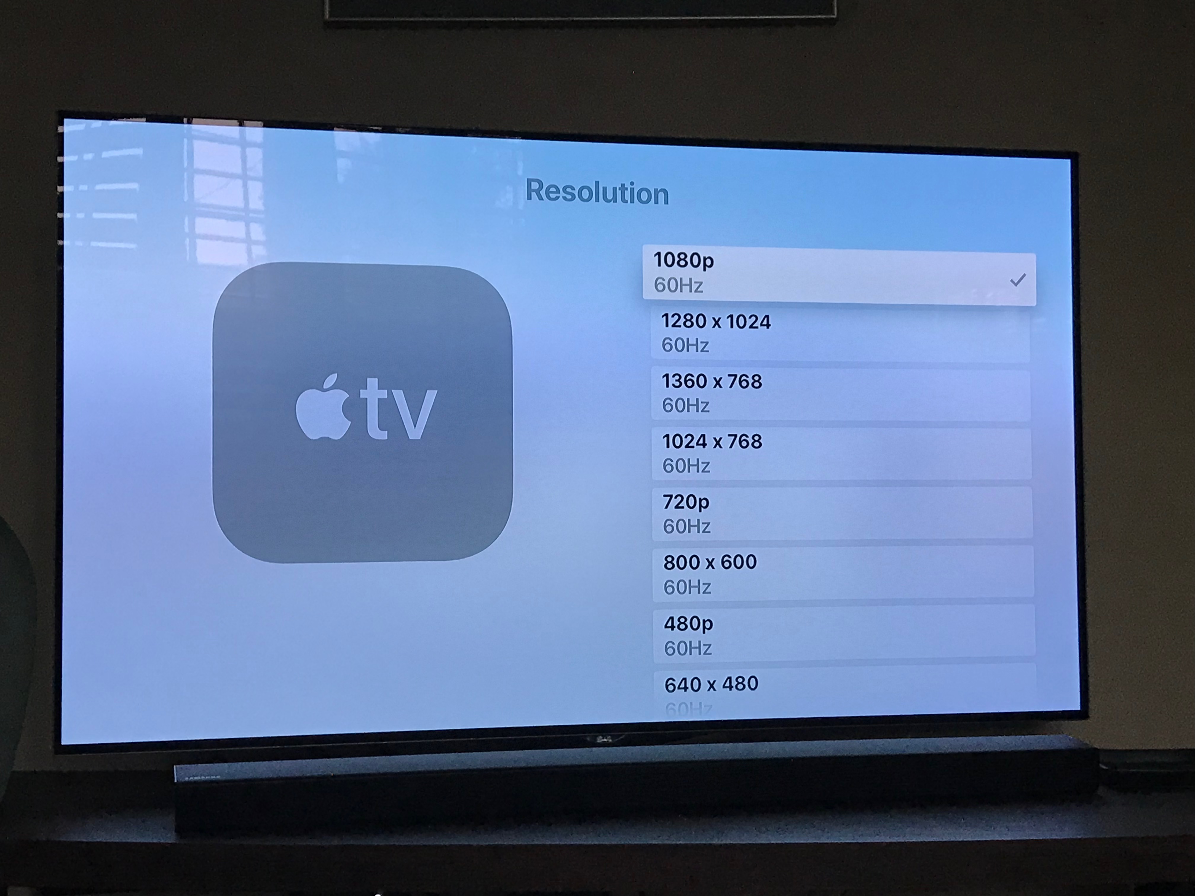

Hey ATV 4K fans. Can I ask a probably stupid question? I have the newest ATV (yay!), and a 2016 LG B6 OLED 55 inch TV (also yay!). When it comes to various options available to me in the ATV video and audio section, I haven't yet seen anything that says 4K as an output. The top option for me is 1080p, 60Hz. I know there's a lot of discussion about the 2016 LGs not being able to do certain HDR options at 60Hz, but I'm puzzled why I have NO 4K option on the ATV. I watched a movie last night -- Wonder Woman -- which when I swipe down, shows that it's in Double Vision, so I assume I'm getting 4K from the ATV. But am I? (Movie looked great, but maybe it's 1080p upscaled by the TV to 4K? Can anyone tell me why I don't see any 4K options in the on-screen menu on the ATV? Any advice really welcome! (Image attached of my on-screen menu.)
View attachment 720810 Hey ATV 4K fans. Can I ask a probably stupid question? I have the newest ATV (yay!), and a 2016 LG B6 OLED 55 inch TV (also yay!). When it comes to various options available to me in the ATV video and audio section, I haven't yet seen anything that says 4K as an output. The top option for me is 1080p, 60Hz. I know there's a lot of discussion about the 2016 LGs not being able to do certain HDR options at 60Hz, but I'm puzzled why I have NO 4K option on the ATV. I watched a movie last night -- Wonder Woman -- which when I swipe down, shows that it's in Double Vision, so I assume I'm getting 4K from the ATV. But am I? (Movie looked great, but maybe it's 1080p upscaled by the TV to 4K? Can anyone tell me why I don't see any 4K options in the on-screen menu on the ATV? Any advice really welcome! (Image attached of my on-screen menu.)
From what I know, did you explicitly enable deep color mode for thr HDMI input that ATV 4k has been connected to ? Did you also use a “premium” HDMI cable ? See:

Yup, I've enabled "HDMI Ultra HD Deep Color" on all four ports, and tried different ports. Same result. I don't think the cable is the issue, but I have ordered one of the Apple "recommended" ultra HDMI cables, just in case. It just strikes me as odd that, with the LG, which clearly does 4K and both HDR10 and Dolby Vision, I still have no options on the ATV for anything 4K.
Hmmmm.
Are you sure you got an "Apple TV 4K", and not an "Apple TV 4"?
That screen looks just like the one from my ATV 4.
The resolution settings are split over 2 screens on the ATV 4K, and look a little different.
With the names being so similar, it would be an easy mistake to make.
One tell tale sign is the 4 comes in a Black box while the 4K comes in a white box with 4K on the sides.
