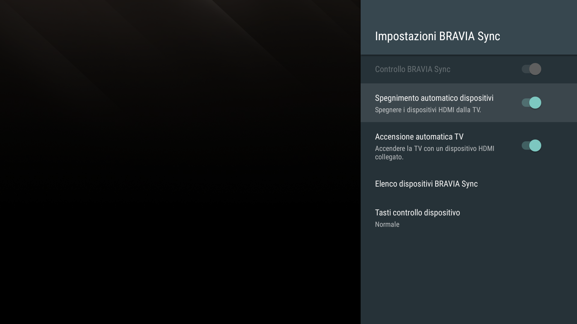

Oh. I didn't know about waiting the 1 minute thing. But I wait for a "Toast notification" from the TV, so I though the process was completed. And that alone doesn't always fix it. Something that seems to work fine with me is turning OFF and then ON the option to "automatically turn off the HDMI devices. Like the second option in the attached picture (not sure how to attach a local picture on this forum! Oh.. It worked! 😀 ):
I just tested it now, and only changing that, waiting a minute, the ATV 4K turned off turning off the TV. I must say that previously I tried to connect to the ATV from the ATV device in Home. That alone didn't fix anything. Then I tried with this method and it worked once. I did the trick again and it turned off the ATV.
