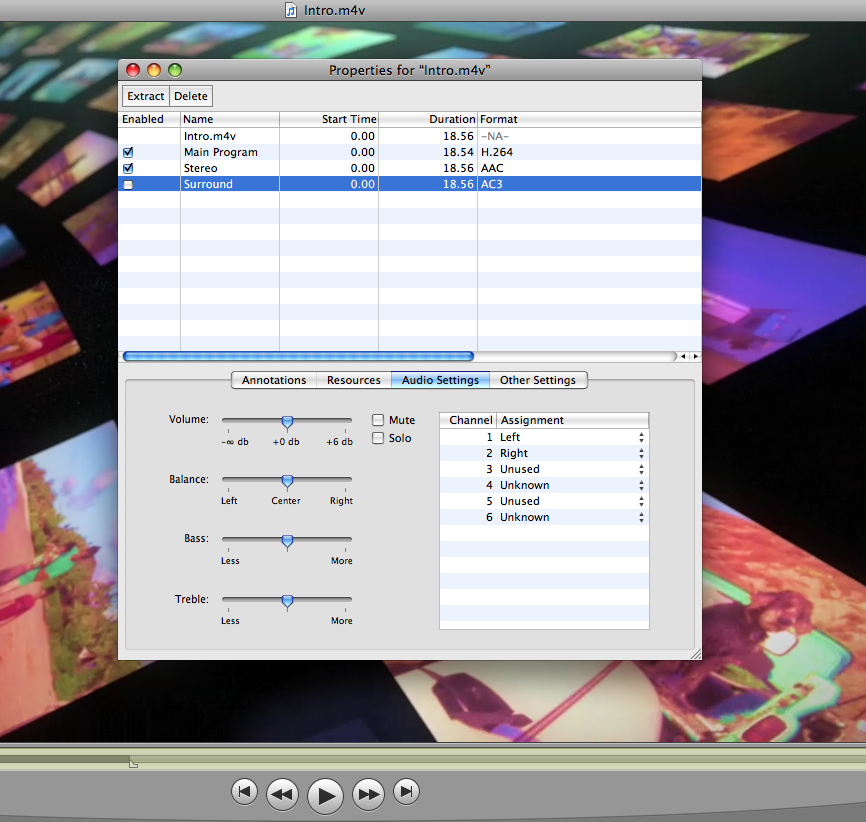

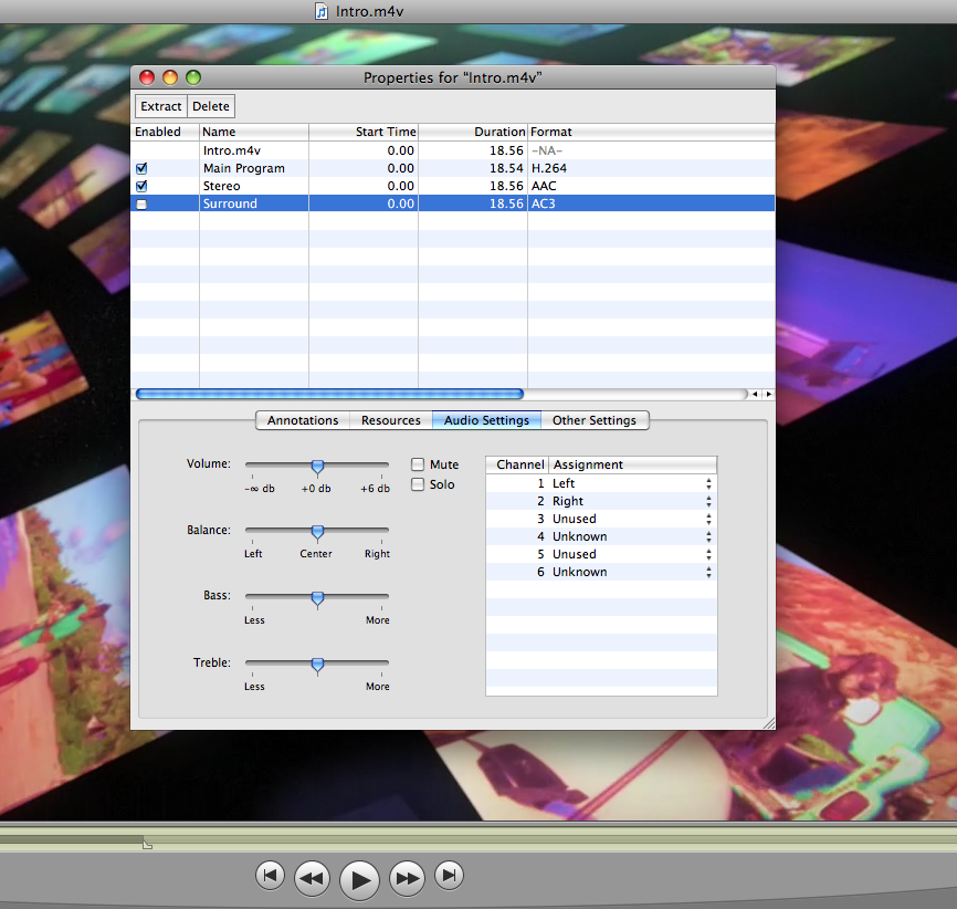

Take 2 Is Here!!!!
TAKE 2 IS HERE PEOPLE!!!! Woot! I will update as soon as I get home, and then I will try your idea Cave Man. I hope this makes Surround Sound easy.
AC3 is embedded
Here's the intro. Notice it has AC3.
Is that an HD download from the Apple TV that you hacked into to get out or - how was that one encoded Handbrake ? - Please share ! 🙂
That's straight from the ATV Take 2 upgrade disk image. I dl'd it from Apple and pulled it out of the finder. What's important, I think, is that it appears to be just a plain ol' AC3 file. That's very encouraging.
