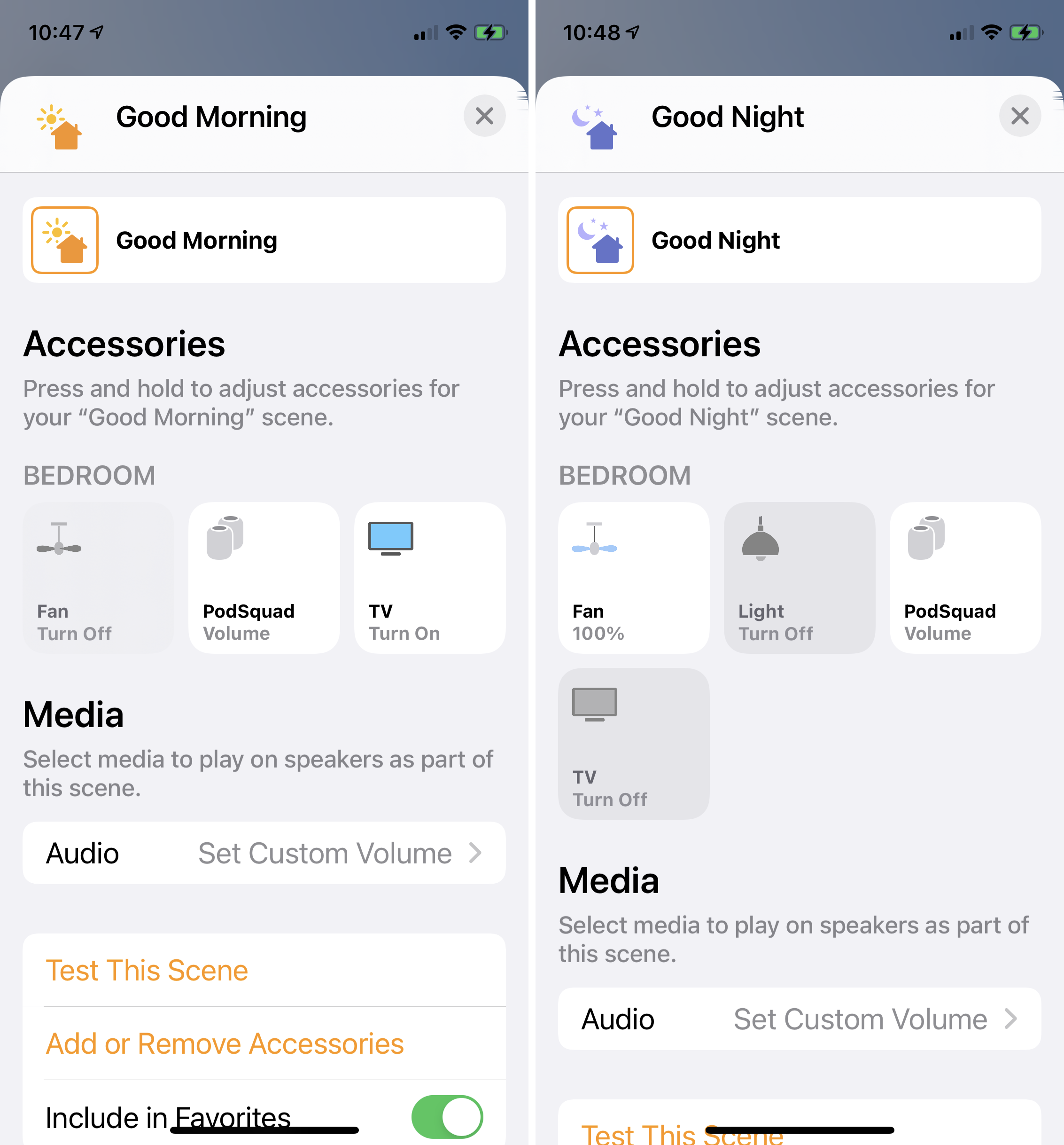

tv isn’t a HomeKit device in the traditional sense. You can’t use it in scenes. I don’t know why it’s like this. I used to be very frustrated by it too, but not anymore because my shortcuts are better. Normally I don’t have my HomeKit TV in the Good Morning scene. I only added it for demonstration purposes.

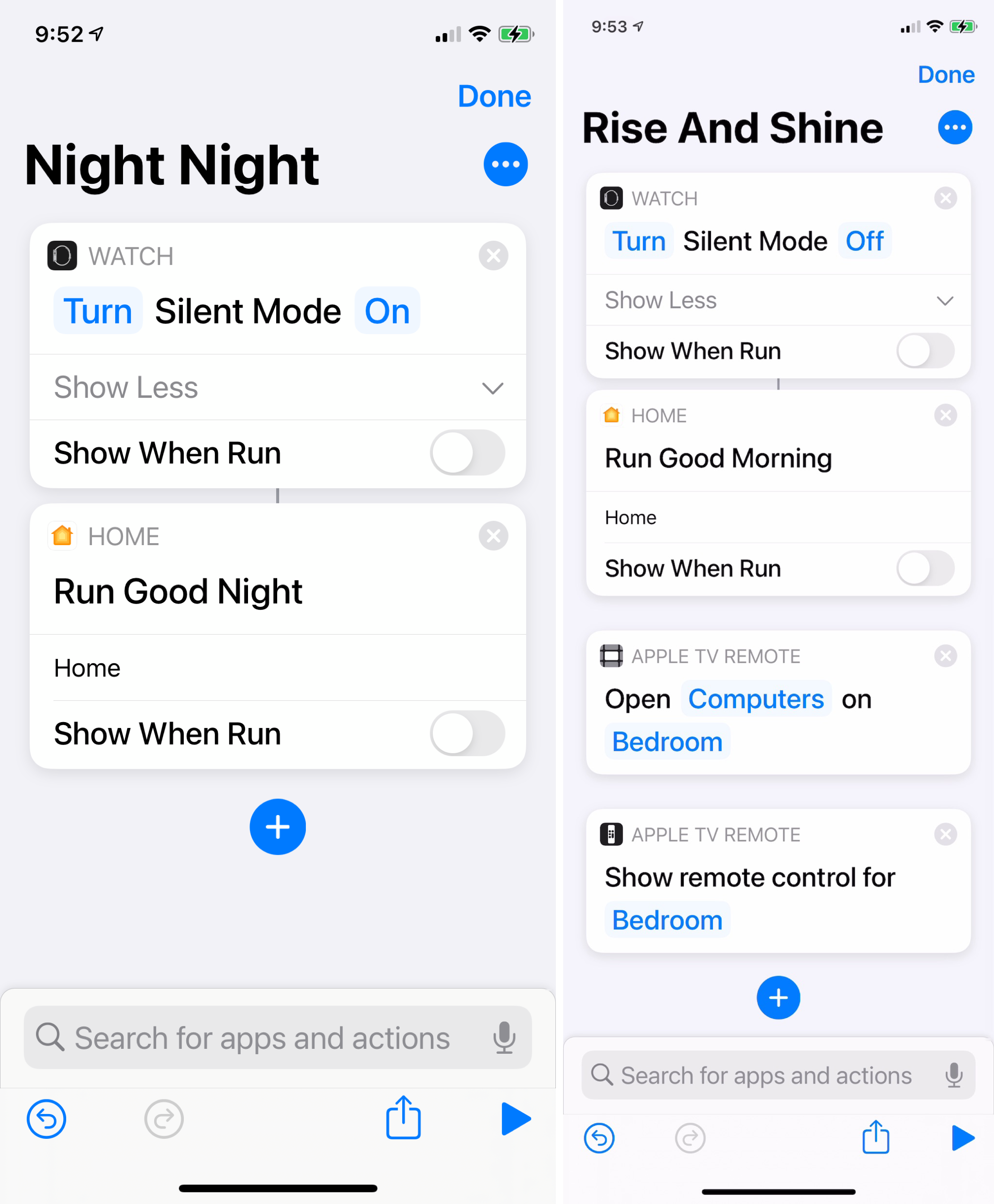

For some unknown reason turning my Vizio on doesn’t trigger the tv to come on. So that’s why I use the the shortcut to open Computers because it triggers the tv to come on and CEC triggers my Vizio to turn on. This is perfect for me because it’s the first app I use everyday. At night turning off the Vizio can remain in the Good Night scene because for another unknown reason turning off Vizio will trigger the CEC to turn off the tv.

I agree with you. Shortcuts is a good workaround for a single person home, or people that want all their own scenes. My house is not interested in figuring everything out. They just want it simple, and to "work" reliably.
