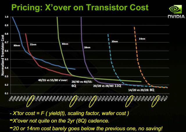

It's important to note that a new node is not automatically cheaper. The fab has to pay to develop these new technologies, and the equipment can cost million of dollars. I can guarantee you that the wafer, initially, is going to be more expensive. You may get more chips per wafer, but the wafer is going to be more. You buy the more expensive wafer because you get more parts that are smaller, draw less power, etc.
It gets bad after 28nm.
