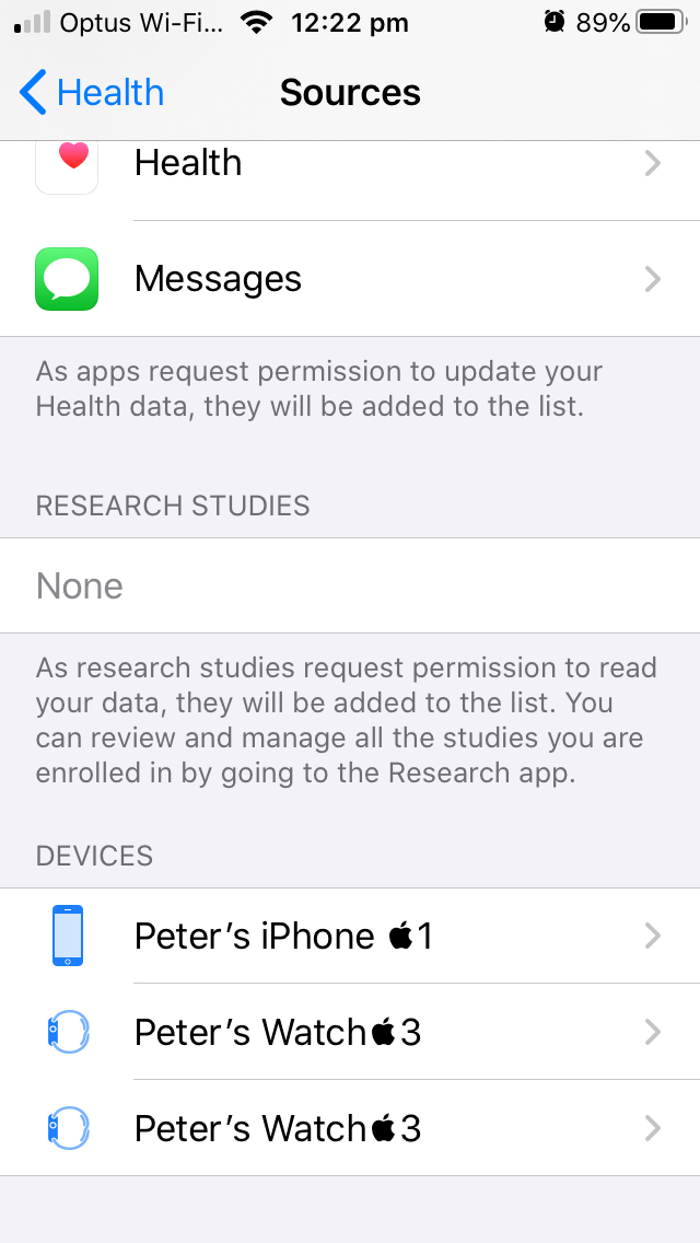

Have you checked whether your watch comes up as duplicate devices in Settings under Health app and then Devices. Mine comes up as two devices: 1 paired but has no data, 1 unpaired but has all of the active data. I think it’s either a hardware issue that they missed because only few people have this issue or a communication issue that is software related. When there are two devices showing that means the watch has issues communicating with the phone and it can drain the battery.View attachment 875711

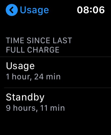

I have uploaded 4 screen shots 0231 and 0232 are after a repairing exercise. Watch was charged and put on wrist at 23:00 approximately - see usage and standby times and battery usage 20% this is excellent.

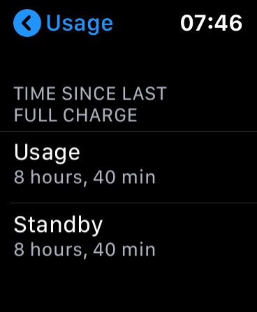

But 0225 and 0224 show the more usual story 60% battery drain in under 9 hours but note the usage is the same as the standby so something is running flat out on the watch but as I have already said everything is turned off except refresh on the apps that are on the watch face which can't be turned off. always on display was turned off all night to get to this state.
something is running constantly after the watch has been on for a couple of days.
