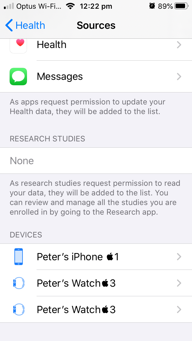

Series 5, SGSS, 44MM. Battery is absolute garbage. 81% after 3 hours, whereas on the Series 4 it'd last all day. I have re-set and re-paired multiple times which has usually fixed battery glitches in my experience.
Have you checked whether your watch comes up as duplicate devices in Settings under Health app and then Devices. Mine comes up as two devices: 1 paired but has no data, 1 unpaired but has all of the active data. I think it’s either a hardware issue that they missed because only few people have this issue or a communication issue that is software related. When there are two devices showing that means the watch has issues communicating with the phone and it can drain the battery.
