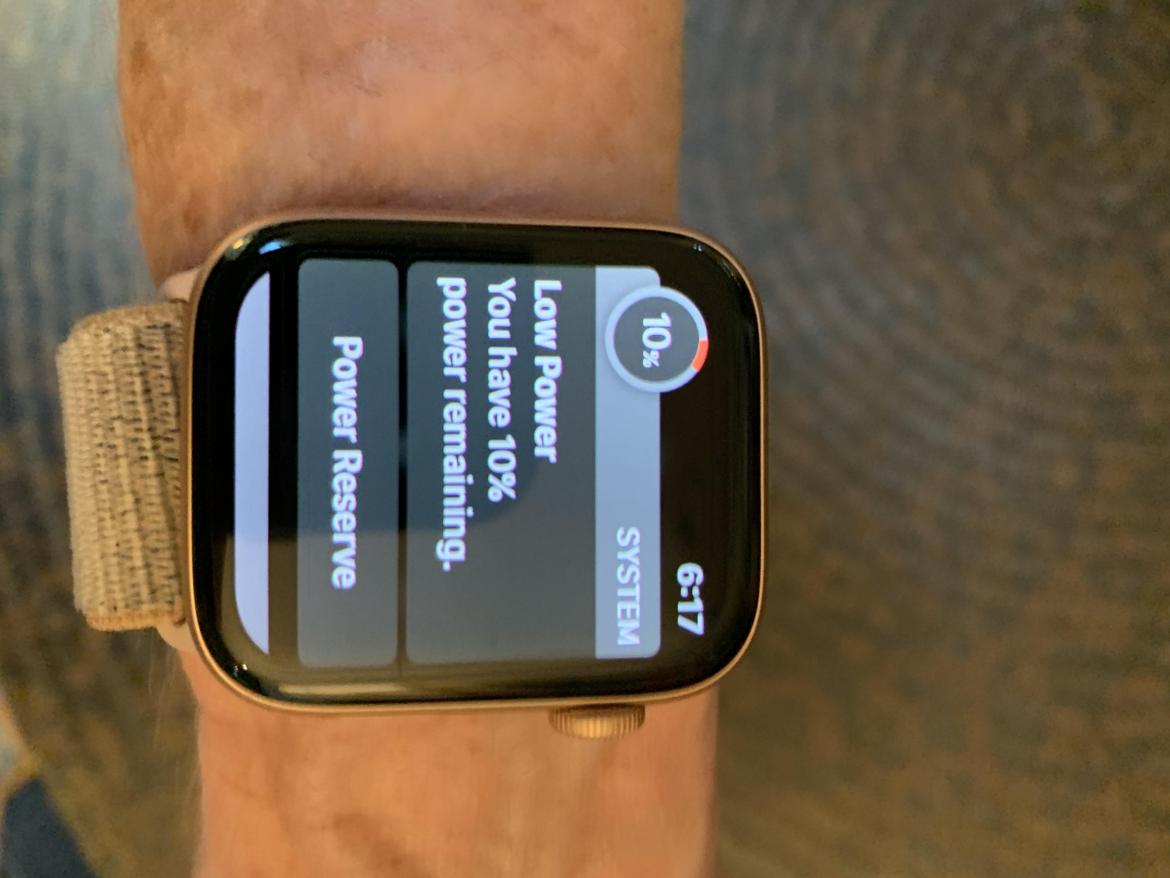

I just started getting this problem today with my cellular Series 4. The screen gets very bright at times, and then returns to normal. I have had this watch since the Series 4 was released, and rarely was under 75% battery at the end of the day. Today was the first time I got a reserve power message. Picture attached.
