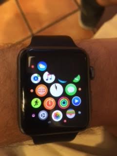

My Apple Watch Sport started having a screen problem 3 days ago. It started with a small black dot on the top centre and is progressively getting larger and larger. The top left the screen also stopped displaying anything.
The watch has a few dings and scratches (which I imagine are typical for 14 months of daily use) but to my knowledge hasn't suffered any hard impacts.
Has anyone experienced this?
The watch is 14 months old, bought in Germany, so the full 1 year warranty is over. I am left with the more limited 2nd year warranty and Apple's mercy.
It is a fairly common problem that likely effected a batch of :apple:Watch's. It is a manufacture defect in the screen assumably gluing process in the top right corner that allows water ingress. Since it is a known problem you may have some recourse.
You have had it for 14 months and is this the first time you have exposed it to water?
It looks like water damage, there have been several threads on here with very similar pictures. It seems that the glue in that upper corner tends to fail with a lot of exposure to water.
It doesn't even have to involve a lot of exposure to water. This manufacturing defect could have been there since the beginning and the OP simply subject it to a water source for the first time.
OP, many major credit cards offer extended warranty protection in the 2nd year, in which case you can file a claim with the CC company to get reimbursed the $199 out of warranty cost. However, I don't know if you have this in Germany.
Germans tend to not use credit cards from what I understand. But they have stronger warranty laws than we do.
Hope Apple does the right thing and fixes this!
"Doing the right thing" unfortunately tends to be more of a problem in countries with stronger customer protection/warranty laws. I've noticed that retailers tend to be more hard-nosed in countries with excessive customer protection laws, compared to the U.S.

Can not hurt to try. Even out of warranty a few months the watch should remain water tight under normal conditions.
Reactions: ladytonya
It looks like a fault and that shouldn't happen after such a short time; I'd be amazed if they don't replace it (though returning it in a different country, albeit within the EU, may make a difference).
The same exact thing happened to my Apple Watch stainless steel after 13 months of ownership. I never abused and in fact took very good care of it. After going back and forth with the Genius Bar, they agreed to put it through as a warranty repair to the screen no charge. This is absolutely a defect in the screen - don't let them tell you different.

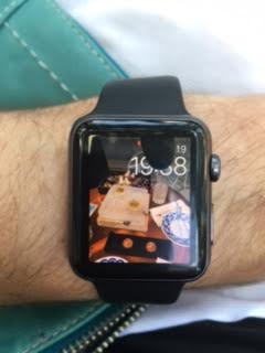

Hello
I had the same issue with my Apple Watch, and apple told me that was my fault. I didn´t have applecare and I could not apply the extension warranty for my credit card.
Best regards
Hello
Best regards
Actually that is a known manufacture defect. Get it escalated to a higher level. It may still be covered but you should have exposed it to water LONG before now since it was an early production problem effecting a run of watches were the glue was not applied (properly or missed) to the top right crystal.
Reactions: Newtons Apple
Hello
Thanks so much, in fact it's supposed that the case was escalated to Apple's engineers, but the answered was the same. I used to clean my watch once a month, suddenly it appears that screen damage. I went to an Applestore in Mexico City and they believed that I had hitted the screen.
