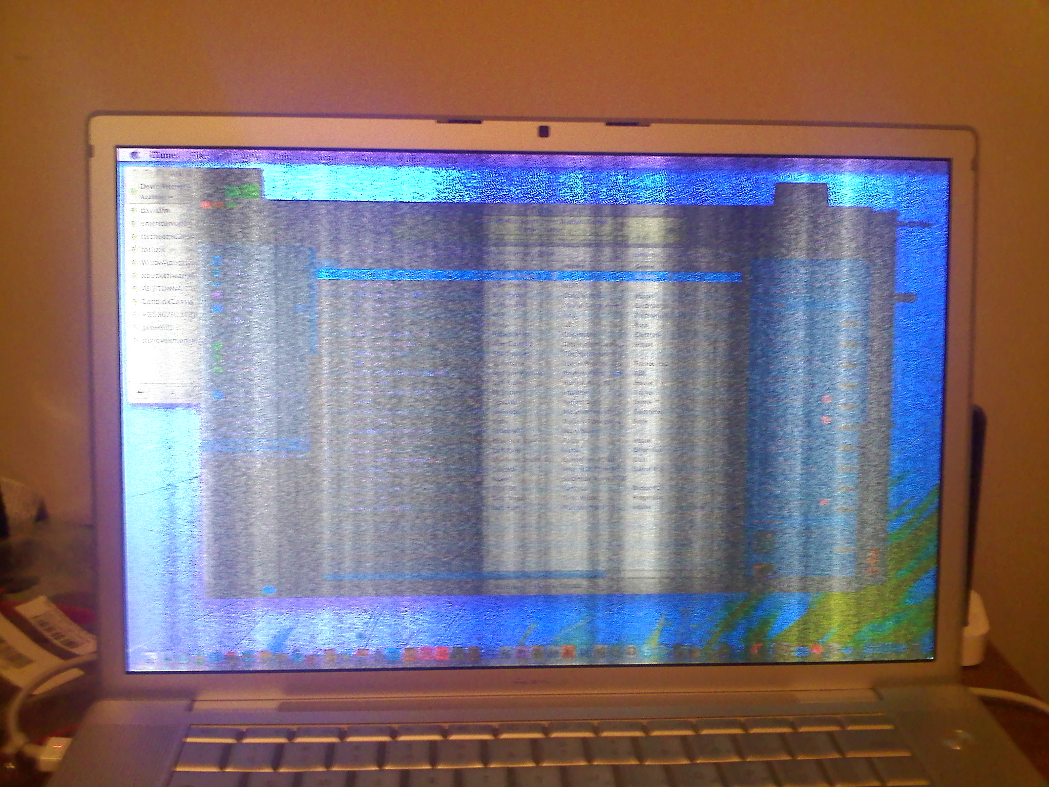

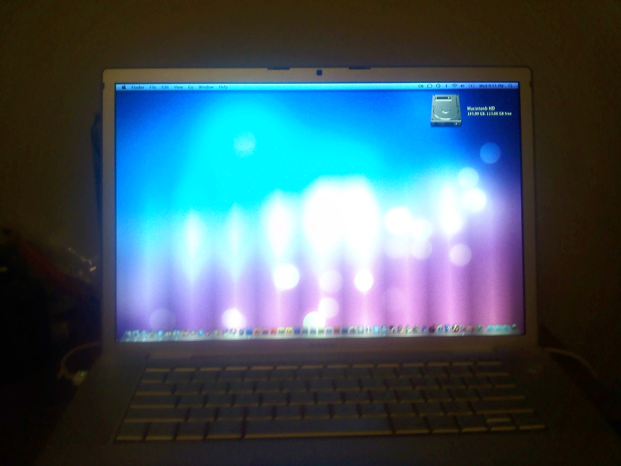

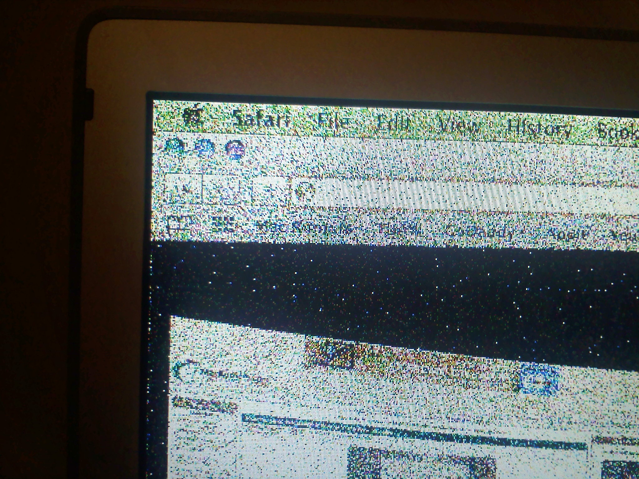

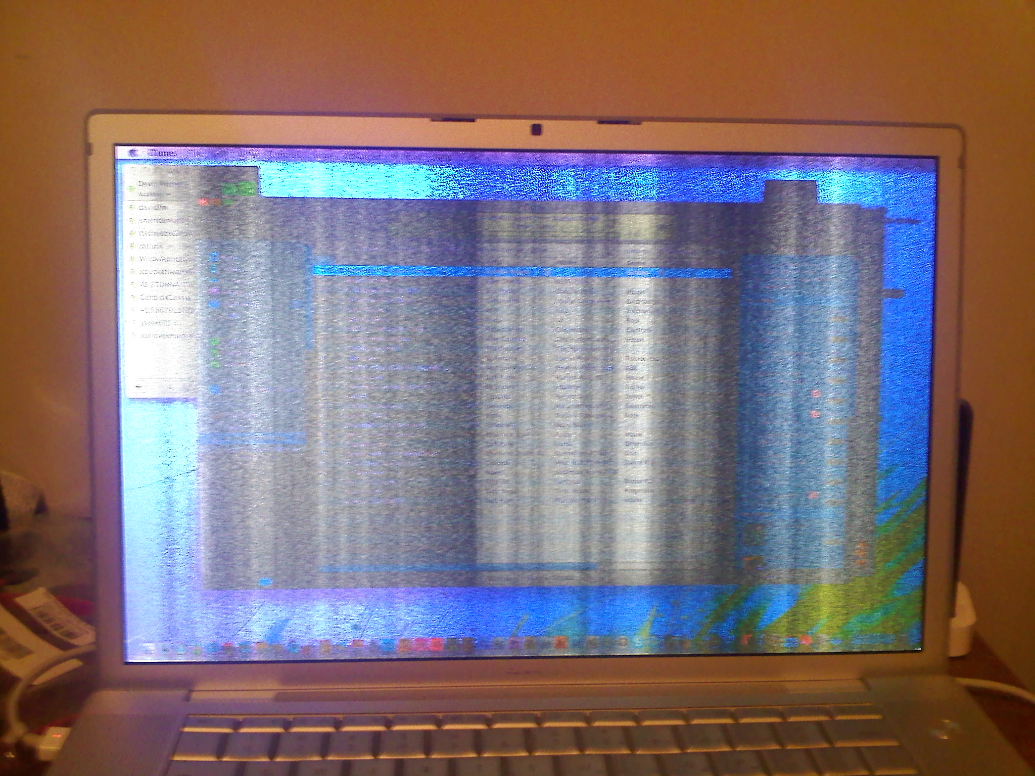

What exactly are your problems and could you take pictures? Because you are out of your warranty period, Apple is being very careful in not doing support for something ineligible. You might need to talk to CSR and try to get a CS repair done.
Some Pictures.

If you have those pictures as proof, call 1-800-APL-CARE and tell them that you are unable to go to a store. Then tell them you have these photos and go from there. Just don't mention the store visits unless they ask.

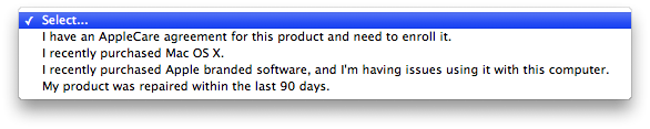

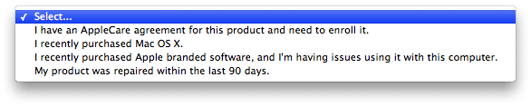

Or I get this for a reason i should get it for free (Image attached)

As for the repair, see here: http://support.apple.com/kb/TS2377
from supplied link: ... In July 2008, NVIDIA publicly acknowledged a higher than normal failure rate for some of their graphics processors due to a packaging defect. At that same time, NVIDIA assured Apple that Mac computers with these graphics processors were not affected. However, after an Apple-led investigation, Apple has determined that some MacBook Pro computers with the NVIDIA GeForce 8600M GT graphics processor may be affected. If the NVIDIA graphics processor in your MacBook Pro has failed, or fails within two years of the original date of purchase, a repair will be done free of charge, even if your MacBook Pro is out of warranty. ...
Then very clearly tell the Applecare agent you are having a specific issue with your 8600m and you will not be charged for the phone call. They may still collect your credit card info, but they should not charge you for any service, especially since you have photo evidence.

Call up AppleCare, once they notify you that you are not eligible for phone or hardware support tell them that it's related to the 8600M GT and give the agent the kbase article number. Once they glimpse over it, they'll either set up the repair for you, or they will put you on hold and transfer you to Tier 2 or a product specialist. If that doesn't work, then there's no reason to continue arguing with the support agent or the Apple Store, asked to be transferred to CSR (customer relations) and explain the situation, there you will be taken care of 100% whether it be under the extended warranty or CS repair/exception.
