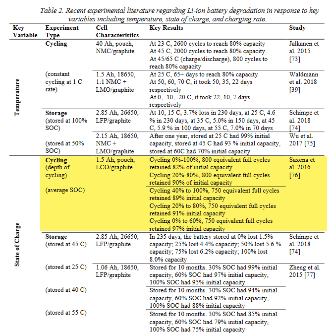

Lot of hand-waving arguments saying 0% is damaging.
Science says otherwise. HIGH state of charge is most damaging, followed by DEPTH of discharge. Hitting 0% is not ideal, but far better than charging to 100%.
