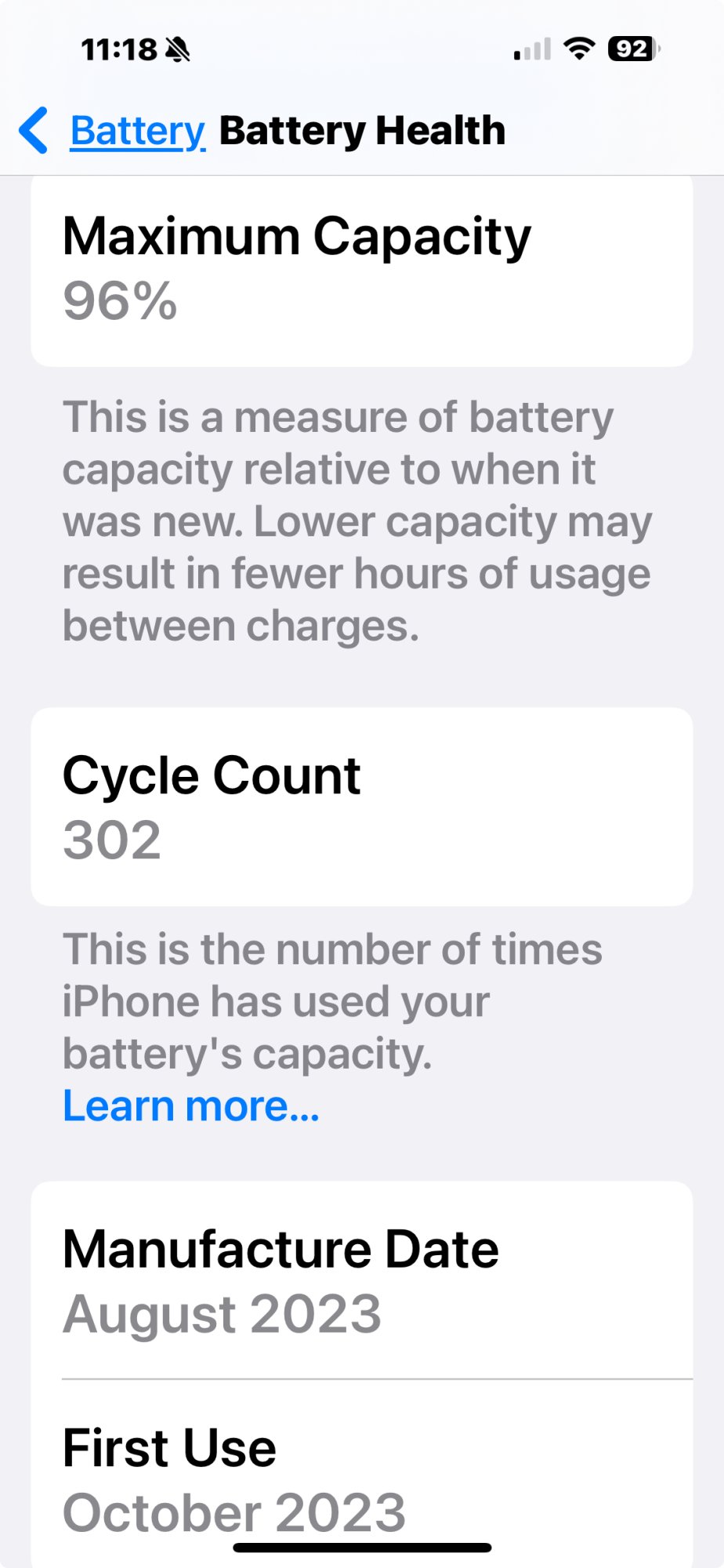

15 Pro Max Purchased October 2023. Mostly charged with MagSafe. I think charging speed has more of an impact than limiting the battery charge.

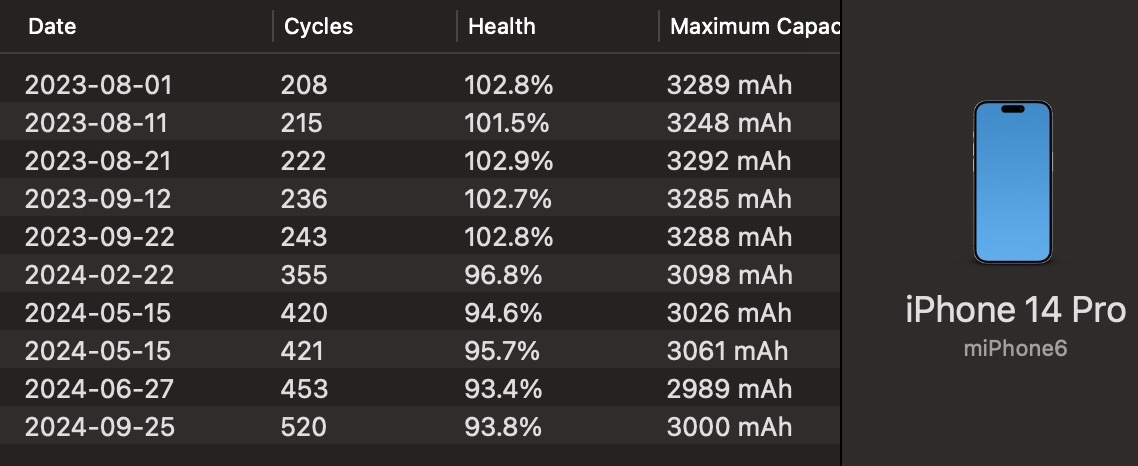

I'm at 94% and 520 cycles, using CoconutBattery. On my 14Pro. Up to a year ago, I was still at 103% of original design capacity.

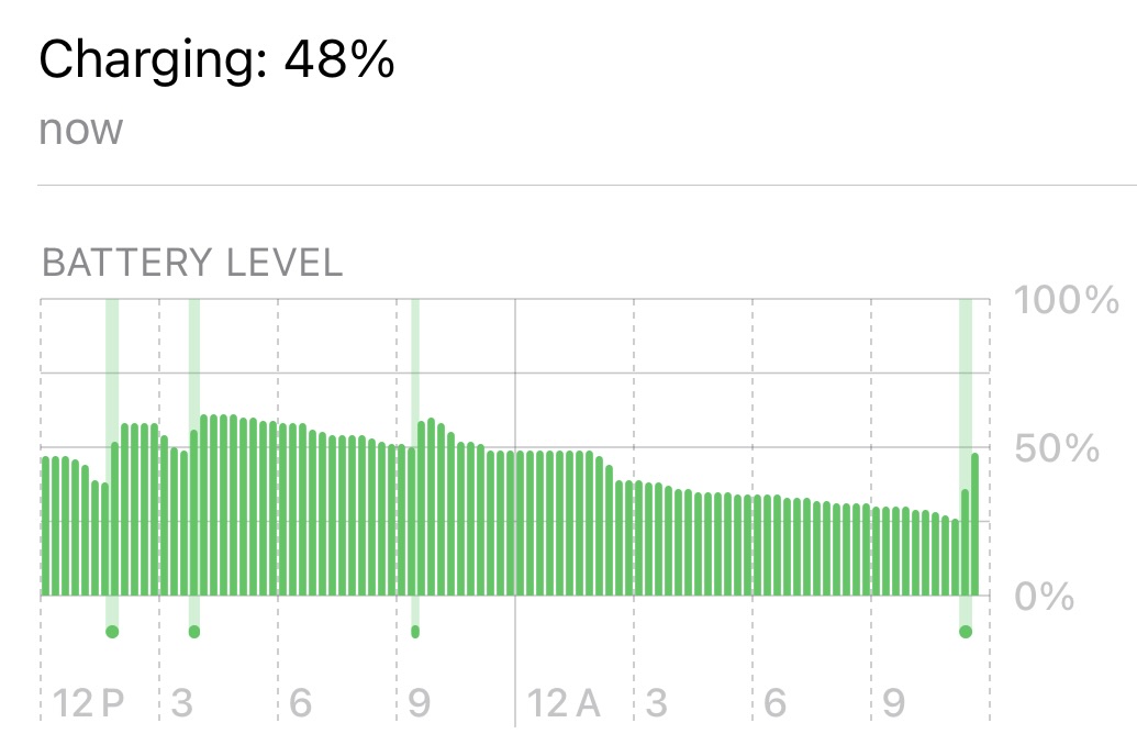

What was my charging strategy? I followed the N=1 experiment I do with charging my Tesla. I charge up to ~60%, as that level is below the 3.92V level where cathodes crack. Look it up. My 6yr old Tesla is still at 100% SOC, so I thought I'd try it with my iPhone.
Since I had to do this manually, it wasn't always possible to stop at 60%, but I was pretty good at it.
And no I'm not religious about it, I would charge as high as necessary if road-tripping my Tesla, and I would accidentally charge my iPhone much higher if I forgot.
This is today's charging, as you can see, I've charged it up to 60% three, now four times in last 24hrs. Whenever I think about it, and am near a charger I'll connect it. Lots of shallow charges.

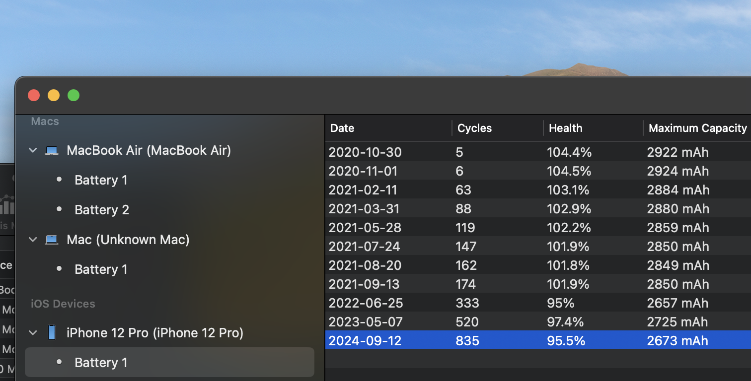

I recommend people to check the health on coconut battery for expectations. I got a "factory freak" for my launch day 12 Pro. Didn't have to worry about it. One time I started at 100% or just below, that battery was a turd. Hate to say battery lottery, thus why you have big variances in the comparisons and why some folks have their stay at 100% for over a year.
Now I do charge on 5W wired overnight as there is no need of speed. I got 16 Pro now that has like ~24% more capacity than the 12 Pro so get through the day no problem on my usage.
