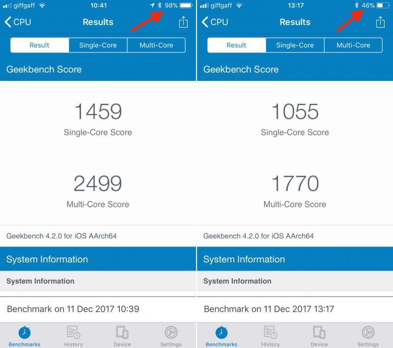

According to TeckFire, the author of the original Reddit post, their iPhone had been very slow after updating to iOS 11, especially compared to their brother's iPhone 6 Plus, so they decided to do some research with GeekBench and battery life apps, and ended up replacing the battery.
MacRumors' Geekbench scores for iPhone 6s before and after battery drain
Wear level was somewhere around 20% on my old battery. I did a Geekbench score, and found I was getting 1466 Single and 2512 Multi. This did not change wether I had low power mode on or off. After changing my battery, I did another test to check if it was just a placebo. Nope. 2526 Single and 4456 Multi. From what I can tell, Apple slows down phones when their battery gets too low, so you can still have a full days charge.

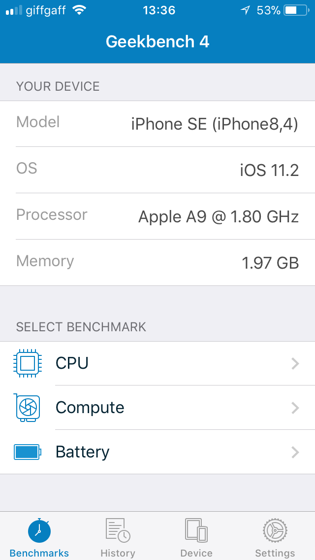

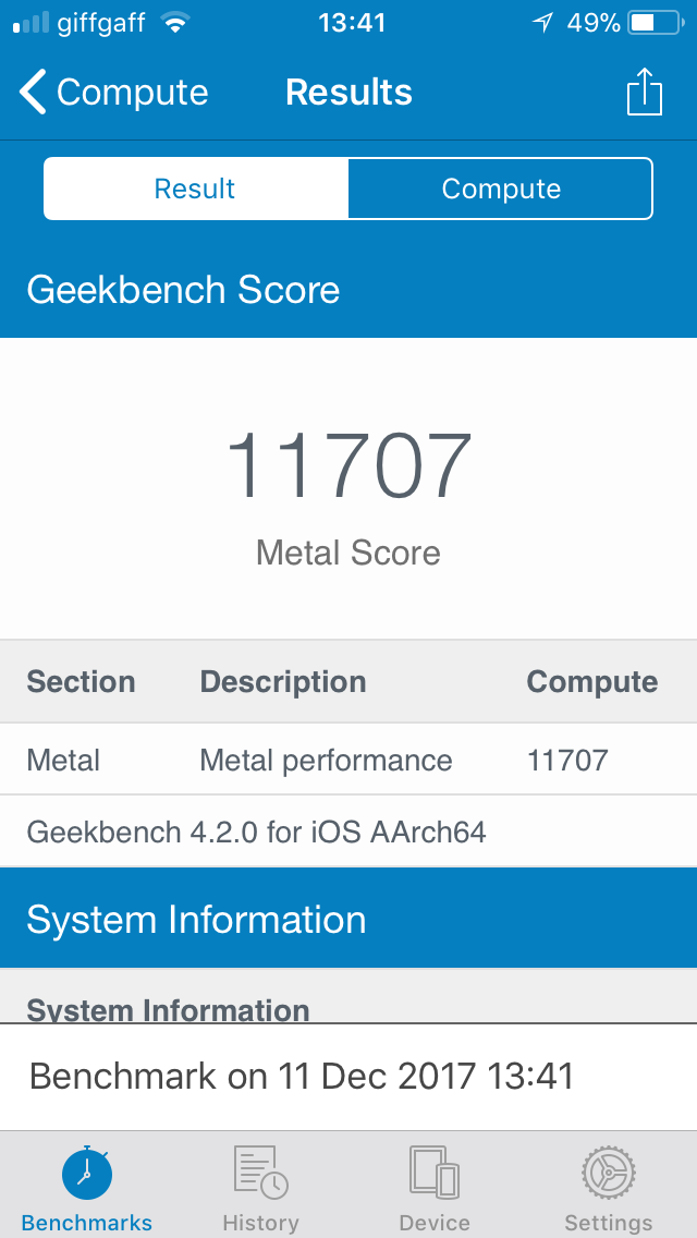

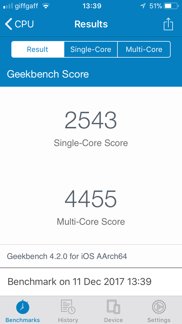

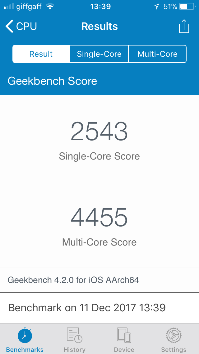

I already posted my findings with screen shots in the other thread, but here’s my experience:
I have two iPhone 6's one on ios 11 and one on iOS 9. Both are 2 1/2+ years old.
I’ve been having speed issues with the iOS11 iPhone. Once I read this article, I checked my Geekbench scores and found I got 1050 versus the 1400 or 1500 I should’ve been getting.
The iOS9 phone clocked in just fine.
I replaced the iOS11 battery and am cruising alone much better.
What’s behind this all, I have no idea, but the symptoms and cure seem to bearing out as positioned in the article.
Oddly, my new-battery iPhone 6 performs better now in low power mode than it did in regular mode with the old battery. Something is not correctly optimized with these older phones.
