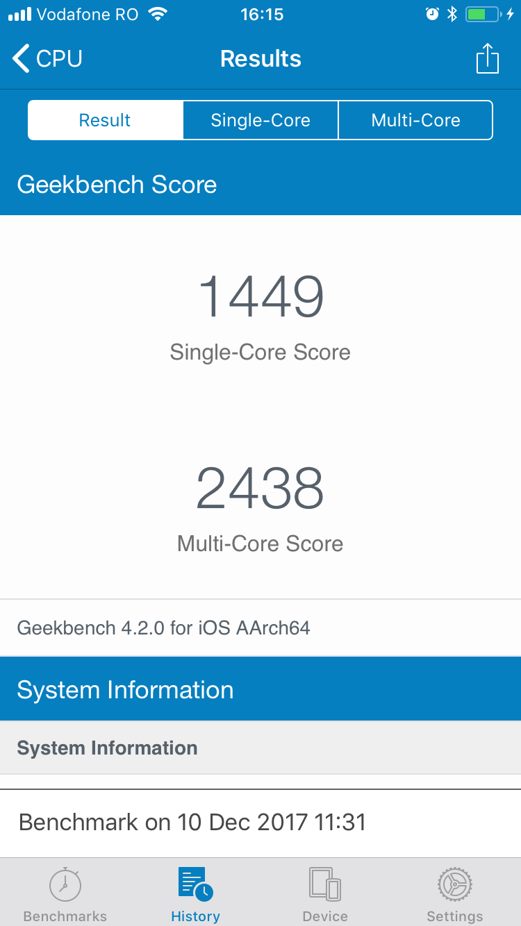

This is my 6S. Ran Geekbench on another 6S and it got almost the same score. Both phones feel sluggish since iOS 11.
