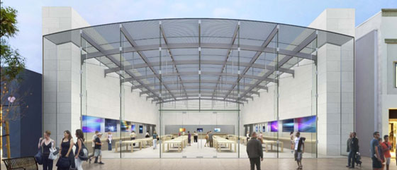

How is this gonna work out during an earthquake?
Where does the rain go?
I'll point out the obvious solution. The glass very clearly goes into the wall. If they leave a small gap above the glass, water will also flow into the wall and into the hidden gutter/drainage system. Pretty simple.

For those of you worried about glass and earthquakes, have you never heard of laminated glass? It's been around for over a hundred years and is used in glass for buildings and car windshields. It also blocks UV transmission.
Guys, there is nothing really technologically earth-shattering about this building.
Rain water? They are called roof-drains. Done all of the time... There will be a gutter system on either side at the low point of the curved roof. It is not a good design (gutters like this can leak to the building interior), but it is done all the time
Too Hot? Well, it will be an issue - but the new ultra clear glass coming from the two major maufacturers (PPG and Pilkington) is pretty high tech. All of them block UV radiation so stop with the stupic sunscreen jokes. Heck, plain old clear glass blocks almost all UV radiation . No matter how you slice it, this building WILL have a higher heat load/cooling loss with glass that transmits 75% of visible light (I happen to have a PPG glass sample on my desk right now). The bigger issue is that most of the panels are single pane glass (not insulated)...
Sesmic is a bit of an issue - but it will have to meet the code, so it will be doable
The roof getting dirty is a bit of an issue. It does not rain for months at a time in that area. They will be cleaning it often, just to remove the dust and bird droppings. Some building like this actually have a claning system built in - so not one have to go up on the roof for the regular cleanings.

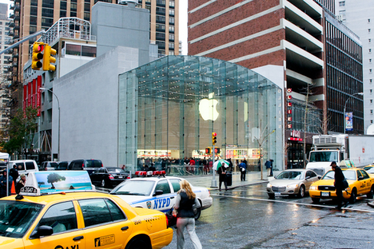

This thread exhibits the worst characteristics of the internet. People who think they're experts on every topic under the sun, who refuse to listen to folks who actually do have some expertise, who make wild accusation without offering a shred of proof or see conspiracy theories behind every innocuous action, who are suspicious, paranoid and just plain annoying.
This Santa Monica store already exists: it's called the Upper West Side Apple Store in NYC. All the ludicrous criticisms of the design in this thread have already been addressed and answered in a store that's been open for almost two years.
During that time period, no one has burst into flames from the intense sunlight in the UWS store. Rain doesn't collect on the glass roof but goes into drainage. It is not a greenhouse hot inside but cool and comfortable during the summer, warm and toasty during the winter. The glass is regularly cleaned by maintenance.
Only in a geek fan site would people carp about a store design that employs an abundance of natural light. Talk about playing up to stereotypes.
