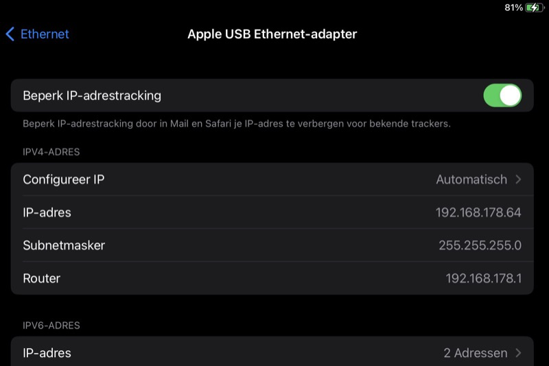

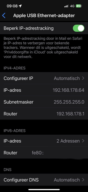

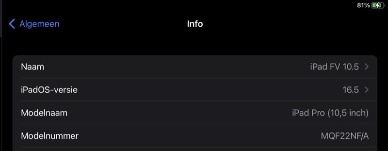

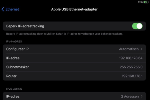

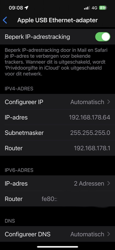

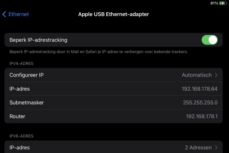

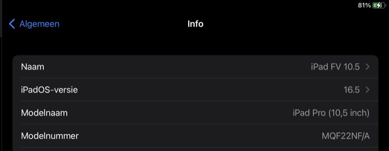

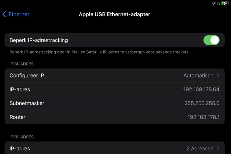

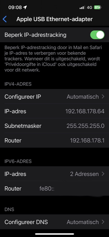

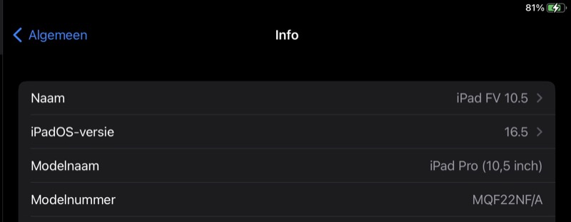

The Apple USB-A Ethernet adapter works here, with the official Apple 20W USB-C charger (A2347) and an official Apple USB-C to Lightning cable. I tried both my iPhone 13 and iPad 10.5. I can also attach a Samsung T5 SSD and several USB-sticks, so the devices are powered.
iPad:
iPhone:
