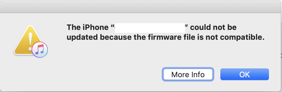

New issue arose today with 12.6.5 😓
iOS 13.1 cannot be installed by this version of iTunes. It will download but won't put on the phone and throws the error message shown here. 😭View attachment 863324
It feels like Apple is doing every little thing behind the scene to piss off its hardcore users. 🤬
Apple has been doing so for a very long time. No surprise here. The solution is to carry a clean install of Catalina for this purpose. I did it a few days ago because iTunes 12.6.5 no longer supports newer iOS install.
The issue is, without iTunes 12.6.5, I cannot load multiple devices with the apps by downloading only once.

Nobody in Apple cares about people who has a data cap or limited bandwidth. From this point, you need to get Catalina on a USB drive (so your current OS remains unaffected) and do a full backup of your current OS. Internet recovery or local recovery won’t download anything older than Mojave anymore. By doing that, you can keep using iTunes 12.6.5 for as long as possible until Apple decides to completely disable this version of iTunes.
Someone suggests iMazing, and it is being sold at a dirt cheap $6. You may give it a shot. Check the post in previous Page.
Unfortunately, never figured out how to use Configurator. In addition, already bit the bullet and tossed the towel on the SE. (Still has a X and an 8 that can be used as test bed once the apps are iOS 13 compatible)

I couldn't update an iPhone from 13.1 to 13.1.1 using iTunes 12.6.5, but it worked with Apple Configurator.
After that, the iPhone with iOS 13.1.1 was visible in iTunes.
