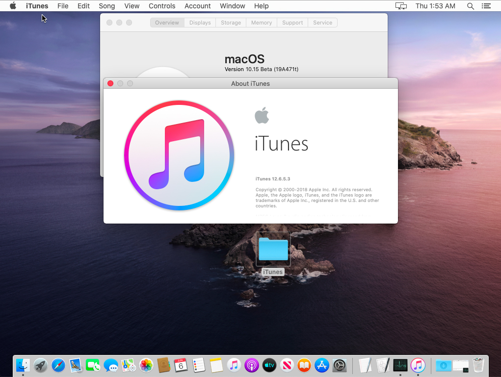

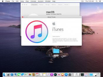

I've just got iTunes 12.6.5.3 working on the first MacOS 10.15 Beta
I'll start a new thread with instructions soon.
I'm trying to clarify the instructions to be 100% sure of the process before I start. So, I still don't know if I need that file.
The first script doesn't add or remove anything from the iTunes installation package. It just removes the limits on the system it can be installed. The second script does the same, it replaces 12.6.5 with 12.9.4 in Contents/Info.plist from the selected iTunes.app.
Instructions for getting iTunes 12.6.5.3 to work on MacOS Catalina 10.15 https://forums.macrumors.com/threads/itunes-12-6-5-3-on-macos-catalina-10-15.2184518/

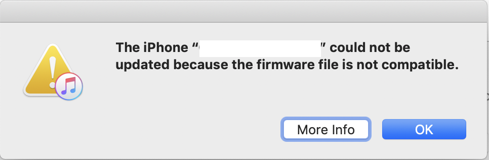

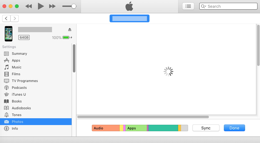

Also, is anyone able to use iTunes 12.6.5 on Mojave 10.14.4 (or 10.14.5 or 10.14.6) to fully sync their iPhone or iPad, including their photos?
Regular Sync of all content (from apps to music to photos) used to work up until Mojave 10.14.3, but ...syncing photos doesn't seem to work anymore for me. Here's what shows up in iTunes 12.6.5.3 (properly patched as from instructions at #194) when trying to choose what photos to sync with the iPhone:
If you follow the instructions exactly, then yes, iTunes 12.6.5 still works on 10.14.6
Thanks.
Also, this!
Seems like sync is messed with many people. I think I should hold updating to Mojave for now.
On a side note, sometimes I update apps through iTunes/iMazing. I can no longer update those apps from the App Store on the iDevice itself. I have to update them manually every time there is an update. Yesterday, when I had to change my iPhone, after restore, those apps didn't even download from the App Store. I had to install them by connecting to the computer.
Anyone else facing similar issues? And any solution for this would be much appreciated.

I picked right up where I left off. In fact, I migrated to a new computer, then installed iTunes 12.6.5.3 on Mojave 10.14.6 and I was immediately to sync with my iPhone on the new computer. I haven't tried a restore because I have no need to do so.
Reactions: Red John
Thanks. That helps.

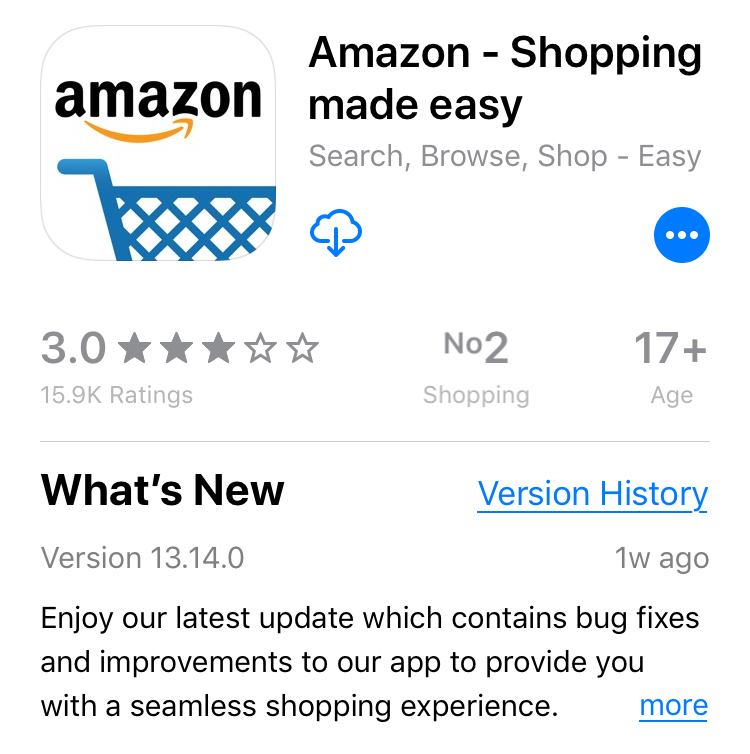

I think I'm facing the same situation using High Sierra. I can download apps to iTunes, but it doesn't sync them to my iPhone. I have to download from iPhone directly.
Same happened to me. Any solution?
