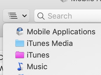

One thing about Configurator is that it cannot arrange the apps on the phone. Why does Apple have to be such a PITA about this. 😓
Just about this?! I have a long list...
One other trick I just used is to drop the apps updated for iPad or the old iPhone on the new iPhone-in Configurator , so I do not have to download it twice, as Apple would like me to do 😠
We can drag it from the iTunes to Configurator??
or from the just newly downloaded apps in the Configurator folder, from one device to the other .
Yes, from the folder View attachment 1490962
And after looking all over the place in Configurator for over 10 minutes, finally realize that screen capture is from iTunes. 🤣

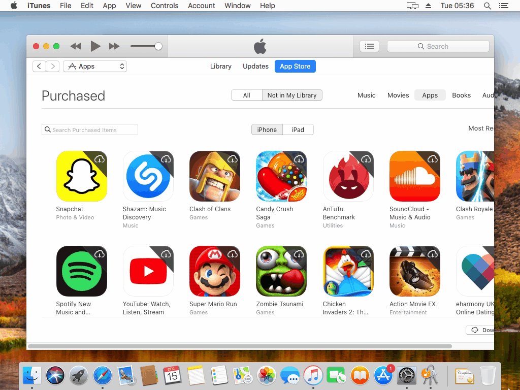

Apple is deliberately blocking purchase requests coming from macOS on older versions of iTunes.
I confirmed this by spoofing the User-Agent of iTunes 12.6.5 on macOS to that of the same version running on Windows 7. Result: Music, apps, etc. can be downloaded once again.
When iTunes wants to download content from Apple's servers it makes a request to
"https://p14-buy.itunes.apple.com/WebObjects/MZBuy.woa/wa/buyProduct"
If authorized, the server will reply with a list of files for iTunes to download (named "songList").
However, for macOS, the server says the download is authorized but providing an empty "songList".
This results in the download finishing immediately, as there is nothing to download. However, no error is displayed as it technically succeeded (in downloading nothing).
Empty "songList" on macOS (left), regular "songList" on Windows (right)
Here's what happens if we spoof our User-Agent to
"iTunes/12.6.5 (Windows; Microsoft Windows 7 x64 Ultimate Edition Service Pack 1 (Build 7601); x64) AppleWebKit/7605.1033.1002.2":
If you wanna try this yourself, get Charles Proxy and enable SSL decryption.
You need to add the SSL certificate to the System keychain and set it as Trusted.
iTunes does SSL pinning on certain domains, so you'll need to disable decryption on those.
Proxy -> SSL Proxying Settings
Make sure it looks like this:
Now save this as an XML file: https://pastebin.com/GgkMPfGr
Then go to Tools -> Rewrite and click on Import.
That's it.

If you only use it for this purpose I'd turn off its recoding feature, click on the red button.
Thanks for further explaining it: I've done exactly all the steps you suggested
Certificate is in the system Keychain and trusted till 2050...
I restarted the computer but updating is still not working
I have Mojave 10.14.6 and iTunes 12.6.5 , exactly the same About in iTunes shown in your clip.
If I get info in finder about iTunes somehow has become 13.6.5, just discovered now!
I've found that the "p14-buy" server sometimes changes, so it might be your case here.
With recording mode on, check to see which server your iTunes is using.
If it's different, go to "Tools" -> "Rewrite" -> "Fix iTunes" and add a location as such:
