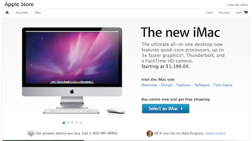

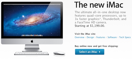

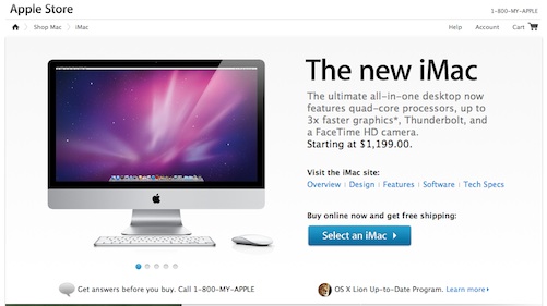

This seems to have been a cock-up too
As it's back with the SL desktop again now.
http://store.apple.com/us/browse/home/shop_mac/family/imac
It definitely seems to me that they meant to release Lion this past week, but they must have run into something. If there was never any intent to do so, why would anyone (or any automated system) put the Lion image on everything? I have a feeling it'll be next week.
...Or, of course, the folks at Apple know about all this crazy speculation and are just totally screwing with our minds and have no real idea of the exact release date yet.
EDIT: And... hold on... oh, I was about to say I was surprised they haven't removed these images yet, but it seems they have. Am I the first to notice this, or am I really late?
