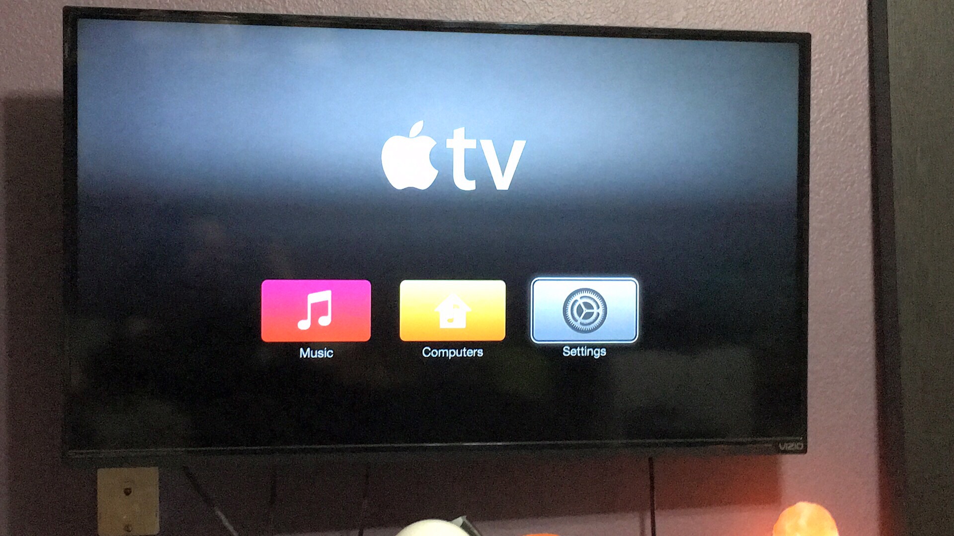

THIS LITERALLY JUST HAPPENED TO ME.
It kicked me off of Netflix randomly and now everything is missing except for Music, Computers, and Settings. I've restarted it several times, restarted my router, and I even restored my Apple TV. Still nothing. Is this just some sort of glitch with apple? Or am I missing something here?
[doublepost=1478084547][/doublepost]Go into settings, iTunes Store, Location, and change your location to Namibia. Back out of settings, go back in and change it back to US. It will restore all the apps.
Just happened to me yesterday as well! HAS to be some kinda bug!
Worked partially. Some of my apps like ESPN are still missing. I literally have half the menu I normally do. #ATV3
This happened to us yesterday, I tried the change of location thing but only a few (lame) apps came back up and Netflix. Hulu and hbo go won't show up. When I did a reset all the apps disappeared again and it went back to the screen with computer and settings as the only option. Is this because of an update?
