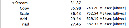

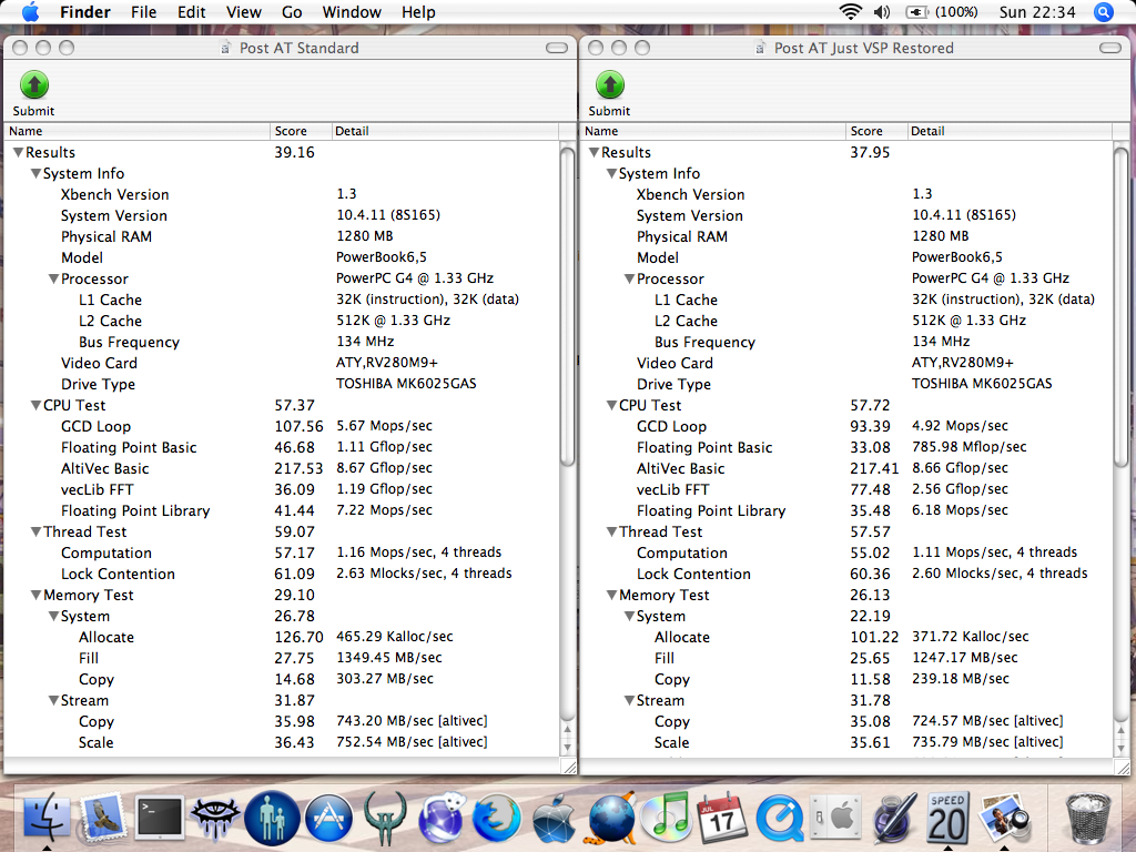

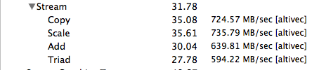

I'm not sure how helpful these results will be to you, really, I ran the script as-is and ran Xbench, and then I I restored just VSP frameworks, and then ran Xbench once again. As you can see, the results aren't probably what you were to expect, but I have included some cropped screens of the "altivec" labelled parts of the benchmark results - not sure if this is any more or less helpful, but I thought I'd include to. Also, happy to send you the Xbench files as well.
In terms of non-scientific "it feels like X" commentary, I didn't notice much of a difference, either way, to be honest. I would say, however, that running the Accelerator script was one of the biggest boosts to my iBook's performance. And I also have SPotlight fully disabled, Dashboard disabled, and I have used Monolingual to remove all kinds of unneccessary bunf, too. So, I'm not too sure how much the trimming actually did for a late G4 system like mine.

Hmm... Would you mind running the Undo script, and then get a benchmark of the system after the trimming has been undone? I'm terribly sorry, but I forgot to tell you to get a baseline of the system first, before any changes have been made. This would paint a little clearer of a picture of the situation in its entirety, especially when compared with the results here.
In any case, I feel like I will simply need to cut back a lot of what the script originally set out to do for the sake of AltiVec performance and system stability. However, the heavy hitters will be kept, as long as they aren't the ones at fault.
