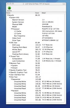

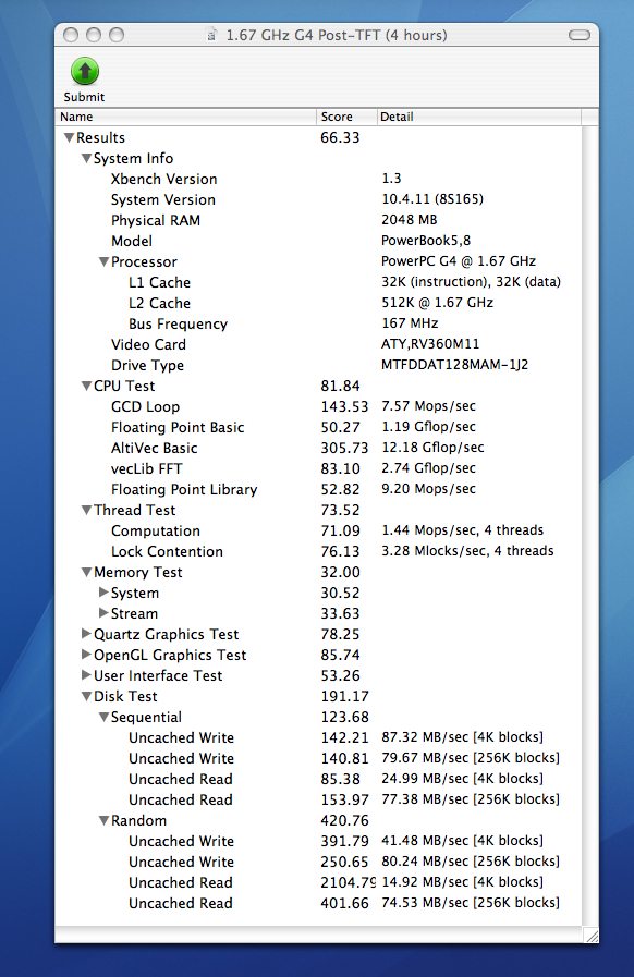

So, I gave TenFourTrim a shot on my 12" PowerBook G4. Ultimately, I decided it wasn't for me, for two reasons:
  1. A purely aesthetic consideration: Although I used the version that retains Dashboard, it apparently had removed the font that Dashboard used (whichever font that was, I don't know). I didn't like my widgets' appearance with the new font, which at first glance looks like some variety of Times.
  2. A functional consideration: Initial benchmarking showed ~25% drop in AltiVec performance.
Here are the Xbench scores taken about 15 minutes after completion of TenFourTrim:
As you can see, the overall effect of TFT was positive, though negligible, after so short a period of time. I did take into account @z970mp's suggestion that using your Mac for some hours/days will build system caches to further improve performance; however, I don't see how that could improve AltiVec performance.

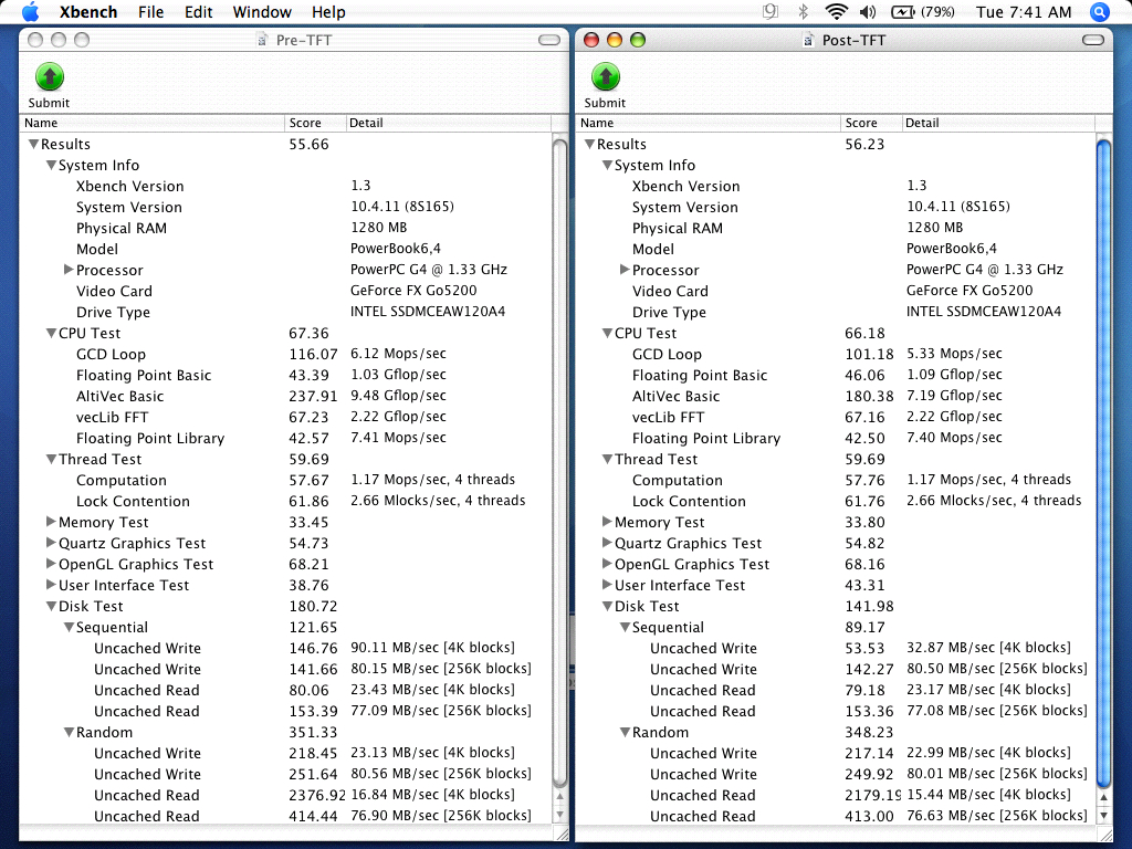

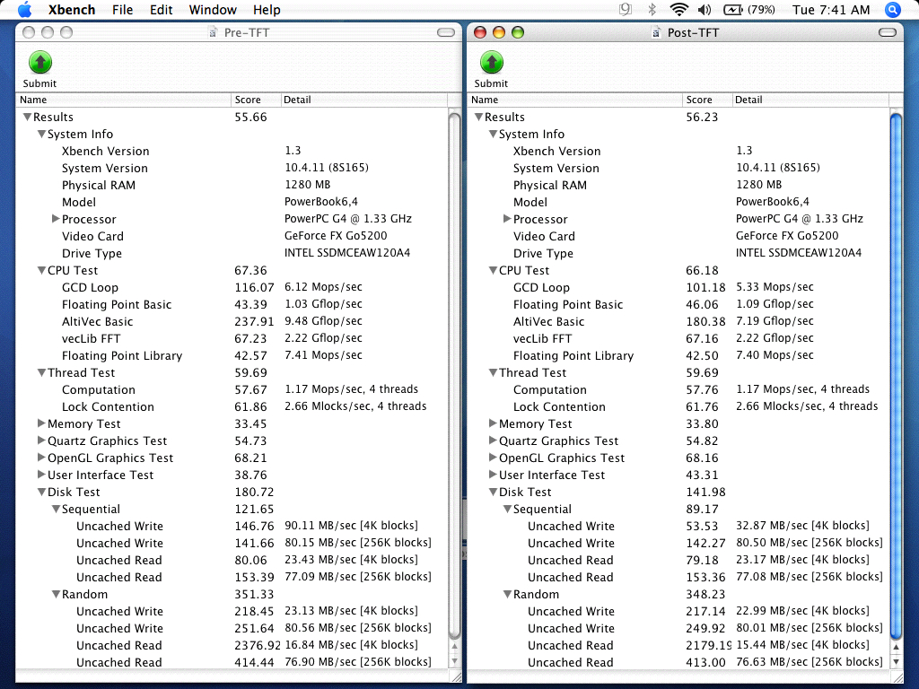

I should note I also tested TFT on my 1.0 GHz TiBook, and overall changes were very similar to what you see above. However, the drop in AltiVec performance on the TiBook was less pronounced: ~10%. I can only attribute this to the different CPU's: the TiBook's 7455 vs. the AlBook's 7447A. Again, this is all very preliminary, after only one round of benchmarking. It's all I plan to do though, so there's the info for anyone who wants to pick up that ball and run with it.
I can see how TFT could benefit a G3 system. G3's don't have AltiVec, so would suffer nothing by applying TFT, and performance gains in the UI would be noticeable and would accumulate over time. Memory and graphics performance were only negligibly impacted in my tests. Changes in disk performance on my TiBook with a 7200 RPM spinner were likewise negligible (you should probably disregard the disk results above from my 12", which has a SSD). I can see how the build-up of system and app caches over time could benefit these as well.
Here's my personal takeaway, based solely on the very limited experience described above: If I had a G3 system, I'd use TFT. On a low-end G4 system, I might use TFT; assuming the impact on AltiVec was small, a low-end G4 might stand to gain more than it loses. If I had a G5, I'd give it a try; I'm guessing the pure power of a G5 would negate any impact on AltiVec.
But for my mid- to high-end G4's, I won't be using TFT. I'd prefer to apply TFT's changes a la carte, only using the ones that don't inhibit my G4's performance (whichever those are, and I don't know...needs further research).
Not to take anything away from @z970mp's work, which is fantastic and I think achieved his goal of optimizing Tiger for G3's. Kudos!

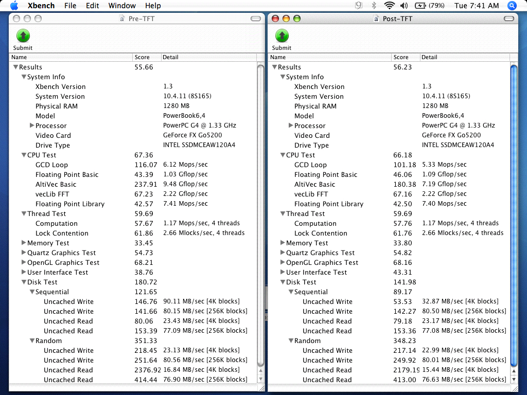

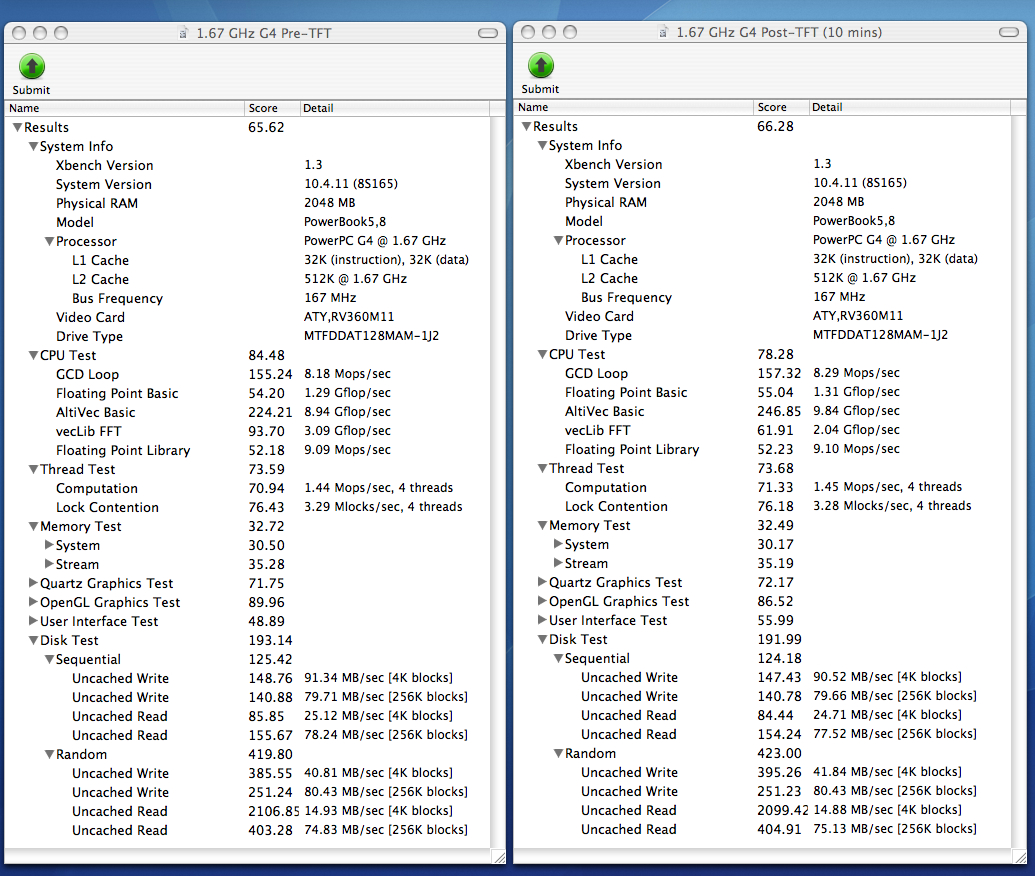

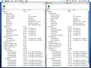

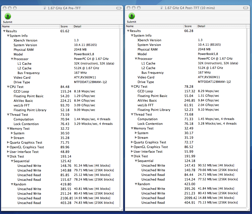

I had occasion to wipe my DLSD PB's drive, so I decided to install Tiger and give TenFourTrim a go. See Xbench results below:
After a fresh install of Tiger and applying all updates to 10.4.11. No optimizations of any kind. For disk results, bear in mind this PowerBook has a SSD, however it was freshly reformatted making garbage collection a non-issue.
Before applying TFT on the left; 10 minutes after TFT on the right.
I then used the PowerBook normally for a while, downloading & installing various apps, creating documents, watching videos, listening to music, etc. etc. Below are the results after about 4 hours of such use:

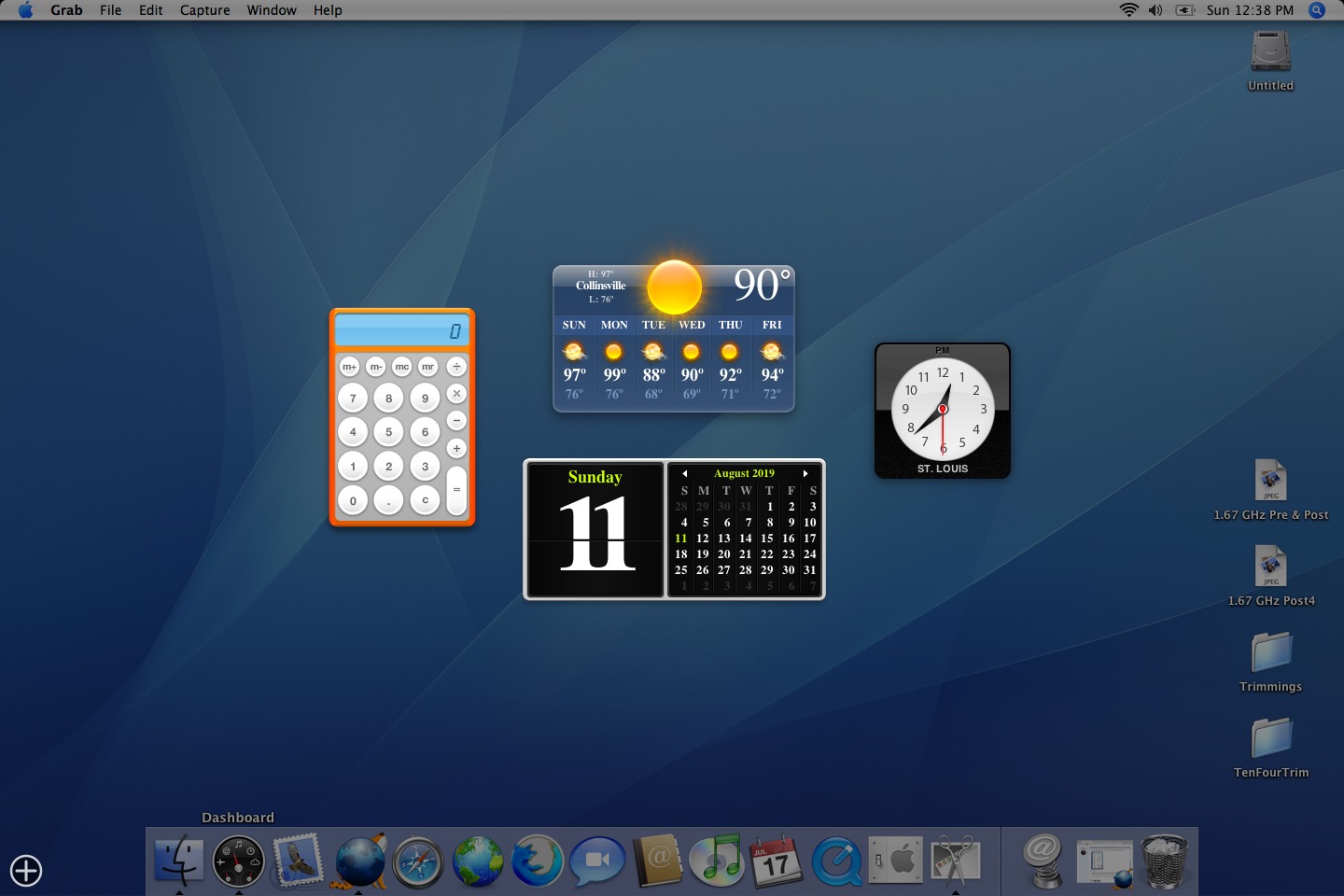

Notes to @z970mp:

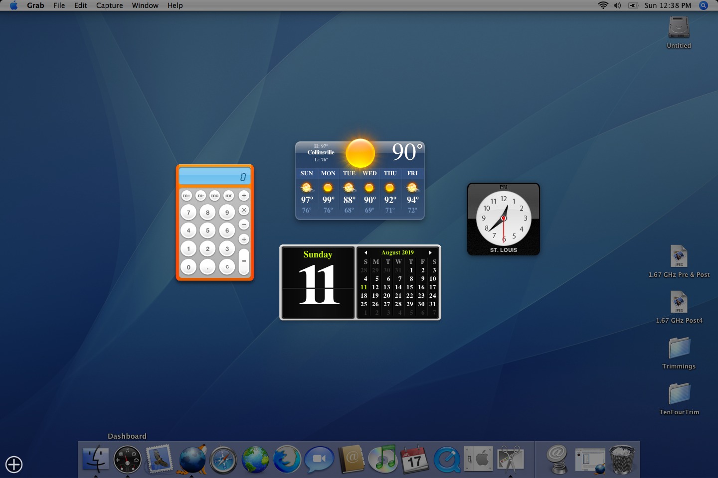

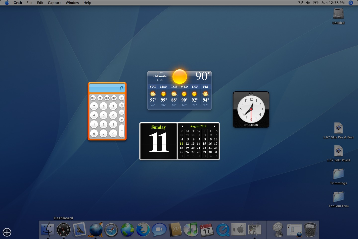

  1. The above were performed using the initial version of TFT, which was supposed to disable Dashboard.
  2. I watched the process in Terminal, and although it said it was disabling Dashboard, it didn't actually do so. Dashboard still functions after applying TFT, albeit with a different font:
  3. I'm not sure Xbench is the best metric for measuring TFT's results.
Notes to @z970mp:
I've noticed this too, though I was hoping the same wouldn't apply to other machines. It's strange because it was using the command that was supposed to disable Dashboard, and that apparently worked across "all" versions of OS X.
I don't know how else it could be removed via command, so maybe I'll just replace it with the Minus Dashboard version...
As to the font, I'll see what I can do.
