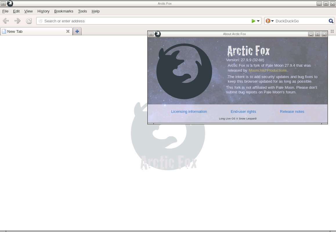

Prebuilt binaries available for: 10.6 & up 32-bit Intel, 10.6 & up 64-bit Intel, and 32-bit PowerPC Linux.
You can download Arctic Fox browser here, along with some add-ons and themes.
https://github.com/wicknix/Arctic-Fox/wiki/Downloads
Source available here:
Arctic Fox does not support jetpack or webextensions. Please only use verified working or ported add-ons from Pale Moons repository ( http://addons.palemoon.org/extensions/ ) and choose the version designed for v27, or get the tested ones linked from our download page. Some untested firefox add-ons may severely break your browser!
Mac OS X users: Use the 32-bit version if you want to use the older 32-bit plugins, like silverlight (for netflix).
For a better YouTube experience on low spec machines install GreaseMonkey and the ViewTube script. On Mac Arctic Fox will use the QuickTime browser plugin to play videos, and if you are on Linux install the vlc-browser-plugin.
To combat against javascript heavy sites, i recommend a mobile user agent override. In about:config add a new string "general.useragent.override" and use this override "Mozilla/5.0 (Linux; ppc; Mobile; rv:52.0) Gecko/20100101 Arcticfox/27.9.15". This will speed up sites like msn.com, bbc.co.uk, facebook, twitter etc and force a tablet style layout.
Arctic Fox is released "as-is" with the hope that it will be useful. As such, there is no warranty of any kind.
Cheers

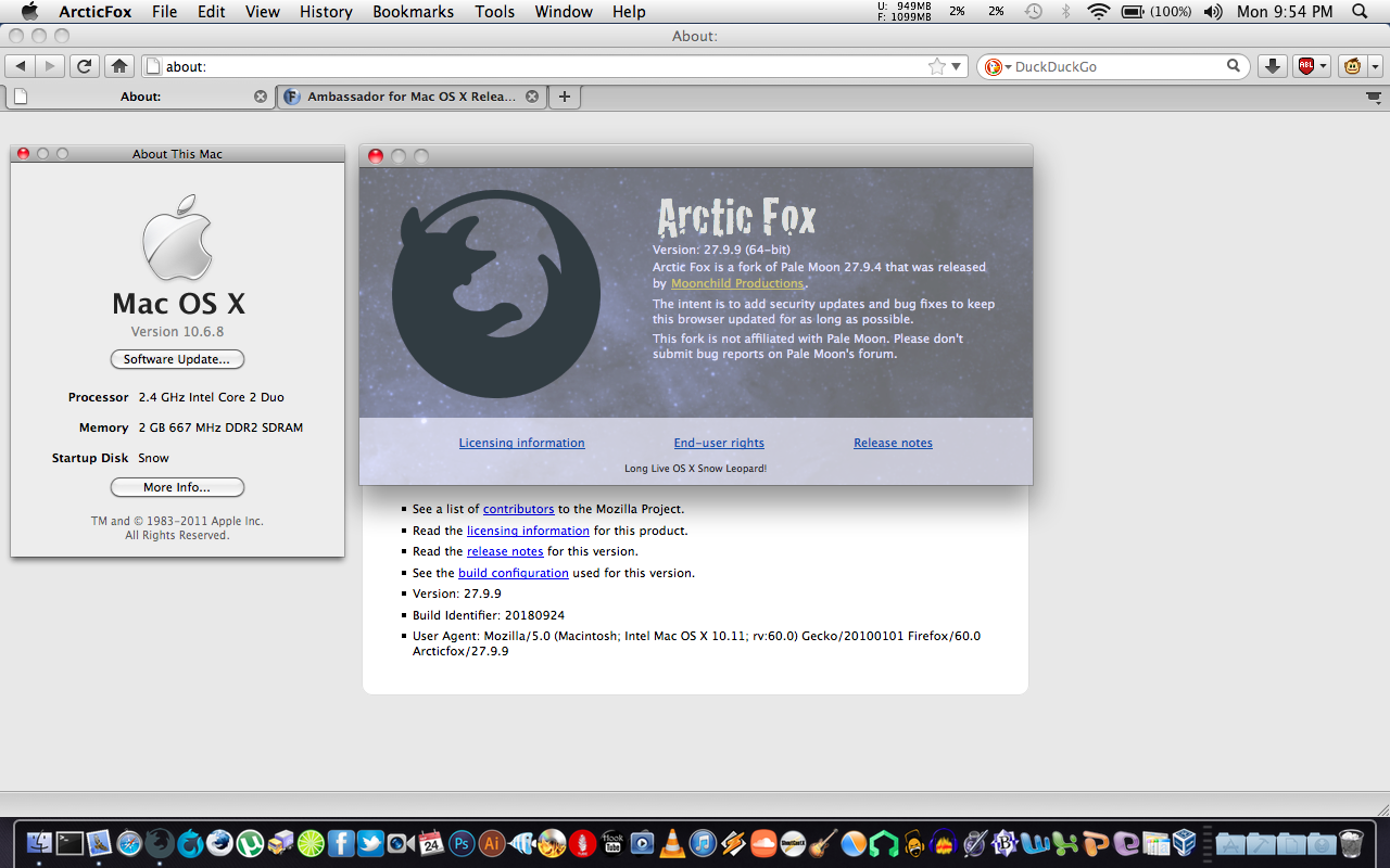

Also updated it again. Partially fixed missing private browsing min/max/close buttons. They work and are usable, just positioned on the wrong side (they display on the right, should be on the left), updated certificates which i borrowed from FF ESR60, and updated readme.
Cheers

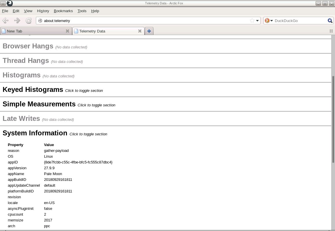

@wicknix Coming back with what I previously said, the problem with 28 isn't just libc++ related. There's also missing symbols from the system C library, it seems. If it goes no further than that, it may be possible to get it to run with a hacked 10.7 SDK so it can be built from vanilla sources. Though I no longer feel like trying right now, I have a functional (tested) build host on 10.6 if I ever want to retry.
@wicknix I have to throw in a working mozconfig since provided one is suitable only for Mac OS X, but source doesn't need any alteration.
My Xorg server uses a framebuffer device, so everything (inclusive to Arctic Fox) doesn't get HW acceleration. It runs at a very reasonable speed. For a reference comparison: loading pages/scrolling and general browsing is slightly snappier than TenFourFox. Though that's a bit unfair, given the fact that threads support is incredibly superior on linux than on tiger; tenfourfox will load my dual cpu config only to ~100% of a processor, where on linux [palemoon] will max out both cpus usage while under heavy load. That's where you can see who did tailor a nontrivial part of the codebase to run faster on powerpc while the other one was focused on *x86*. Javascript performance can't compare since tenfourfox has ION+baseline JIT while palemoon only interprets.
Though, in general, palemoon 27 being the most recent non-webkit browser codebase with a lot of major features that builds without trouble, it's very dependable 🙂

Sure thing. If you're going to compile on a single cpu, I can share a self-contained archive (dependencies included) with my build in it if you want before trying to compile. It may take a day if you compile on an iBook (my mdd is a dual 1.5ghz and my build disk reaches >100mb/s r/w, I need avg. 6 hours to compile). It's compiled with most favorable compiler flags for g4/7450. So unless you have a g3, I guess that could be of help if it works on your distro.
Depending on what you answer, and if @wicknix approves, I'll see where I can upload. Meanwhile I'll upload my mozconfig

Here's what my mozconfig looks like:
Code:
export CC="gcc-6.4.0 -flax-vector-conversions -O3 -mcpu=7450 -mtune=7450 -maltivec -mabi=altivec -falign-loops=16 -falign-functions=16 -falign-labels=16 -falign-jumps=16"
export CXX="g++-6.4.0 -flax-vector-conversions -fpermissive -O3 -mcpu=7450 -mtune=7450 -maltivec -mabi=altivec -falign-loops=16 -falign-functions=16 -falign-labels=16 -falign-jumps=16"
export LDFLAGS="-latomic"
mk_add_options MOZ_MAKE_FLAGS="-s -j2"
mk_add_options MOZ_OBJDIR=@TOPSRCDIR@/obj-ff-dbg
ac_add_options --disable-crashreporter
ac_add_options --disable-tests
ac_add_options --disable-debug
ac_add_options --disable-updater
ac_add_options --disable-mozril-geoloc
ac_add_options --disable-webrtc
ac_add_options --disable-safe-browsing
ac_add_options --disable-parental-controls
ac_add_options --enable-release
ac_add_options --disable-necko-wifi
ac_add_options --disable-eme
ac_add_options --disable-gamepad
ac_add_options --disable-dbus
ac_add_options --disable-gio
ac_add_options --disable-pulseaudio
ac_add_options --enable-strip
ac_add_options --enable-install-strip
ac_add_options --enable-application=browser
ac_add_options --with-branding=browser/branding/arcticfox
ac_add_options --enable-optimize
key points to make it compile on ppc32 are (don't omit any of these):
Code:
export CC="gcc -flax-vector-conversions"
export CXX="g++ -flax-vector-conversions -fpermissive"
#if you forget --enable-release you'll run out of address space at linking phase if you're on 32-bit linux
You may try to put compiler flags in $CFLAGS and CXXFLAGS since that's where they should belong.
Compilation succeeds boths with gcc 5.4 and 6.4, but 7.3 will barf on exception code.
mix these with the "standard" palemoon mozconfig found at (http://developer.palemoon.org/Developer_Guide:Build_Instructions/Pale_Moon/Linux) and it should do the job.
Oh, wow, I just noticed I forgot to use jemalloc in my mozconfig. I'm rolling one more build tomorrow it seems.
Reactions: aurora72
