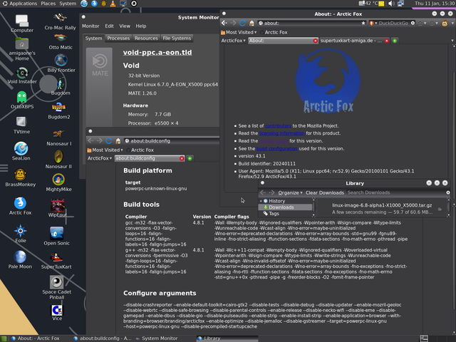

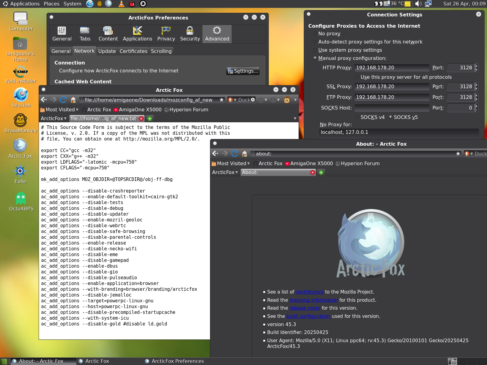

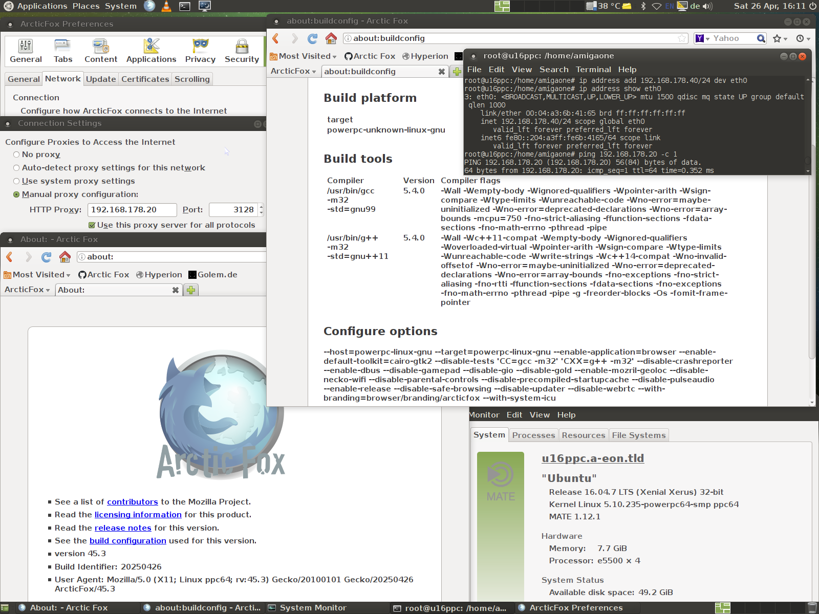

I compiled a non-altivec 32-bit version of Arctic Fox 43.1 for Ubuntu 10.04 and higher (12.04, 14.04, 16.04 etc). It also works on Void PPC, MintPPC (Debian Sid), Debian PPC 32-bit, and Fienix.
.mozconfig
Code:
# This Source Code Form is subject to the terms of the Mozilla Public
# License, v. 2.0. If a copy of the MPL was not distributed with this
# file, You can obtain one at http://mozilla.org/MPL/2.0/.
export CC="gcc -m32 -flax-vector-conversions -O3 -falign-loops=16 -falign-functions=16 -falign-labels=16 -falign-jumps=16"
export CXX="g++ -m32 -flax-vector-conversions -fpermissive -O3 -falign-loops=16 -falign-functions=16 -falign-labels=16 -falign-jumps=16"
export LDFLAGS="-latomic"
mk_add_options MOZ_OBJDIR=@TOPSRCDIR@/obj-ff-dbg
ac_add_options --disable-crashreporter
ac_add_options --enable-default-toolkit=cairo-gtk2
ac_add_options --disable-tests
ac_add_options --disable-debug
ac_add_options --disable-updater
ac_add_options --enable-mozril-geoloc
ac_add_options --disable-webrtc
ac_add_options --disable-safe-browsing
ac_add_options --disable-parental-controls
ac_add_options --enable-release
ac_add_options --disable-necko-wifi
ac_add_options --disable-eme
ac_add_options --disable-gamepad
ac_add_options --enable-dbus
ac_add_options --disable-gio
ac_add_options --disable-pulseaudio
ac_add_options --enable-strip
ac_add_options --enable-install-strip
ac_add_options --enable-application=browser
ac_add_options --with-branding=browser/branding/arcticfox
ac_add_options --enable-optimize
ac_add_options --disable-jemalloc
ac_add_options --disable-gstreamer
ac_add_options --target=powerpc-linux-gnu
ac_add_options --host=powerpc-linux-gnu
ac_add_options --disable-precompiled-startupcache
Download: arcticfox-43.1.en-US.linux-powerpc-libc6_2.11.1_without_altivec.tar.bz2

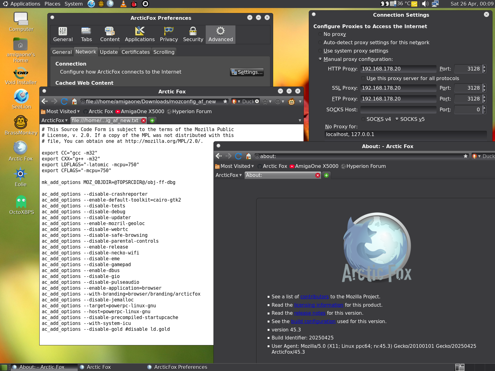

Oh by the way, I ran into ICE (!) with gcc-4.8 when building Arctic Fox:
Perhaps should switch to a newer gcc, but from what I understand modern ones aren’t supported, and gcc6–7 have plenty of stuff unfixed for ppc.
I appreciate you assembling Arctic Fox for Linux 32-bit PPC. Running Void Linux on my old PowerBook, the executable functions flawlessly. Could someone please remind me how to "install" it so that it appears in the menu bar and other places? I used dpkg to install the last version of Arctic Fox, which was a.deb file.
Has anyone compiled an Altivec version for 32bit Glib Linux? Arctic Fox works great on Void PPC on my PBG4.

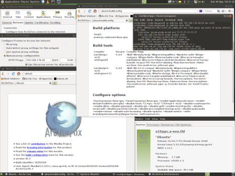

I compiled a PowerPC64/AltiVec version of Arctic Fox 40.1 today.
Download: arcticfox-40.1.linux-powerpc64-altivec.tar.bz2

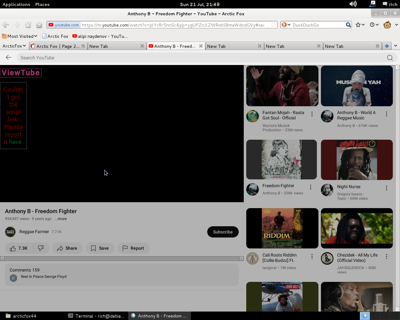

thanks very much xeno, could install .43 but there was no settings available? how can i install greasemonkey?
best of wishes.
ps. also ominous website www.bild.de causes still crash the browse.

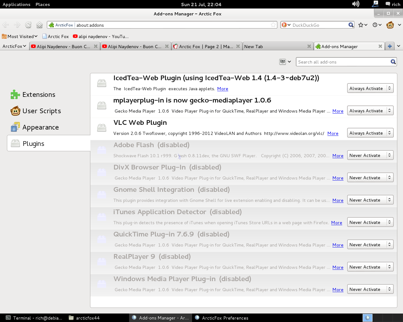

YouTube videos in HD with ViewTube and Arctic Fox
Installation instructions
  1. Download the VLC web browser plugin: libvlcplugin.so (32-bit).
  2. Copy the file "libvlcplugin.so" to the directory /usr/lib/mozilla/plugins/.
  3. Start Arctic Fox and install the add-on Greasemonkey version 3.31.4
  4. Restart Arctic Fox
  5. After that, add the ViewTubeTest script to Greasemonkey
  6. Then you have to activate the VLC plugin. You can activate it via Menu Arctic Fox - Add-ons - Plugins.
  7. You need to configure ViewTube via the 3 dots under the video. I use the embed video with Embed and play it with VLC.
atleast on the is one famous page m.youtaube.com the viewtube-test script is at the moment not offering the 3-dots for it settings (only 3-dot for youtbeu setting) ; maybe need another resolution monitor to get it better displayes.

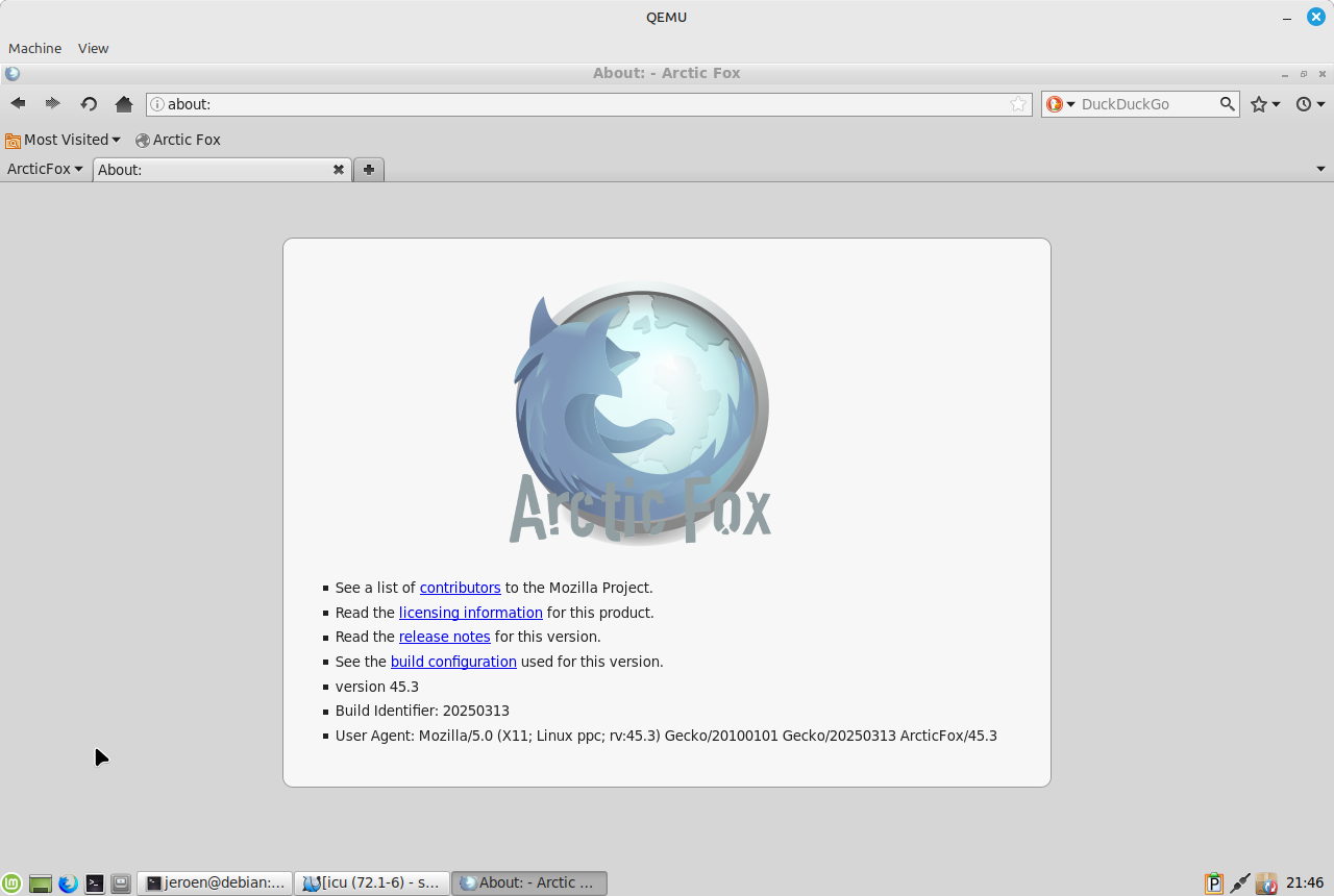

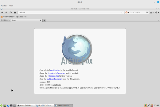

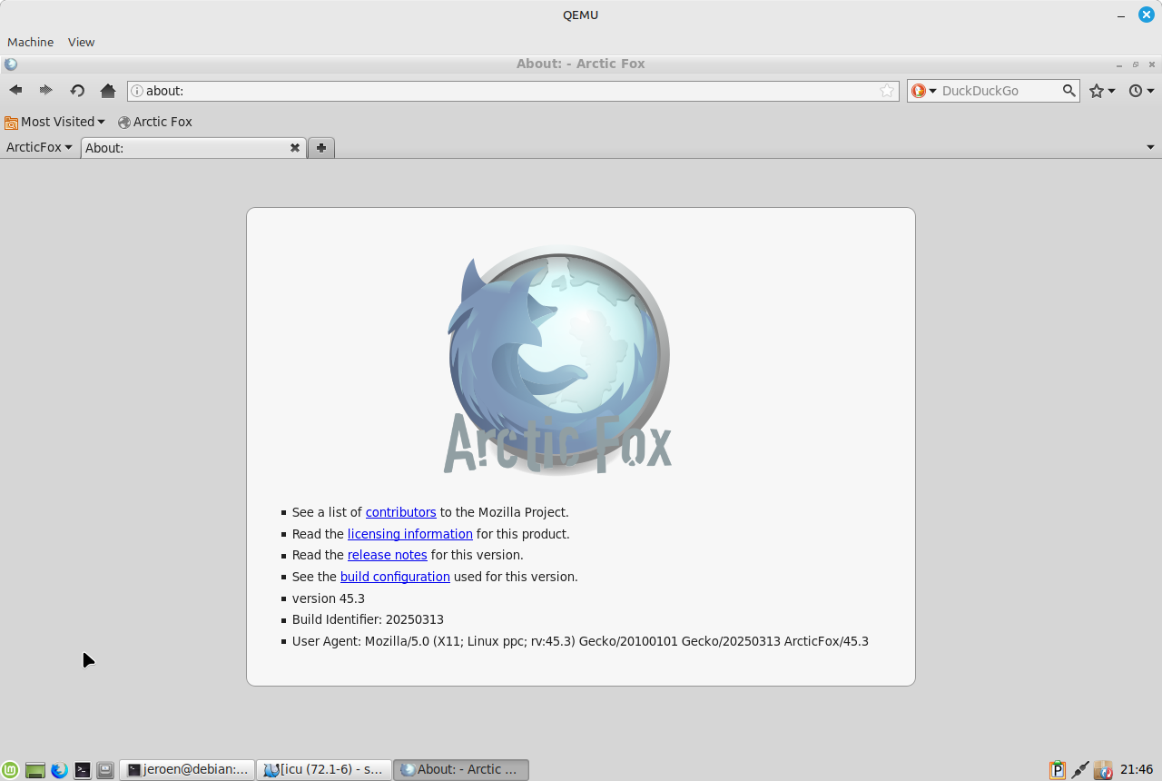

@xeno74 I tried your new version of arcticfox 45.3-2, installed it in a sid environment. I had to ln libicui18n.so, libicuuc.so and libicudata.so from 71 to 76 to make it work. I then received the following error.
jeroen@debian:/usr/lib/arcticfox$ ./arcticfox
XPCOMGlueLoad error for file /usr/lib/arcticfox/libxul.so:
/usr/lib/arcticfox/libxul.so: undefined symbol: ucol_getAvailable_71
Couldn't load XPCOM.
@xeno74 I tried your new version of arcticfox 45.3-2, installed it in a sid environment. I had to ln libui18n.so, libicuuc.so and libicudata.so from 71 to 76 to make it work. I then received the following error.
Which package did you try? There are two packages.
Download: github.com
I compiled it on Void PPC and on ubuntu MATE 16.04.7 PowerPC.
I get the same error now using the official package after soft linking several libraries from 72 to 76 (libicui18n, libicuuc, libicudata).
/usr/lib/arcticfox/libxul.so: undefined symbol: ucol_getAvailable_72
