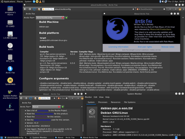

Arctic Fox 41.0 has been released.
New: github.com
Download Linux PPC G3 version: arcticfox-41.0.linux-powerpc-G3.tar.bz2
Download source code: v41.0.tar.gz

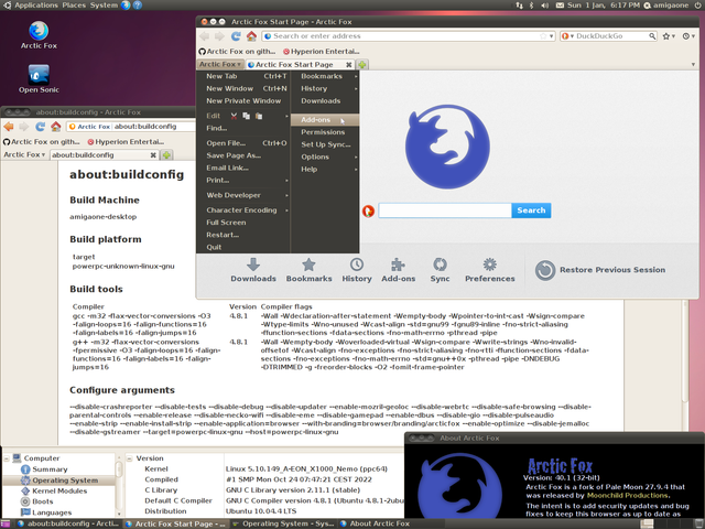

I compiled a non-altivec 32-bit version of Arctic Fox 41.0 for Ubuntu 10.04 and higher. It also works on Void PPC, MintPPC (Debian Sid), Fienix etc.
Download: arcticfox-41.0.linux-powerpc-libc6_2.11.1.tar.bz2

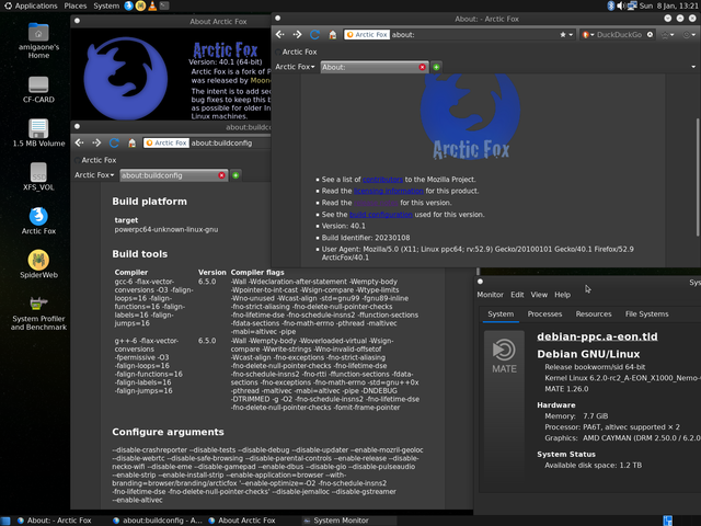

I also compiled an Arctic Fox 41.0 Linux PPC64 package with AltiVec support yesterday.
Download: arcticfox-41.0.linux-powerpc64-altivec.tar.bz2

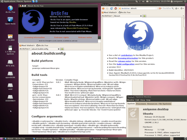

Arctic Fox 43.0 has been released.
New: github.com
Download Linux PPC G4 version: arcticfox-43.0.en-US.linux-powerpc-G4.tar.bz2
Download source code: Arctic-Fox-43.0.tar.gz
I compiled a non-altivec 32-bit version of Arctic Fox 43.0 for Ubuntu 10.04 and higher (12.04, 14.04, 16.04 etc). It also works on Void PPC, MintPPC (Debian Sid), Debian PPC 32-bit, and Fienix.
.mozconfig

export CC="gcc -m32 -flax-vector-conversions -O3 -falign-loops=16 -falign-functions=16 -falign-labels=16 -falign-jumps=16"
export CXX="g++ -m32 -flax-vector-conversions -fpermissive -O3 -falign-loops=16 -falign-functions=16 -falign-labels=16 -falign-jumps=16"
export LDFLAGS="-latomic"
mk_add_options MOZ_OBJDIR=@TOPSRCDIR@/obj-ff-dbg
ac_add_options --disable-crashreporter
ac_add_options --disable-tests
ac_add_options --disable-debug
ac_add_options --disable-updater
ac_add_options --enable-mozril-geoloc
ac_add_options --disable-webrtc
ac_add_options --disable-safe-browsing
ac_add_options --disable-parental-controls
ac_add_options --enable-release
ac_add_options --disable-necko-wifi
ac_add_options --disable-eme
ac_add_options --disable-gamepad
ac_add_options --enable-dbus
ac_add_options --disable-gio
ac_add_options --disable-pulseaudio
ac_add_options --enable-strip
ac_add_options --enable-install-strip
ac_add_options --enable-application=browser
ac_add_options --with-branding=browser/branding/arcticfox
ac_add_options --enable-optimize
ac_add_options --disable-jemalloc
ac_add_options --disable-gstreamer
ac_add_options --target=powerpc-linux-gnu
ac_add_options --host=powerpc-linux-gnu
ac_add_options --disable-precompiled-startupcache
Download: arcticfox-43.0.en-US.linux-powerpc-libc6_2.11.1.tar.bz2

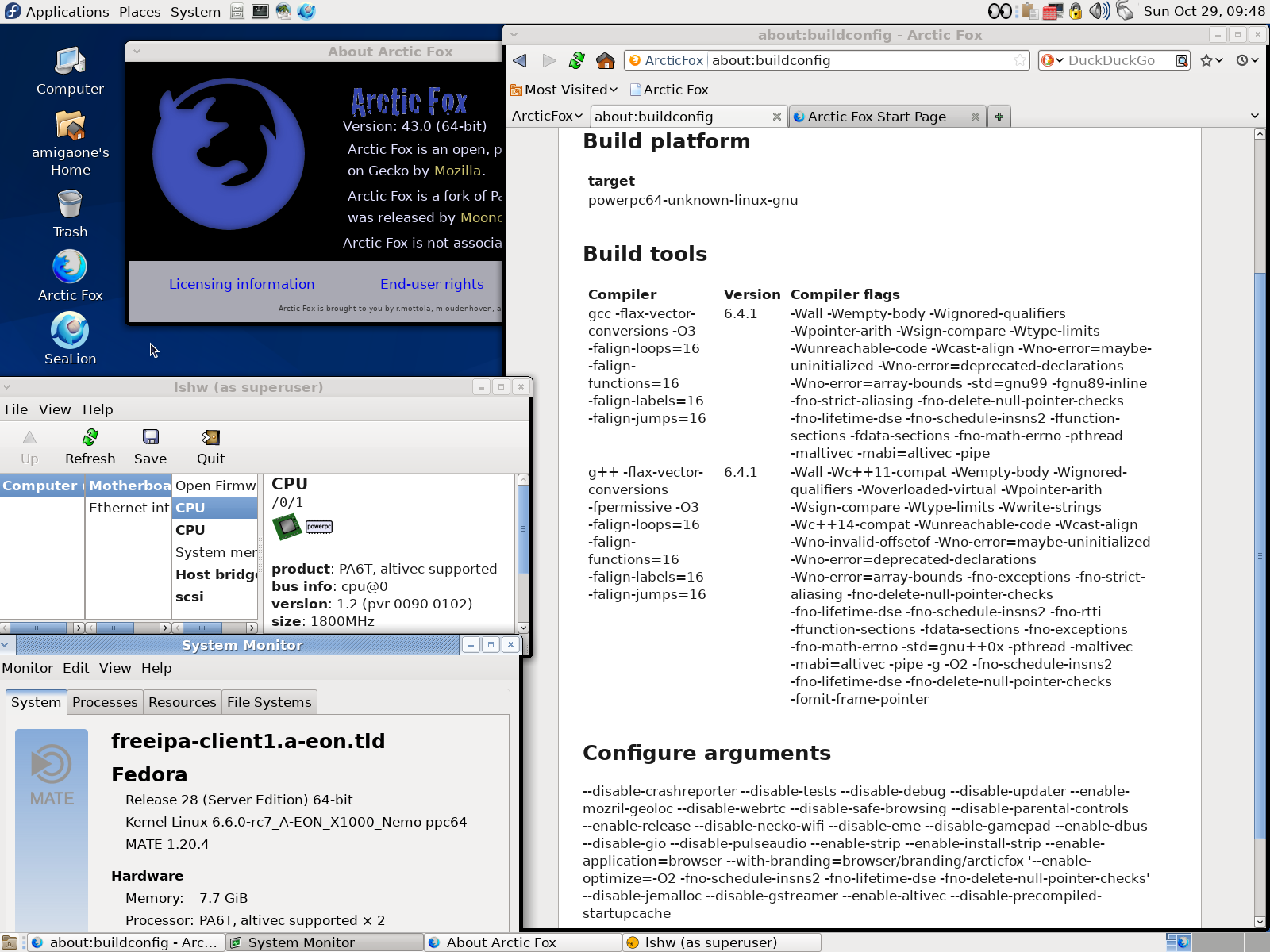

Hi All,

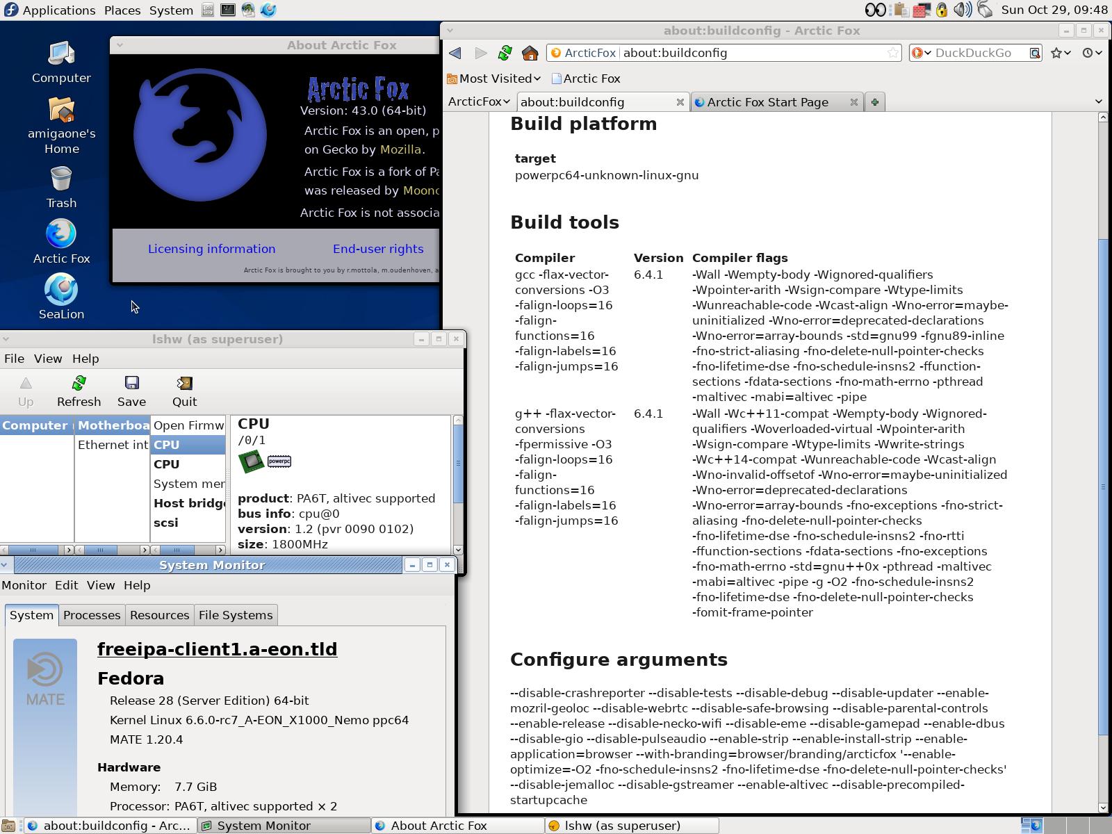

I compiled a Linux PPC64 version of ArcticFox 43.0 with AltiVec support today.
Download: arcticfox-43.0.en-US.linux-powerpc64-altivec.tar.bz2
Further information: forum.hyperion-entertainment.com

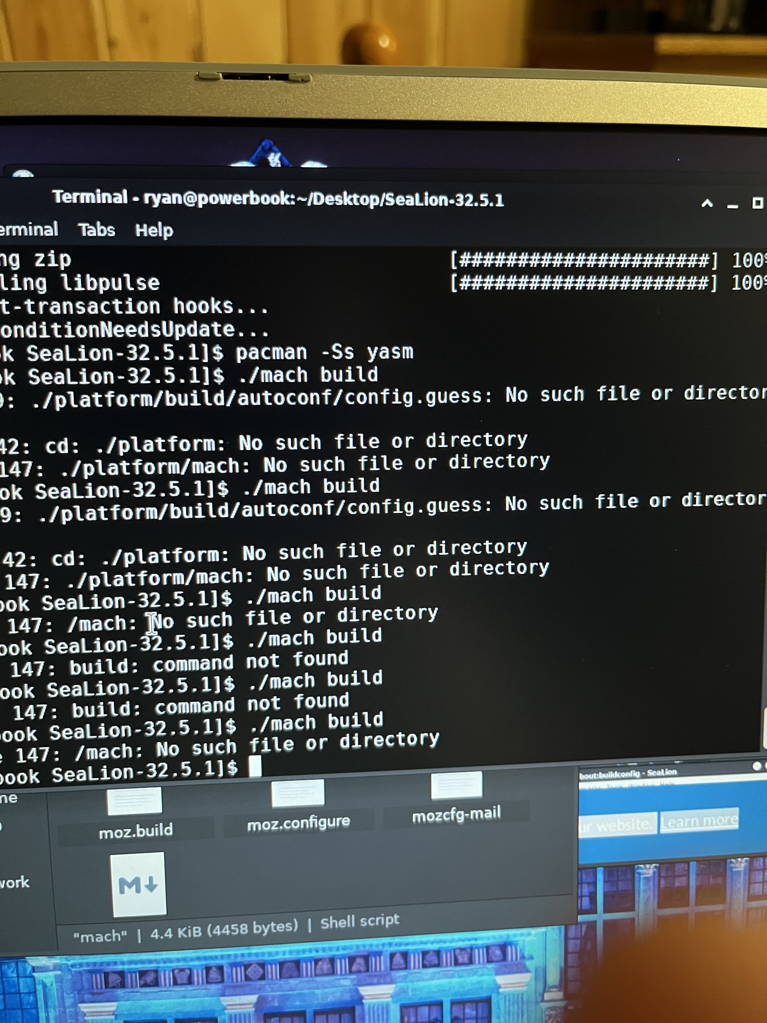

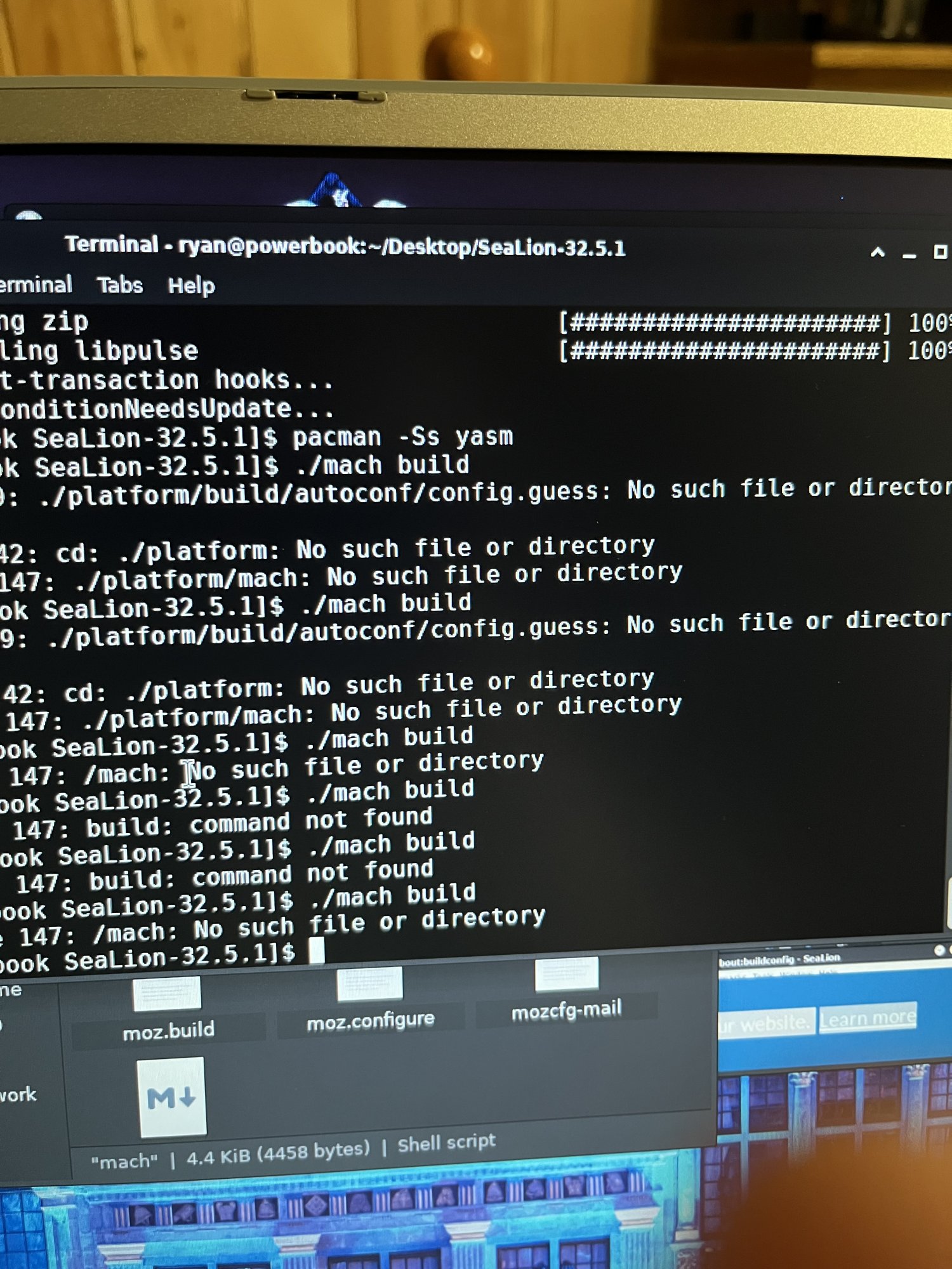

Can someone explain how to build this I have the dependency’s install I’ve copied the .mozfonfig data for PowerPC32 from the other site provided by @xeno74 but when I run ./mach build it comes up to an error I attached a screenshot I’m not sure what I’m missing and there are no instructions to build. No read me in source folder from @wicknix so I’m just kinda guessing a shorting in the dark. Like I said I’ve installed all the required decencies but I’m stuck with the ./platform no such file or directory error.
That means you are missing the UXP source code (the actual browser backend code). Sealion by itself is just the user interface. Download the UXP source which is linked on the sealion GitHub repo. Extract it, then rename the extracted uxp folder to platform. Then move the platform folder in to SeaLion-32.5.1.
If it builds there are a few more steps needed. Follow xeno74's guide on the site you found the mozconfig. It has to do with swapping out the ICU.dat file for the correct one for big endian and repacking the binary.
Cheers
