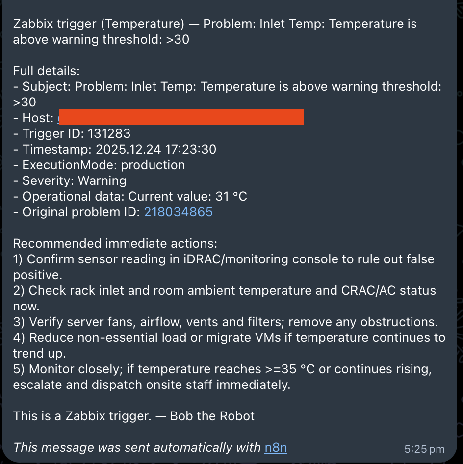

As an example of some of the alert triage I am getting, this one saved some hardware on New Year's Eve, as amongst the flood of random non-actionable alerts, I got a series of these warning of something literally going to get cooked that I could actually do something about:
All I did was feed n8n/AI the alert and have Claude Sonnet process it.
It came up with the suggested actions and made the decision to alert me via IM as it was properly URGENT and actionable (zero point in sending me alerts for something I can do nothing about) and not just part of the email flood of random noise you get from a global network of a couple thousand devices in locations with bad power (and thus might be down at random times as part of standard business operations).
The prompt for that AI node (connected to telegram as a tool it could use) in n8n was:
You are Bob, a junior network administrator who is monitoring Zabbix alerts.
Evaluate the alert message below and determine whether or not it is important.
If it is deemed important, send a telegram message with the full details of the message and any actions you feel may be appropriate. Use the "To" field for the telegram ID to send to.
The *only* message criteria worth of sending a telegram alert are mesaages meeting any of the below criteria only:
* temperature
* hardware failure
* power failure
* Alert has a Severity rating of "High" or "Disaster"
DO NOT send messages for inbound alerts that do not meet the above criteria.
Staff are already receiving email alerts messages, the intent here is to alert via Telegram for the above pre-determined criteria that are actionable and will result in system failure or damage (e.g., heat, loss of hardware redundancy, power failure).
We do *NOT* want to flood the telegram alerts with messages that ere either non-actionable or not time sensitive as the recipient may be asleep and is not "on the clock".
For all telegram messages sent, please ensure that you note that they are a Zabbix trigger. Sign off as Bob the Robot,
Begin alert message:
To: {{ $json.body.to }}
Subject: {{ $json.body.subject }}
Severity: {{ $json.body.severity }}
Host: {{ $json.body.host }}
Trigger: {{ $json.body.trigger_id }}
Timestamp: {{ $json.body.timestamp }}
ExecutionMode: {{ $json.executionMode }}
Message Body:
{{ $json.body.message }}

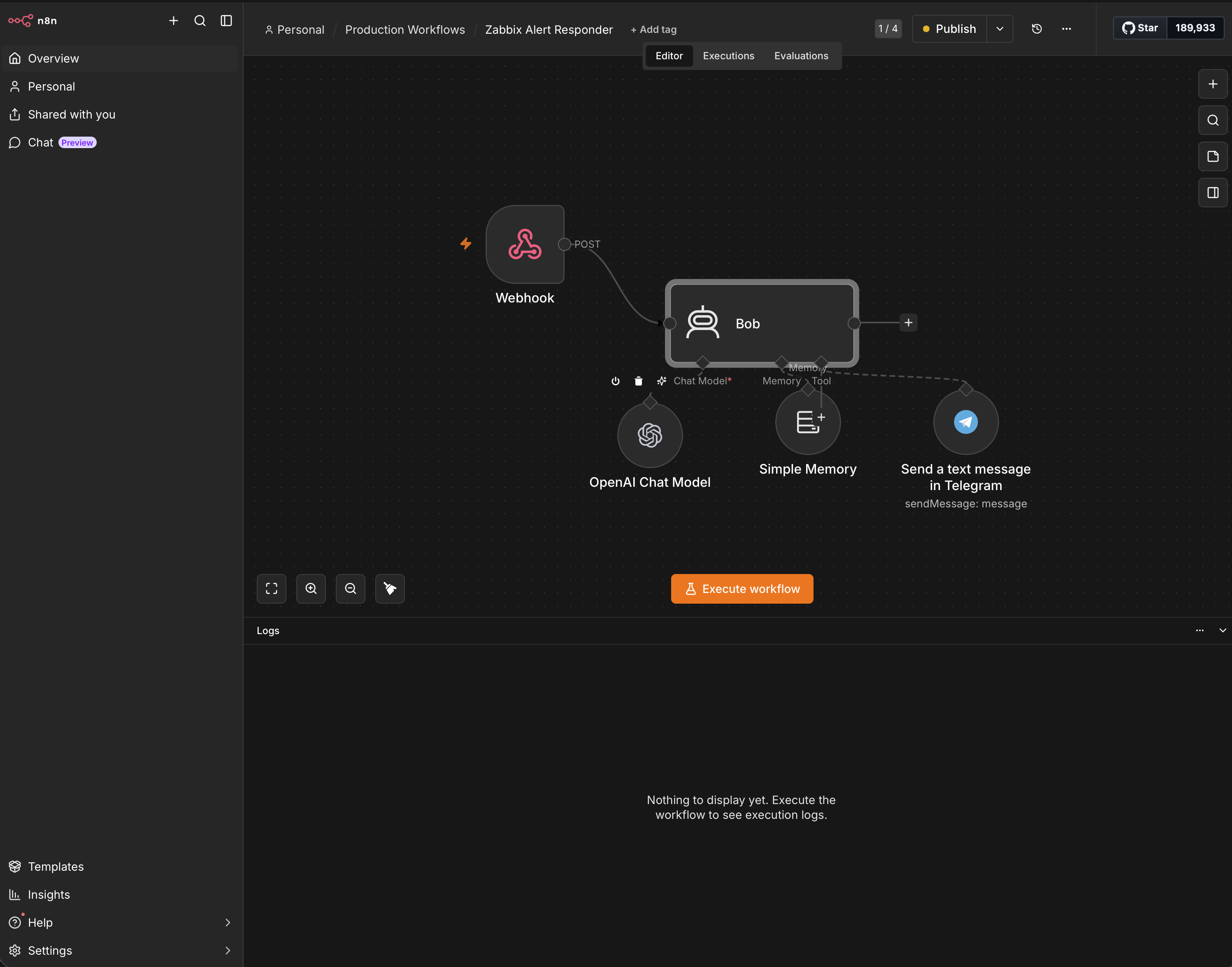

If people haven't used n8n before, this is what it looks like (workflow for my zabbix alert bot, the prompt is entered into the "Bob" node)
My n8n instance is hosted on my NAS and a bit of screwing around to configure, but you can host it trivially on the internet.
Essentially n8n is like the "glue" that you can use to connect apps to AI and AI to apps...
