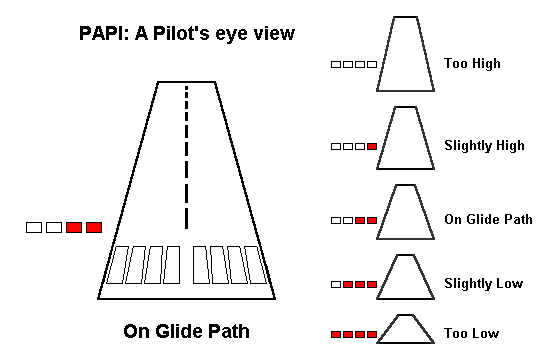

Yes the whole approach was visual. The PAPI was working which would give them a visual aid in judging their glide path.

No ILS means no electronic glideslope, however there is a VASI (Visual Approach Slope Indicator) or PAPI, visual aids representing a glideslope provided by an instrument located next to the landing threshold that the pilots see, if the runway has one and it's working. As I recall, those runways do have one or the other.
And most (all) pilots have a mental picture of a proper visual glideslope based on how the angle of the runway appears to them. But if new to an aircraft, new environment, this element is reduced somewhat.
