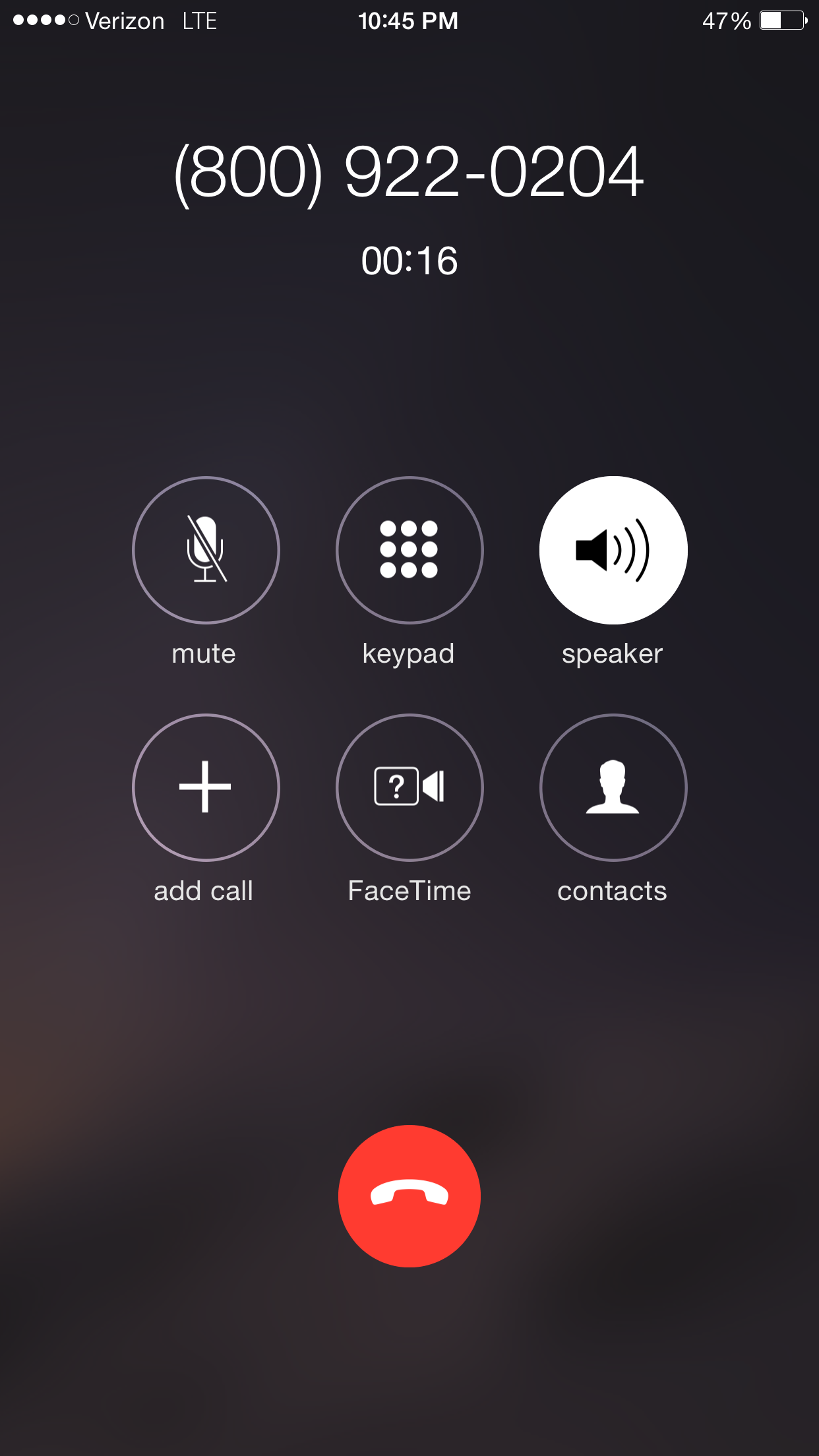

No source needed. HD Voice and VoLTE are not the same thing, never have been and never will be - so your sources aren't applicable. HD Voice is the AMR-WB voice codec. Nothing more. Its use pre-dates the first VoLTE deployment by nearly a decade. In the US, it was launched by T-Mobile on UMTS and GSM a year before they ever hinted at VoLTE. Sprint uses it as well, with no VoLTE whatsoever.

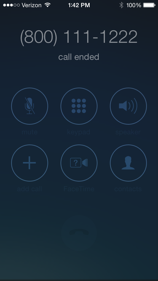

Here's a screenshot from the last time we had to have this discussion, courtesy of someone else... calling an 800 number, on VoLTE:
Well ok. Not sure a screenshot is any proof but thats ok. I asked for real info but apparently a screenshot is all you need, (no source needed) So based on my screenshot, does that mean Verizon now supports wifi calling? I mean since I see the wifi symbol during a call?
That is a ridiculously stupid question that I am sure you already know the answer to.
What more do you need exactly? The two best ways to test this are: get access to the VoLTE specification white paper from 3GPP, or test it yourself (deductive reasoning is useful here!). The iPhone has one radio, therefore it can only be in one mode at a time. If the phone is in a call and still on LTE, then it must be using VoLTE, no? The 800 number in his image is the landline call center for Verizon Wireless. Clearly it works.
Further, from Wiki:
"To ensure compatibility, 3GPP demands at least AMR-NB codec (narrow band), but the recommended speech codec for VoLTE is Adaptive Multi-Rate Wideband, also known as HD Voice. This codec is mandated in 3GPP networks that support 16 kHz sampling." - http://en.wikipedia.org/wiki/VoLTE#Voice_quality
Why exactly would VoLTE support AMR Narrowband (the usual old GSM speech codec) if the only reason VoLTE was used was to facilitate an HD Voice call? Or if even VoLTE and HD Voice were synonymous terms (they are not).
Multiple people have had experiences opposite to your supposition through actual testing. As much as I see various sites on the net conflating HD Voice and VoLTE, I wouldn't put much stock in your "sources."
Maybe we're all just elaborate trolls 🙄

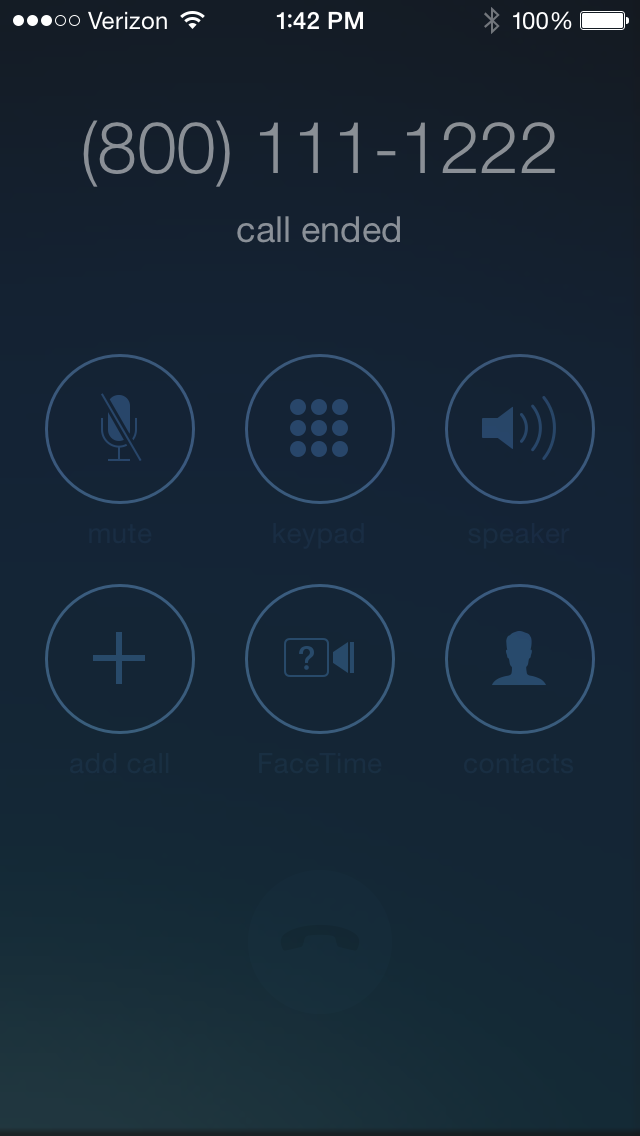

Nope. It says the words "Wifi" while on a Wifi call. Just like it displays the technology the call is on in other situations, be it LTE, 4G, 3G, G (sm), or 1x.
But no proof is needed regardless of the situation if actual demonstration of it functioning isn't good enough. Especially when I know precisely how it works in the first place and am not confusing the HD Voice codec with the network voice carriage takes place on.
Riddle me this, how would the device know what was on the other end if it doesn't start the call?
