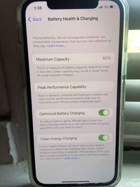

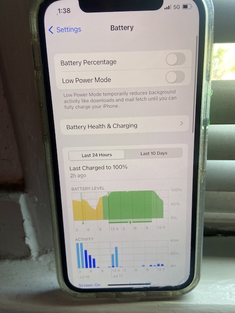

I don’t know if anyone here services Apple products, but I’ve replaced over 100 iPhone batteries and up until today, I was under the impression that once the battery wear reached 85%, it would say “service battery“ but this iPhone 12 pro is at 80% and says nothing.
Due to his random shut downs, I’m certain it’s the battery, but why doesn’t it say service?

I believe the "Battery health degraded" or "Service" message will show once the battery hits 79%. Apple usually won't replace the battery until it goes below 80%. (The screenshot in the link below also shows 79% where this is mentioned.)
Once the phone experiences an unexpected shutdown due to the battery, it should start throttling and state this under the Peak Performance Capability section. It'll also give you the option to disable the performance management, which would increase your chances of another unexpected shutdown again. This is not showing up for you, so the phone should be running at normal performance and the random shutdowns could be due to something else.

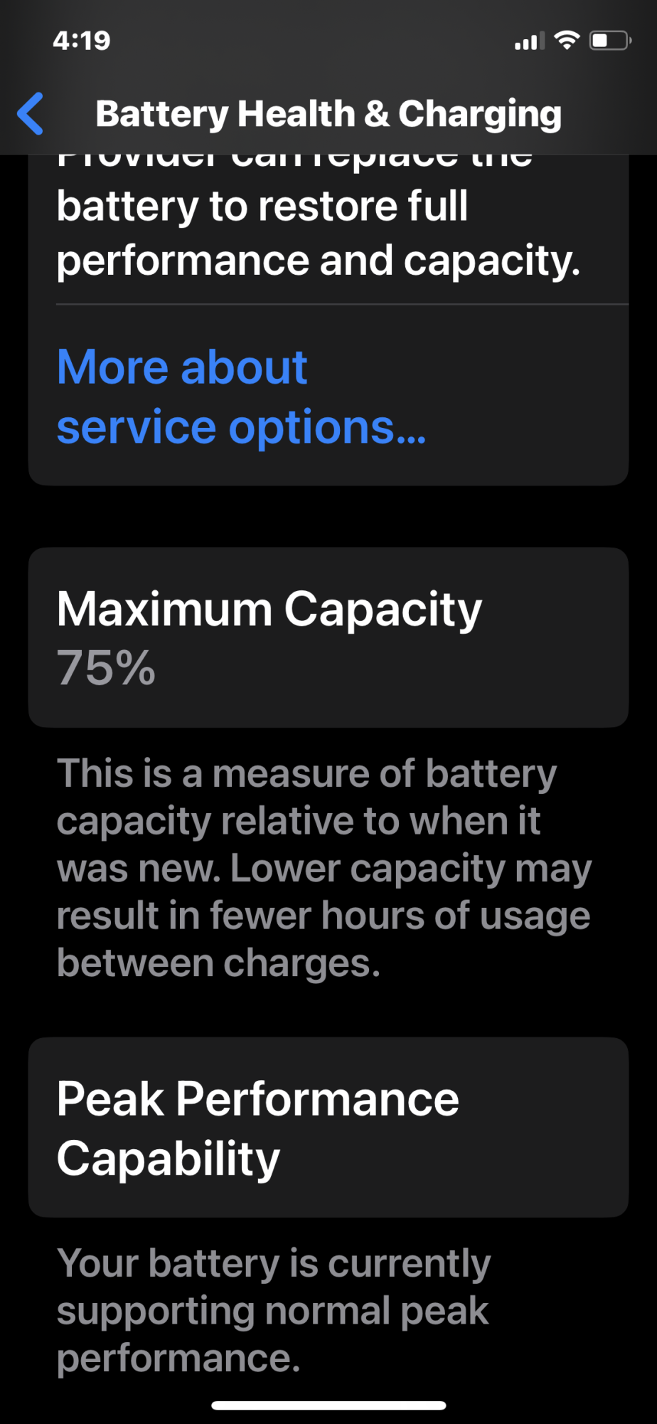

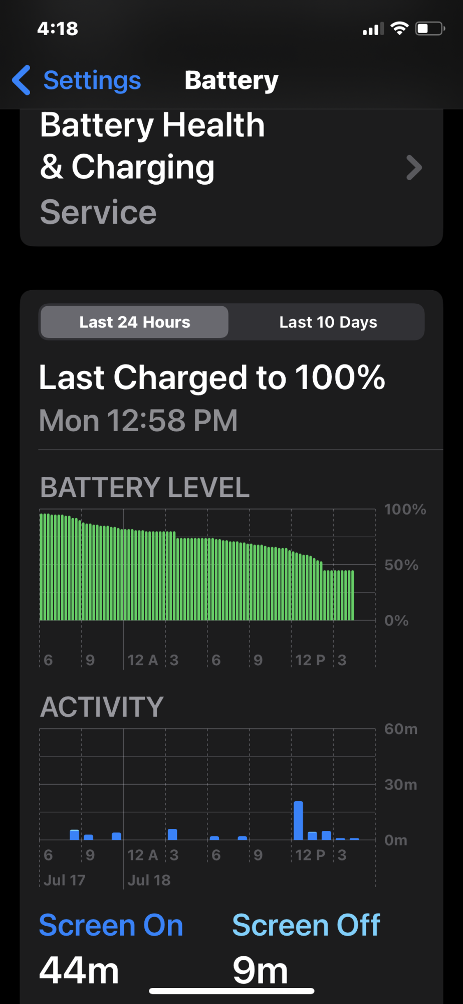

My iPhone X showed the "service battery" notification and started showing classic worn battery symptoms at 82%. Had it replaced by Apple (at my cost) in less than an hour and been going strong since

Never if it’s on the original iOS version. Below 80% if sufficiently updated, but this varies from device to device (probably due to the iOS version that runs on the device). Some have complained as soon as 79%, while others run fine with a lot less. I don’t think there’s a hard rule.
