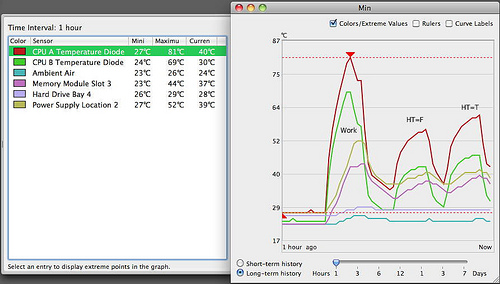

4208673982
HT=F is hyperthreading off
HT=T is hyperthreading on
each played in iTunes one track 9.4minutes, nothing else running.
(curved labeled Work is with hyperthreading, sound track, plus doing some work)
ambient temperature chilly.
interesting. slight change in termperatures but there is still a rise.
