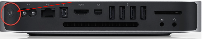

My Mac Mini boots every time I turn on the power switch, as indicated in the photo.
Are you saying yours will not respond to this switch, or are you perhaps referring to some external switch such as a power-bar?
