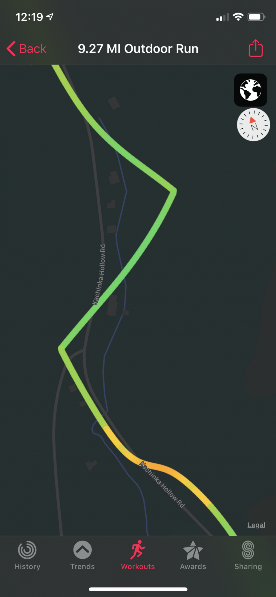

@MJ22, and your tracks look fine with LTE enabled?

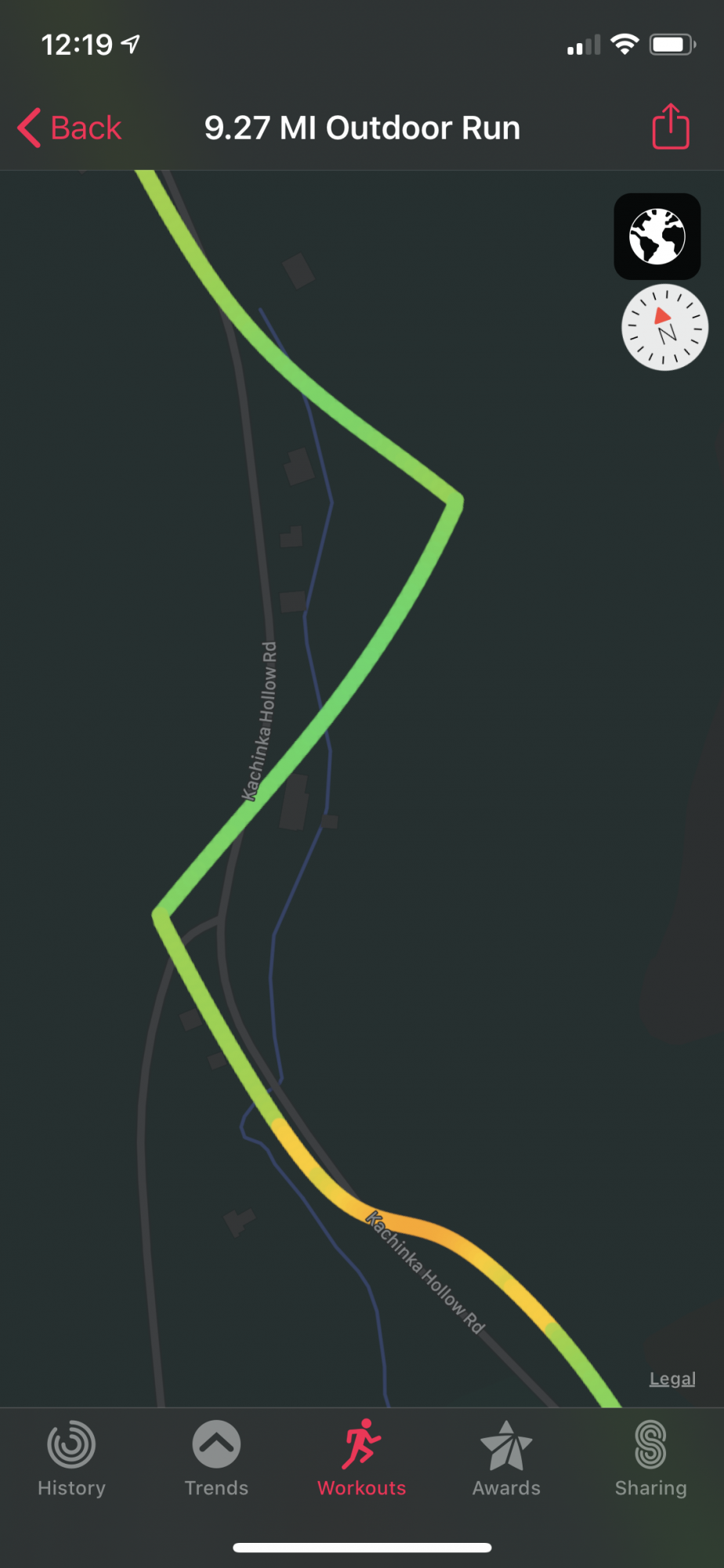

It is not great. Here’s a portion of the worst run I had with it - which was a 9 mile race where it was .27 (!!!) long. I should be on the gray Kachinka Hollow Road. I missed an award by 3 seconds. Ugh. I was so, so mad. It’s usually not THIS far off, but the longer my run, the further ahead my GPS distance is than my running partners.
Yes, does not look great, but still a bit away from the ugliest tracks here. But of course not optimal. Far from optimal.
Yeah, I run to place and win, so it’s imperative that my watch be accurate. Especially in a longer race like this one, where it’s not as easy to gauge your overall pace (or place) during the race.

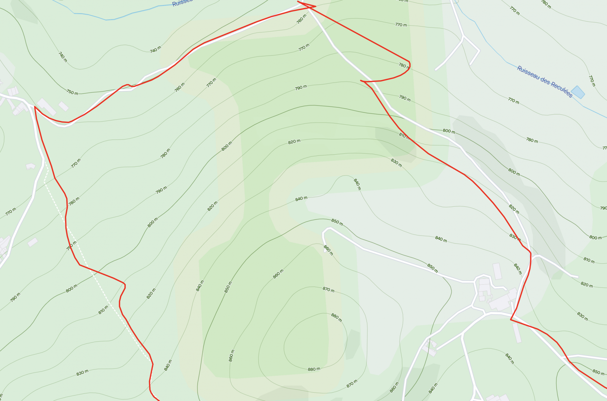

Summary of the morning trail:
- my watch with LTE ON : 20,1KM
- my wife with S3 (no LTE but with her iPhone) : 19,1KM
We are both using apple built-in app
Tomorrow I go back to Apple support ...
At 3 or 4 places ...

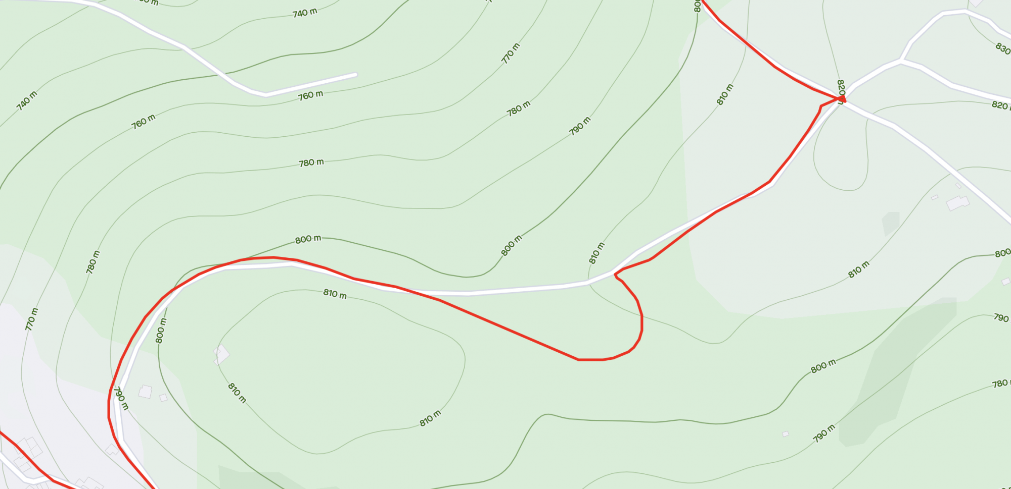

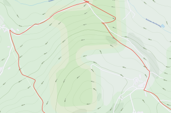

Some examples on these screenshots ...

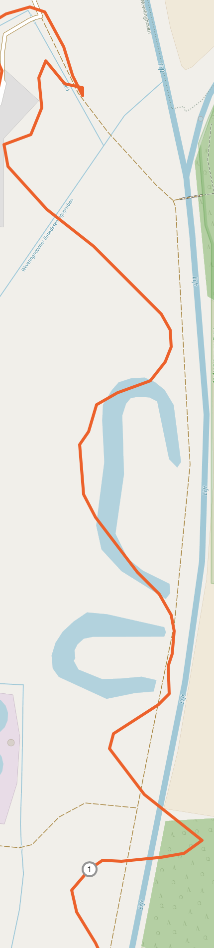

Ah, looks a lot better than my run with LTE enabled (podcast was not yet downloaded so I had to put LTE on for the first hour):
(Brown path is the path I was running)
It's just a part of the trail.
And it's really zoom-out ...
At the end, it's 1km more for 20km...
