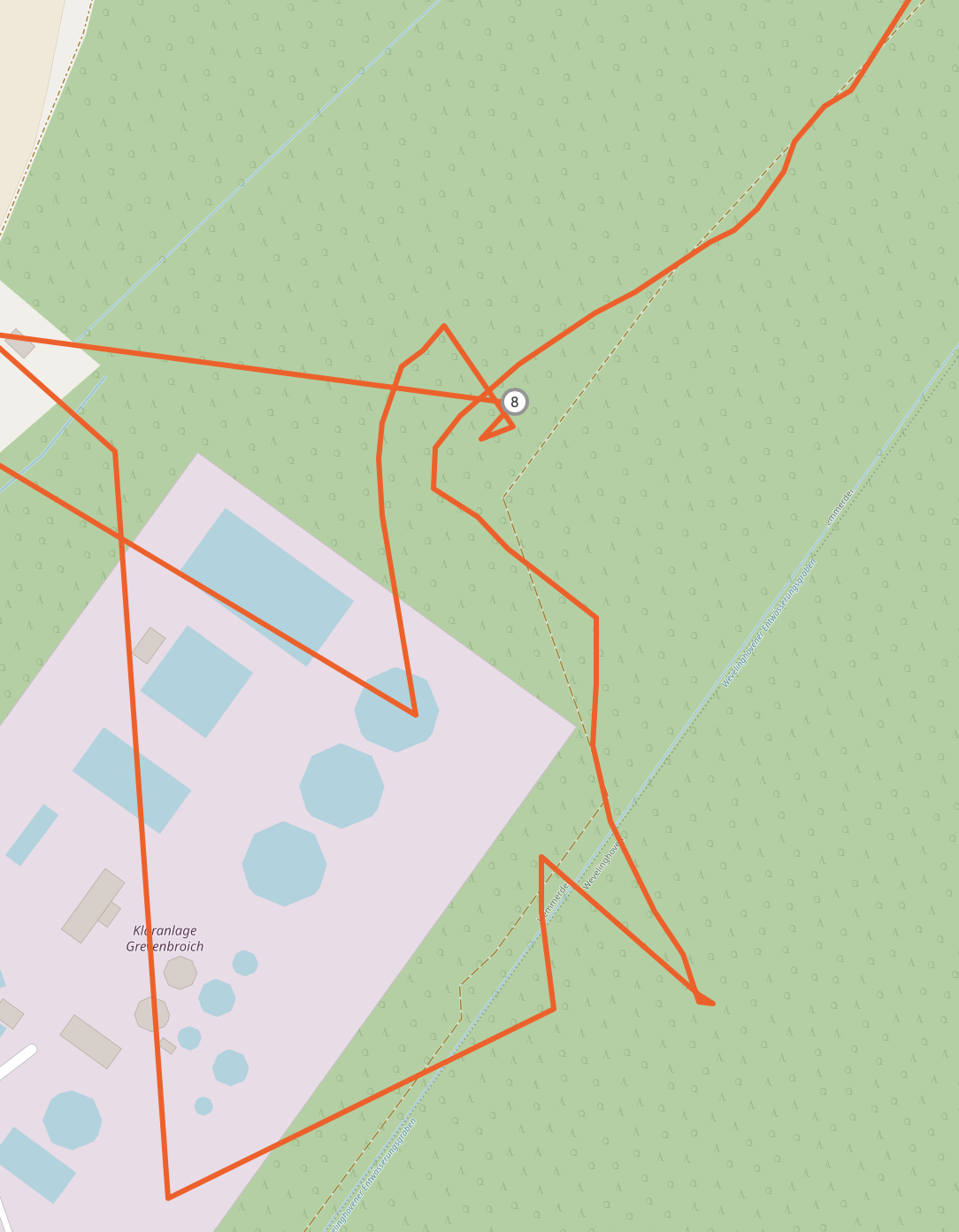

And I thought it was getting a little better. Wrong.
Look at this, I ran the brown dotted path and what my watch with LTE enabled produced out of it... Bizarre.

In the past I had zig zags and circles when we had a track difference of 700m on the 10km track. Now with the 200m it is just not as sharp and going. Attached is a good example... sometimes it is more off track and sometimes less. Usually it is less off track, but a little bit and the sum is the problem.
Again, I cannot test the AW OS7 public beta!
