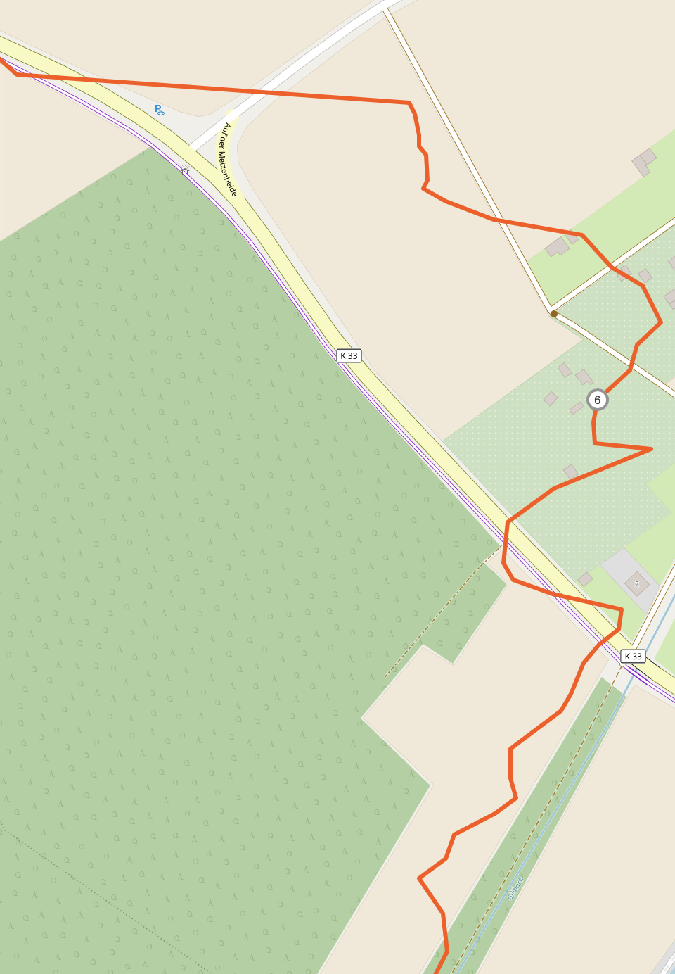

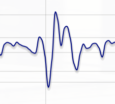

In runalyze the hiccups are easy to locate, I only have to look at such patterns in the pace chart:

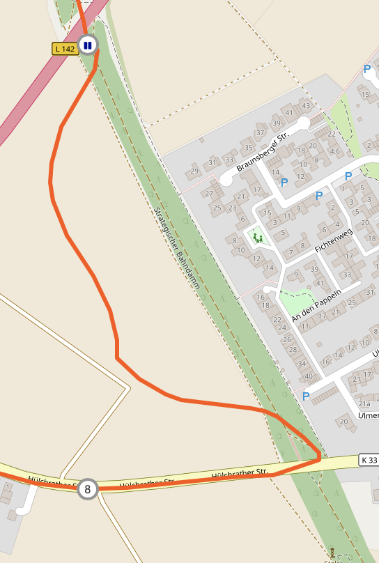

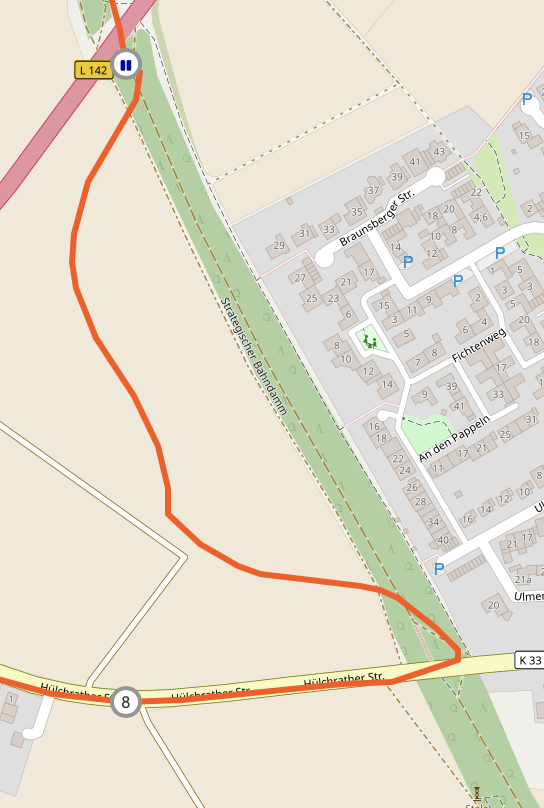

And here is the hiccup. Difficult area, but last week was flawless without LTE. Today:
In that map are those apartments on the right side? I wonder if that is the cause of the hiccup. I have done walks/runs with my AW5 and literally had it wobble when walking near trees on a sidewalk.
No, on the left. And they are not high. As I am running on a dam they are more or less on the same level. Tree cover is quite dense there.

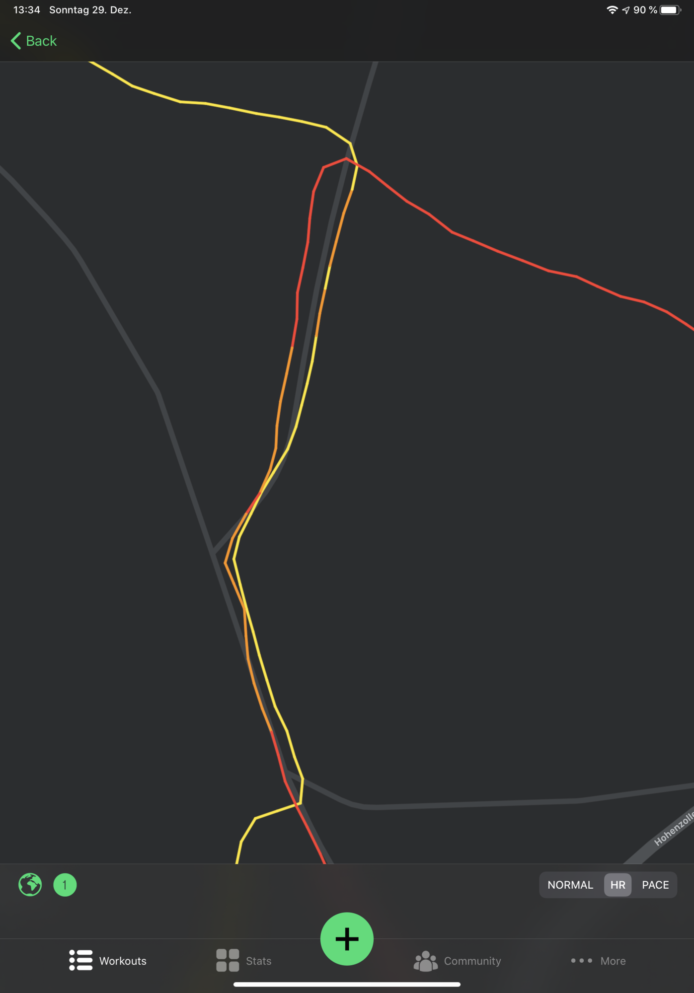

My run today .... 8km with LTE, Airpods and streaming favorites playlist. For me it looks fine, slightly left or right of the track is within tolerance.

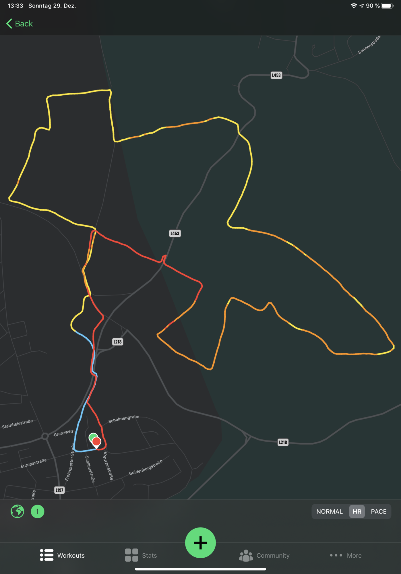

Look at this mess of a track. I came from a heavy tree covered area (dotted path) to the big street with perfect conditions. Track is all over the place:
