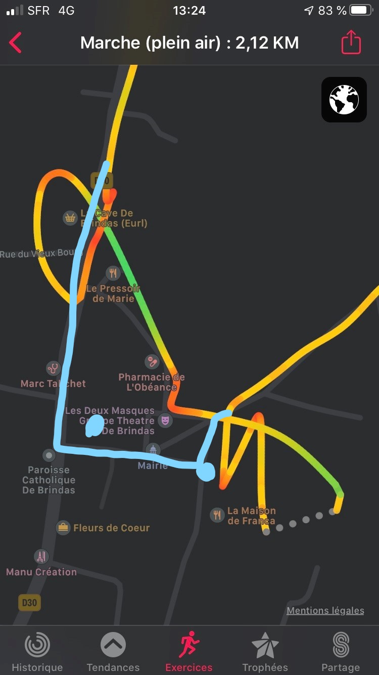

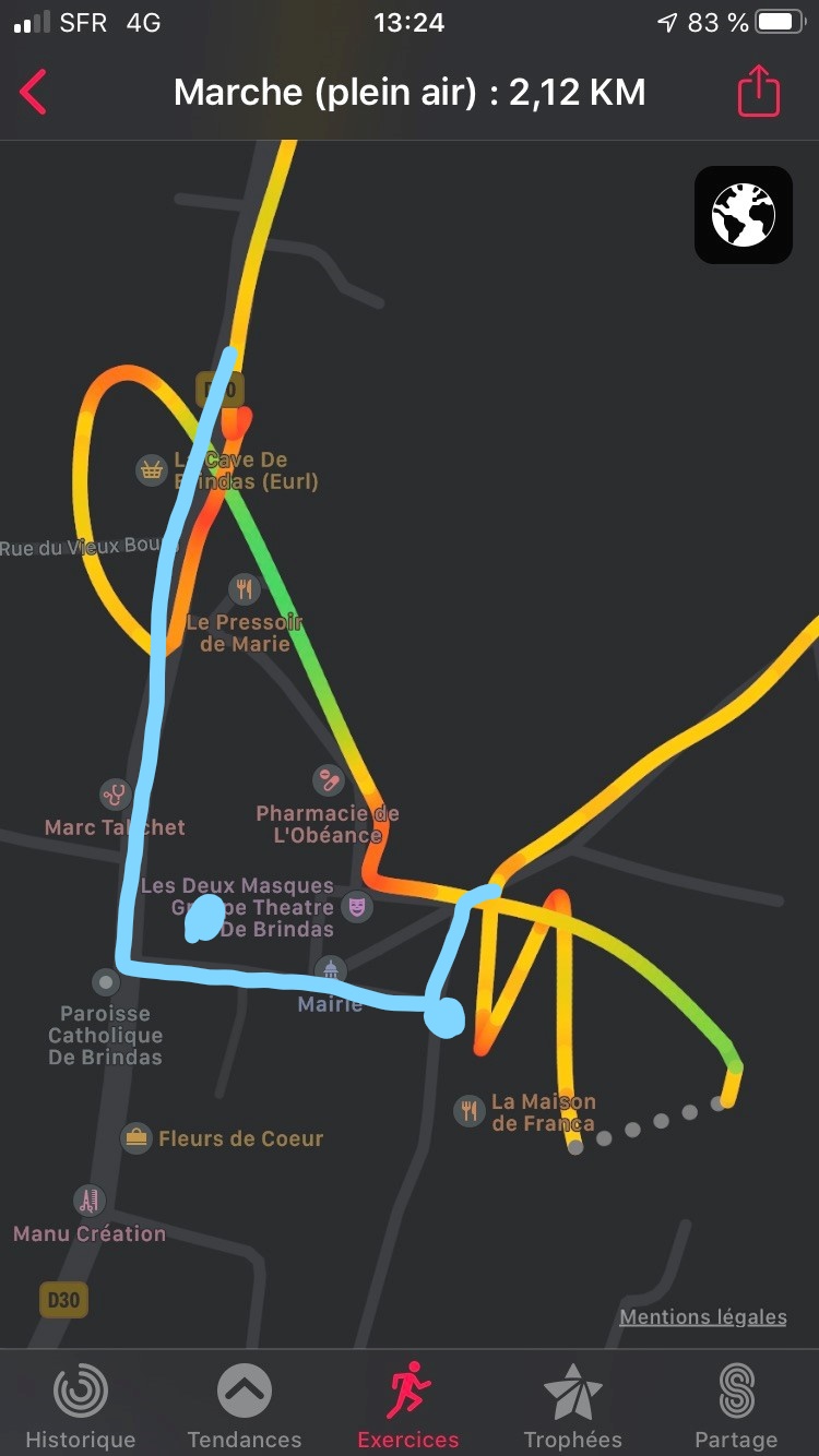

Yesterday I have walked with my watch+phone and I has the same accuracy issues with very strange tracking in some places.
The actual track is in light blue with 2 stops in shops (light blue circle)
So it's not really linked to the watch hardware.
Wow, looks crazy. So there is at least hope. Maybe Apple is more interested in fixing problems with iPhones than with Apple Watches. And if they fix it on the iPhone, the AW fix should be possible.
