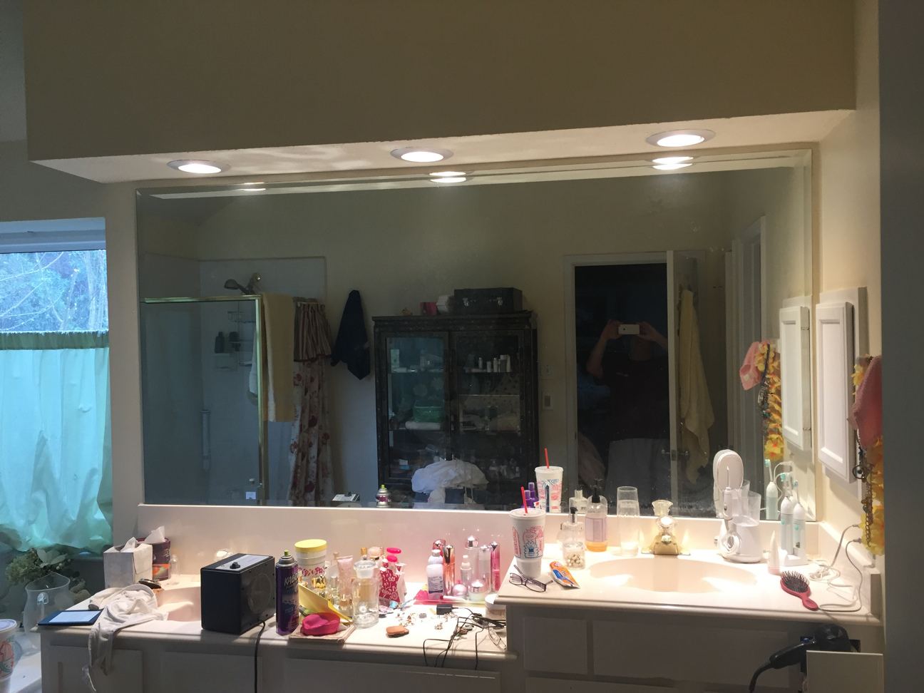

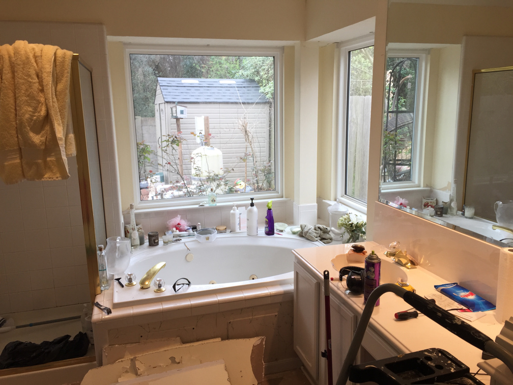

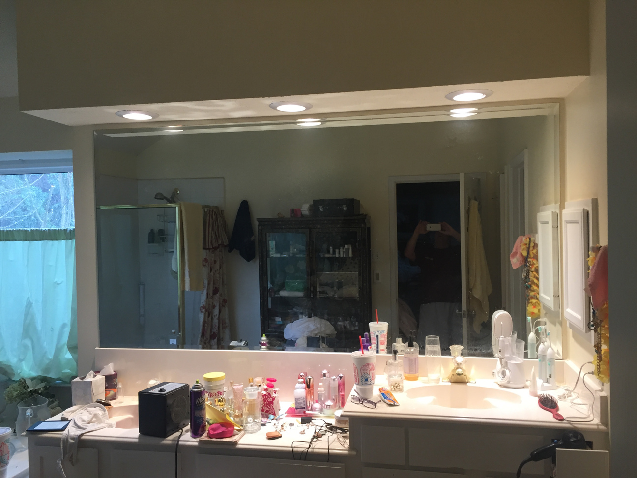

Before:
Day 1: Destroy
Testing the waters

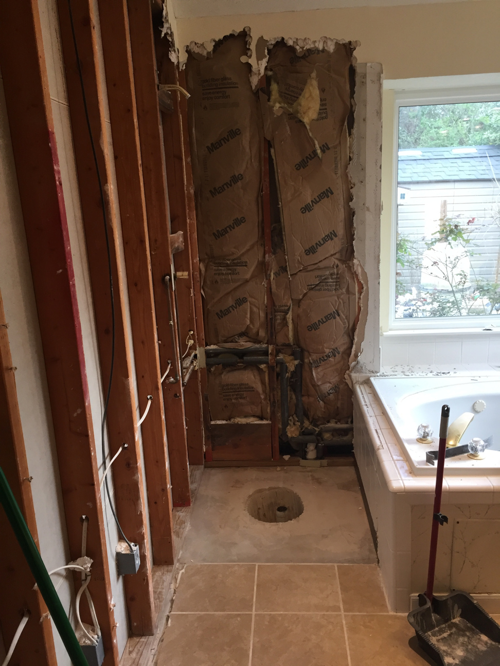

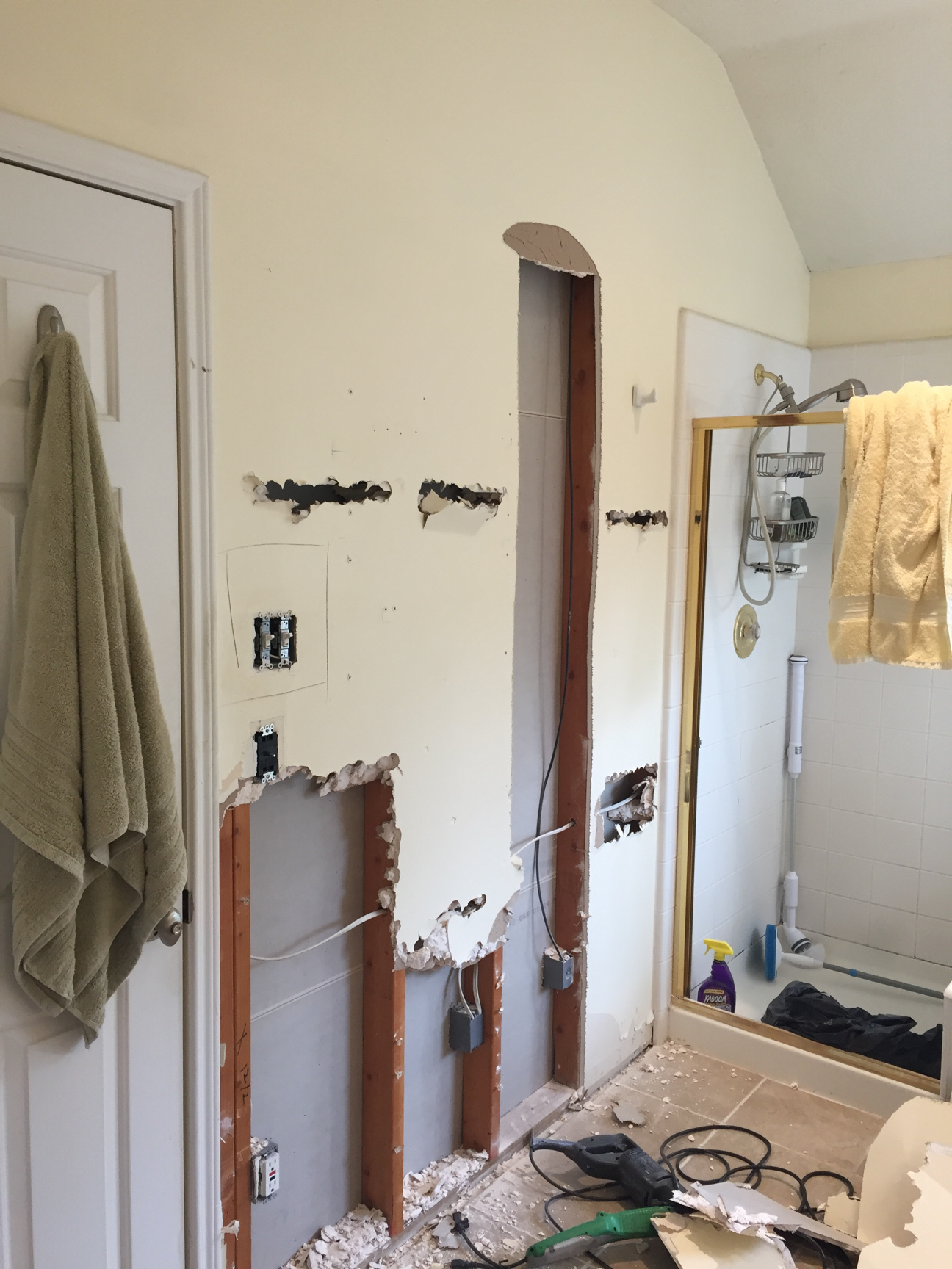

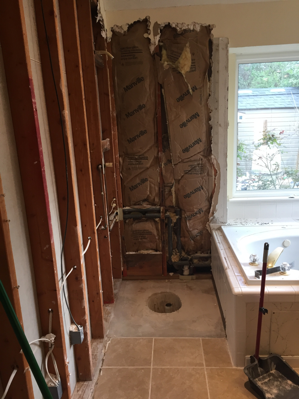

Day 2: Destroy
Committed

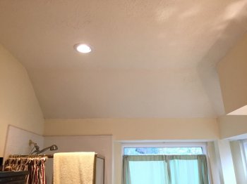

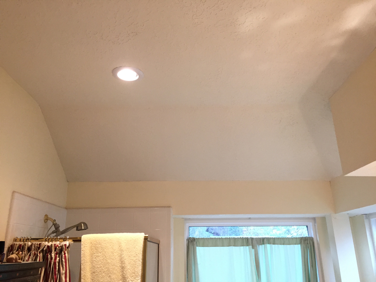

About removing drywall, the walls in our kitchen and bathrooms were originally wallpapered. A previous owner, instead of removing the wall paper decided to texture over it. Both me and my wife seriously dislike bumpy walls. Remodeling the kitchen, I did not remove the dry wall and achieving smooth walls was a big pain in the ass. For the bathroom I agreed to remove the drywall due to the bumpy walls and to see if there were any hidden water issues.
[doublepost=1519831869][/doublepost]Tip of the Day: To cleanly remove the wall drywall, and leave the ceiling untouched, use a utility knife to score where the wall meets the ceiling to cut drywall tape along this junction. You should be able to cleanly pull the wall dryway away without marring the ceiling.
Spray painting the ceiling is planned.
You’ll probably progress faster than me. Post pics! 🙂
I will post some pics also, and yup! A good sharp utility knife is a must. Prior to that, I had to have the ceiling done also. Ugh. Damn tape and mud!
We do not like bumpy walls either. For the most part all of our walls have a very mild, I mean really mild texture to them so we left them. But yeah I agree with you. At our last house, we took everything down to the beams and then rehung drywall and had zero texture applied. It was a big pain in the butt and we won't be doing that again. We have sanded it down to where is is barely noticeable in the rooms we have done but there is still just a little.

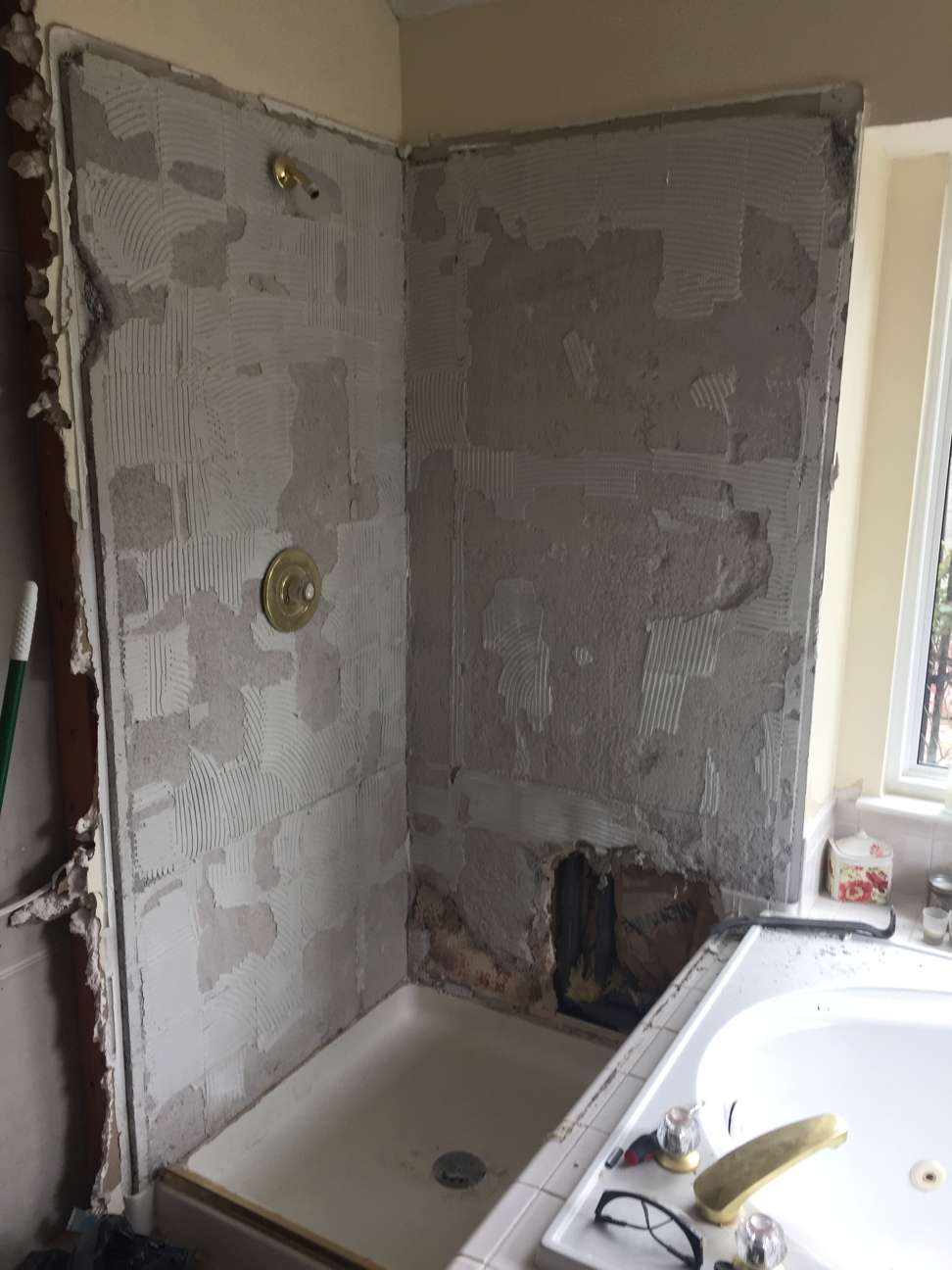

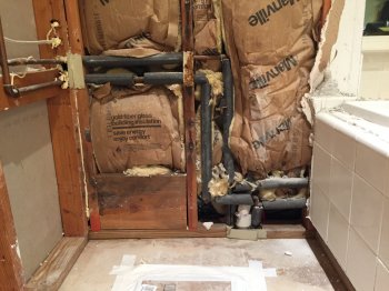

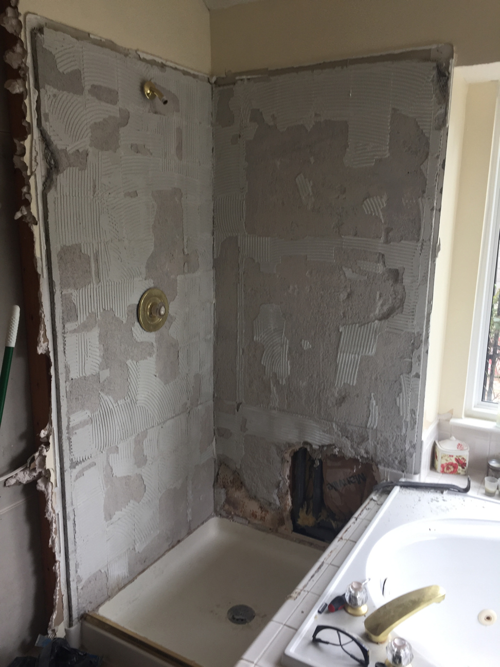

Day 3: Removed Shower Frame and tiles.
Day cut short due to tile delivery to house.
I am familiar with cement board. The material behind the tiles looks like a sheet of 1/2 cement board which is on the thick side for cement board, and I noticed between it and the drywall is a wire mesh, which makes me wonder if this is a pre-made board or they just slathered 1/2" of cement/mud on the wall over the mesh. thoughts? On the lower right there was a weak spot when I removed the tiles and the cement came off with the drywall underneath, revealing the copper pipes, wrapped in those rubber insulation tubes made for water pipes.
All of this is coming out. I briefly considered one of those small hand saws with the rotating blade, not the standard size circular hand saw, to cut out the cement and decided that would create way too much dust so I'm going to attack it with the crow bar tomorrow.

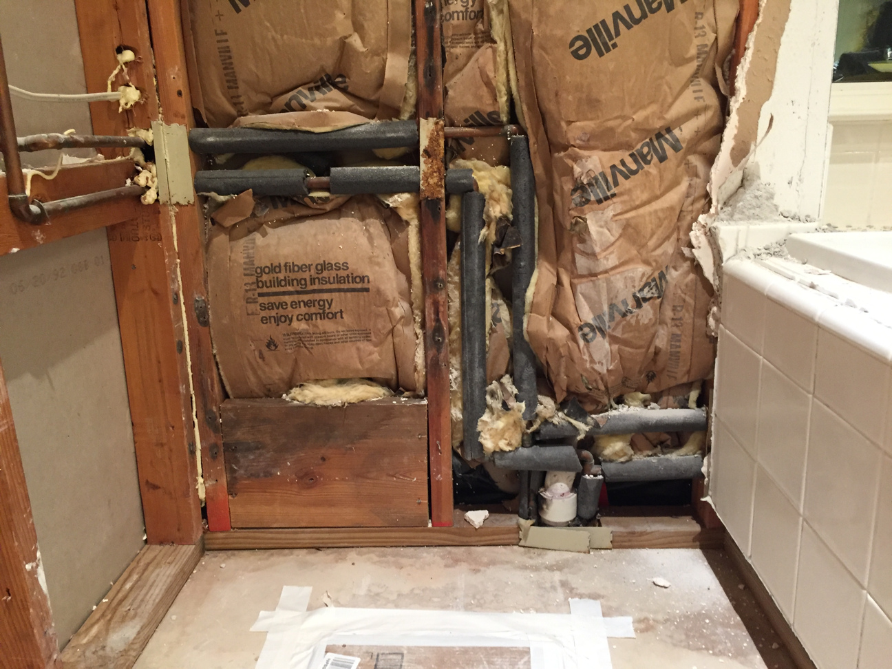

In the outside wall where the pipes are is standard fiberglass batt insulation. I'll remove that and put in a thick foam board and spray the edges of it with the spray foam to seal it for air leaks. I think that will be much better than the batt insulation currently there. I'll verify the foam has a higher R rating than the fiberglass insulation.

copper pipes along out side walls? replace this with pex and sharkbite fittings.
buy a all-in-one tool if you can get a reliable diamond grit blade for it.
use extreme caution on the dust
Good luck. Looking forward to the final result. Like Rhett, I've redone all the walls in the house. Though there was never a texture issue. First time post purchase was to gut everything and start from "scratch" second time was to gut 90% and bring in better stuff (thicker drywall, stronger cabling, etc.) and future proofed the power and energy requirements. Popcorn ceilings should have stayed in the 80s. Still see it in new home listings from time to time, and by new home I meant post 2000s build.
Ditto on the dust. Wear a heavy flannel shirt, 3M respirator mask and a head covering. Some stuff makes your skin incredibly itchy if not look like you've got hives. I speak from experience...
Yes this is Central East Texas where hard freezes when they rarely happen, last longer than 12 hrs. Of note, when we lived in Minnesota by design necessity, we had copper pipes on the outside walls, such as the kitchen sink next to a window. Those pipes partially ran through the outside walls.
Please tell me about pex and sharkbite fittings in relationship to freezing concerns.
I considered an all in one tool to cut out this cement behind the shower wall, but after discussing this with my brother who has extensive experience with house building and remodeling, I’m going to start with the prybar approach to minimize dust. I’ve been wearing a 3M respirator from the start. 🙂

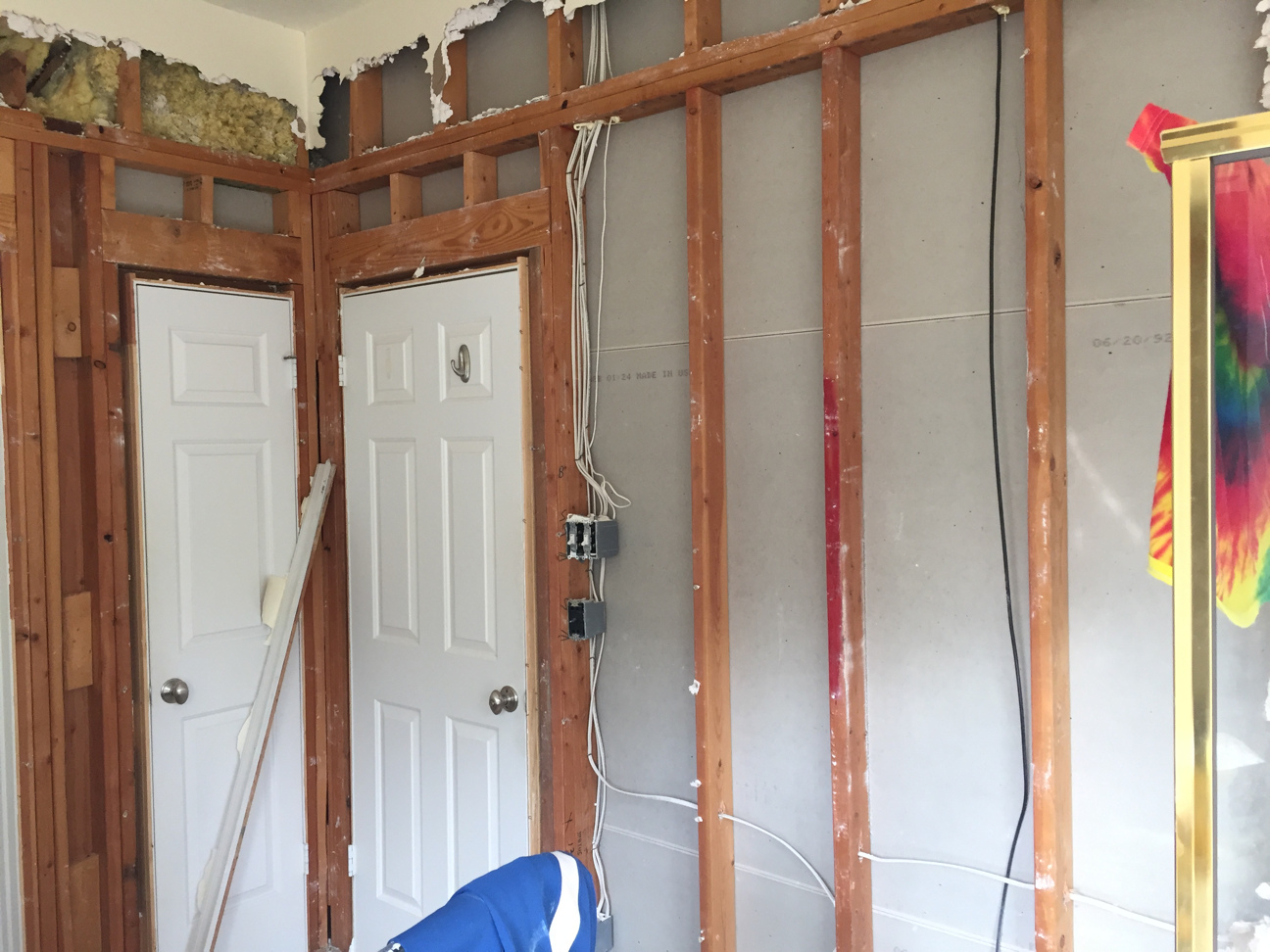

I know many Home refurbish experts recommend going down to the studs to reveal hidden problems that could exist. Watched a show once where they discovered a water line plumbed in a circle, by a previous home owner. I should have done this in the kitchen (reveal studs), but did not although I removed the drywall in the sink area to adjust the plumbing there.

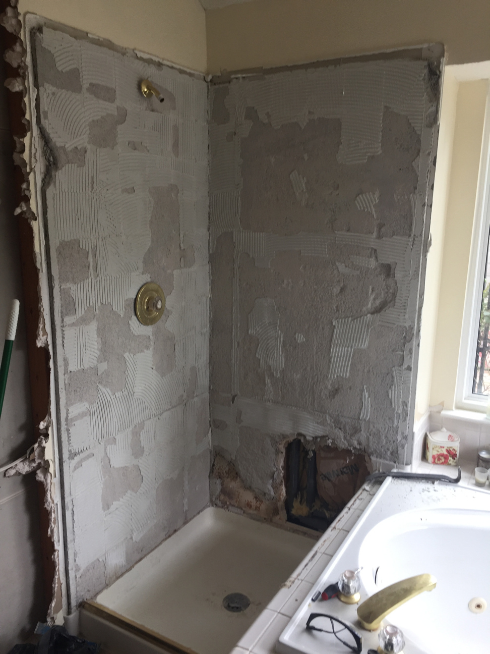

So if I understand this correctly you had wire mesh, but was it coated with anything like another layer of mud? On our current bathroom, we had about 3/4 of inch worth of mud and wire underneath the tile which had about an 1/8 of an inch worth or mortar. Pain in the butt to pull up.
We opted to use a pry bar, hammer, and one of these tools to take it out. Dust being the big concern as others have mentioned, I too get itchy with some of the materials that I have used a grinder on, so I opt out for brute force now lol. Not to mention it gets EVERYWHERE! If you can close the area off with one of those plastic door ways with a zipper, that helps, but you still get it on you etc. To me it wasn't worth it since I could just pound it into submission lol.
Reactions: Huntn

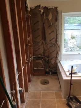

Day 4: Shower Gone
Shower Removed
It was a half inch of mud on a wire mesh which surprised me because it seems like that would take a lot of work to install and keep it all perfectly the same thickness so you don't see variances in the tile. But apparently whoever did it, knew what they were doing.
I ended up using a pry bar and a hammer. Before starting I eyed a grinder at the store, but the associate seemed adamant that it's not designed for this kind of an application and it generate a lot of dust. So I opted for the pry bar hammer and that worked well. I have 10 large bags of debry out for pickup tomorrow. It accumulates fast! In many cases, the bags could hold more, but if I make them too heavy I have trouble moving them and the trash men won't take them.
Outside Wall
This is the first house I've lived in on a concrete slab that did not have a basement, although in college my Mom's house was on a slab too and I visited for the Summers. Anyway, see that white PVC pipe in the wall by the floor? This is where the water supply appears to come up from the floor. I'm a bit curious because the water comes into the house by the dining room on the opposite corner of the house (a rambler) and from there I thought it went up into the attic and over to the water heater which is also in the attic, along with the furnace. So I assume the water was distributed through the walls coming from the attic which apparently not so. My wife is dying for a water softener, but it appears that the only way to install one is on the outside of the house to catch all the water avenues through the house. 😳 Anyway I digress.
The white PVC pipe goes straight up to the roof, so it's a vent, but I've never seen a vent that comes out of the floor like that. In previous houses I've lived in, plumbing vents are built into the visible plumbing but as stated, I've always had a basement before.

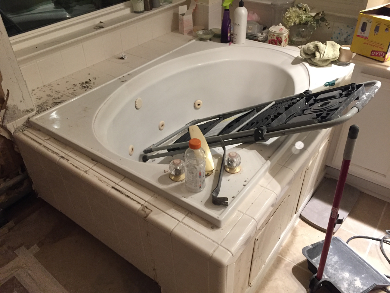

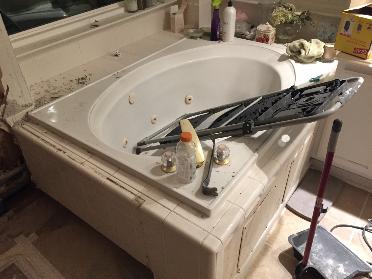

The Next Day's Target
Tub Removal
Reactions: A.Goldberg
