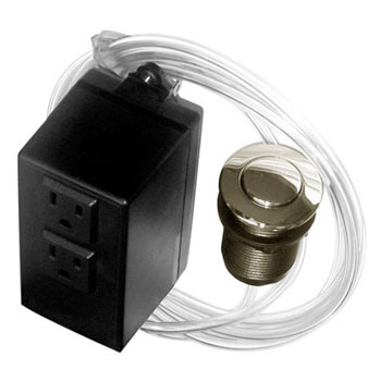

Here's an idea for relocating the garbage disposal switch that I've considered doing myself. An air switch:
http://www.faucetdepot.com/prod/Wes...tlet-Control-Box---Stainless-Steel-144680.asp
You mount the 'switch' right beside the sink which, IMO, is where it belongs. No electrical either, for safety.
How does an air switch work me wonders? And why is that better than having an electrical switch? I assume an electrical on/off switch is still needed somewhere.
Here's another model with a brochure that will explain. Nice diagram too. http://www.insinkerator.com/en-us/Documents/Disposer/sinktop_switch_brochure.pdf
Basically the switch is right on the sink - beside the faucet for convenience. The switch is really just a plunger/piston type thing. Think of two hypodermic syringes connected by some aquarium air-line tubing. Push one plunger down and air pressure pushes the other one up. Put an electrical microswitch within its reach, and it's triggered.
I like the safety aspect, because all the electrical gubbins are well away from where you'd be touching the switch (likely with wet hands if your as careless as me!).
Thanks for the info! However, switches and switch plates are constructed so that you hands can be wet and should not result in a short or shock if touched.
True, but if you've been boiling a steamy pot of pasta on the back ring for the last 15 minutes, the switch could be saturated.
Admittedly not such a big issue with US voltages. That said, I spent most of my life (and two kitchen remodels) with 240V which can be 'livelier' 🙂
