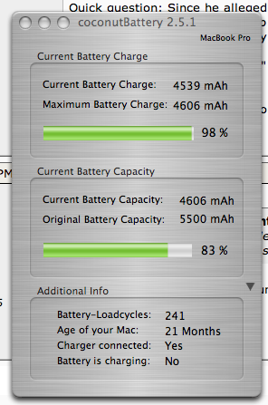

Just for fun, I'll post mine. I should mention that I bought my machine refurbished in November 2006, and it included a new battery with zero cycles when I received it. So that's 241 cycles in 11 months, not 21 months. Not too bad, I suppose.

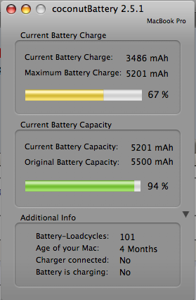

This is how mine looks like right now.

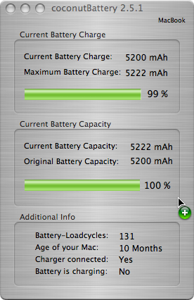

I saw this thread and decided to test my battery. How can the current capacity be higher than the original capacity?
