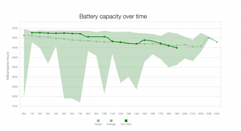

Don't know to be honest, looking at Coconut battery online, the trend is obvious, nor is my 2015 rMB wildly outside of this current trend. It`s disappointing as I have always got at least five good years of usable battery life (80%+) with all my other portable Mac`s. My rMB will be lucky to reach two years at the current level of depreciation of the battery capacity.
