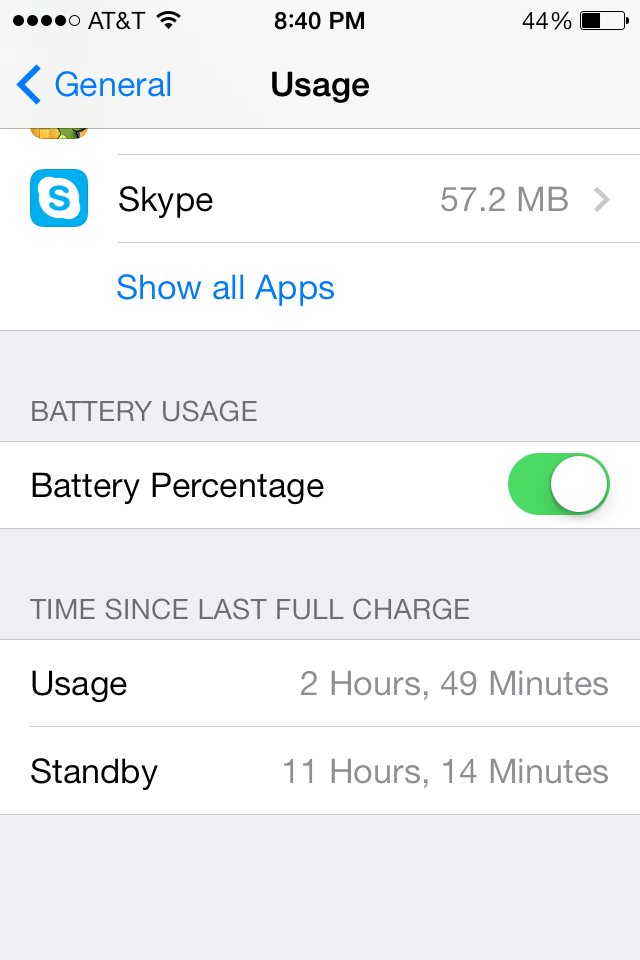

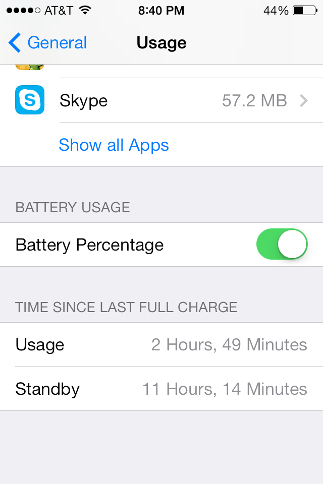

Update on day three.
It seems like my iPhone 4S battery is getting really much better every day. I did let it "die down" twice (hardly by choice though!) and did two full recharges. Not only did it calibrate the battery, and that´s always good, but now it seems to perform noticeably better. It´s still too early to tell, so I´ll do more testing tomorrow, but right now the stats read:
Since last full charge: USAGE 7 HRS 57 MIN, STANDBY 1 DAY 3 HRS , with battery right now at 74%.
It´s actually probably even better than with iOS 6, but again too early to tell.

Here are two screenshots of my usage. One taken the other day, the other one right now.
Just to illustrate the HUGE difference within only a few days!!
That´s not correct, because you have already Charged your iphone since the last Full Charge. So we cannot say for sure what is your real usage ( without charging in between ). That Would be too good to be true.
I charged my iphone last night at midnight, after I let it drain until it turned itself off, and left it to charge until I woke up. Turned it on today at 10 am and these are the stats (last screenshot). I did not charge it at all today.
If u turned it on, today @ 10 AM, how do you already have 1 Full Day ( 24 hours ) of Standby 😉 ?
Exactly! That´s why I said it is weird and I am not sure if its a bug like someone else suggested or what. Hence I´ll keep observing the stats in the next few days or so.
Stats aside, battery life is noticeably better today, so I hope the usage will display correctly in the near future as well
If you take a look at your screenshots you will notice under stand by that it says "iPhone has been plugged in since last full charge" so you might have connected with usb and it has been chagrin the batt as well. Such usage and battery life are absolutely impossible to be made with any iphone without additional charging.
Battery life fine. I have been using the phone much more playing with the new features and getting used to the look. As for the poster who said his phone wentbromm 100% to zero overnight I cannot understand that, mine went from 100 to 97 overnight (9 hours)
I don´t doubt those stats are off, but I DID plug in my iPhone only last night until it fully charged and I have not charged it or plugged it in since. So yeah something is off in the readings. Overall my battery is good though now, so much better than yesterday.
