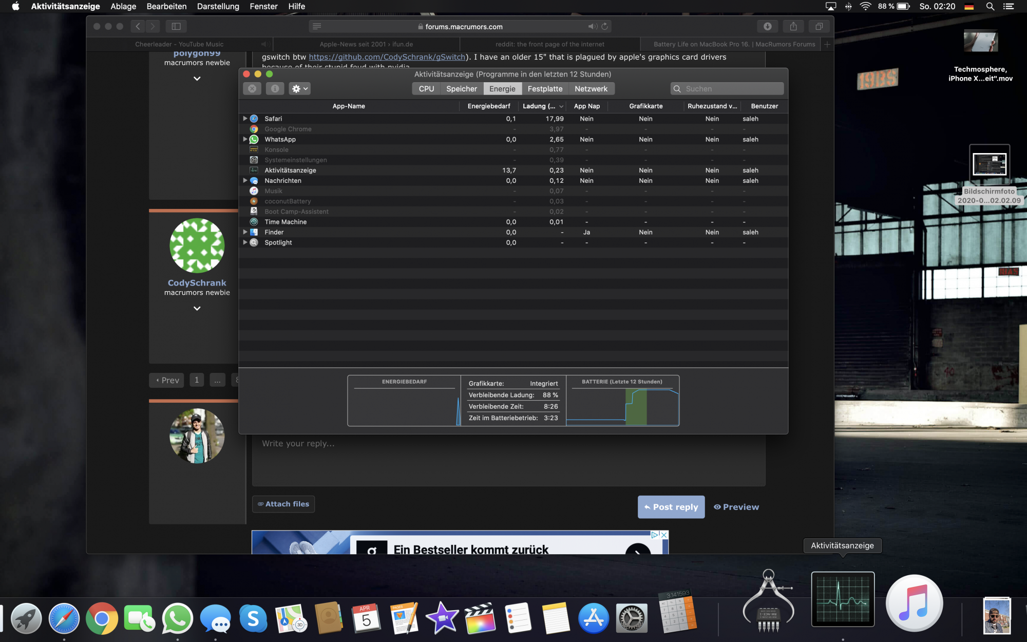

The activity monitor is not a reliable way to determine which gpu is being used. What graphics card does gSwitch say your computer is using when you open those applications? And if you try to force integrated does it switch to your integrated gpu?
Hello folks! I joined the MBP 16 Team 7 days ago. My battery life is doing good so far. I get 6,5h to 8,5h in my mixed usage of browsing, streaming, bluetooth, watching YouTube Videos mostly on Chrome, WhatsApp and iMessage. My fans are never getting loud only when I do intense tasks like Final Cut or gaming. I can even watch a 8k Video on Chrome and my fans will chill out 😀 Overall heat consumption is great again. It's always cool only gets hot while doing something hard which is quite normal. I switched from my 2014 MBP and so far so great! Here is my estimated time while using safari with 4 tabs open and streaming music while connected to bluetooth. (Basemodel i7 with 16gb RAM)
When i use a adobe app like photoshop, illustrator or indesign activity monitor says these apps use dGPU. but today i noticed, when i dissable dGPU my external monitor wont work - so maybe as you mention the activity monitor just tells bollocks 🙂

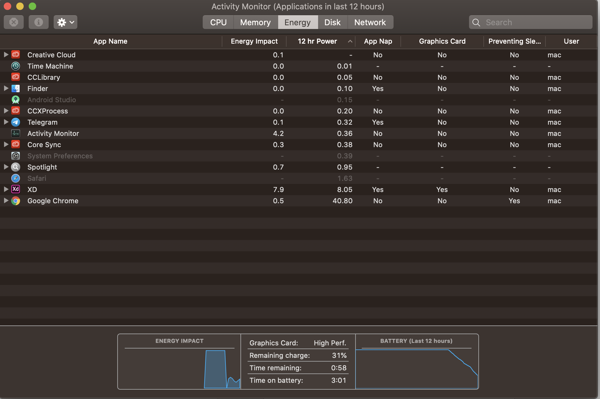

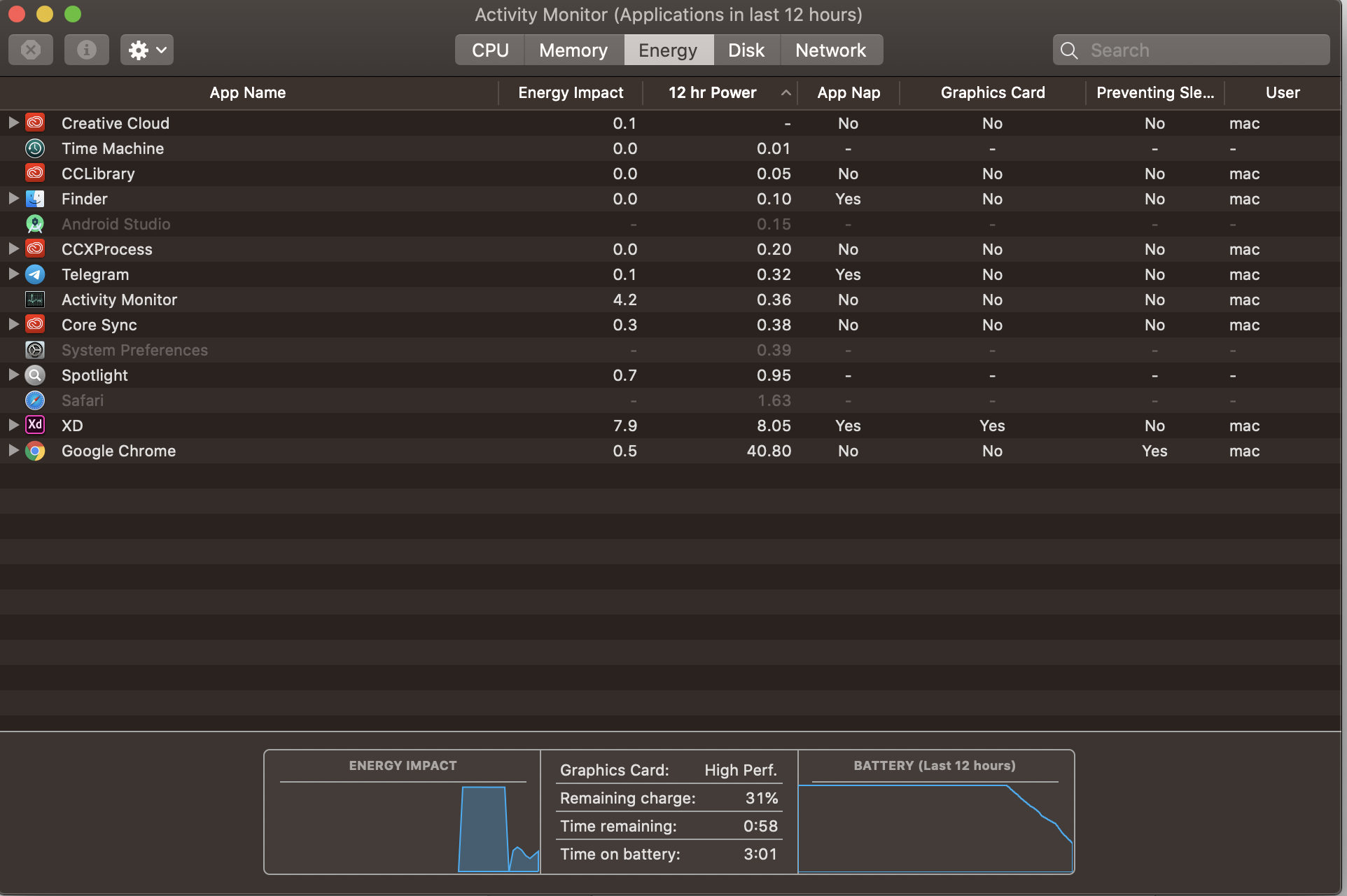

My MBP 16 (i7/16GB/512GB) battery is totally horrible. I just do some web browsing using Chrome and do some work on Adobe XD. I'm getting about 3 hours of use only while Adobe XD is not a heavy app at all. It simply just doesn't meet my expectations. Really disappointed!!
You are getting it wrong. If Apple says 11 hours on their website, it doesn't surely mean that your use case will also get 11 hours of battery life.
For example, playing 1080P video test. It is always much greater battery saving, if you watch 1080P, which is on your SSD and running it with built-in player.
But, playing 1080P video with Chrome(Difference 1) in youtube with wifi (difference 2) is just another thing, which adds up 2 extra processes to handle.
Also the brightness is a key factor in a judgement. They usually test it at 150 nit brightness, which is truly dark image in almost all cases, except the night with no lamp in the bed movie watching. Also movie has to be somewhat bright to be viewable at 150 nits. Otherwise you won't see anything with 150 nits on the movies like Matrix, Harry Potter 3, Dark Knight and etc.
Third, Adobe XD is a third party app. Ok lets imagine: you have to move some tables at your workplace, because someone told you so. This is an extra job for you, because you were not supposed to do that but asked. On the other hand, you do move stuff in your own house and it is not considered as a job, because it is your own property and interests.
This way Adobe is external app which doesn't belong to Apple. Considering how awful optimization with Premiere, we can tell that it is not optimized at all. So you running an Adobe XD is equal to someone running COD: Modern Warfare in Windows under Bootcamp.
But if you use Safari, Notes and any built-in application, you will be good to go for 11 hours.
When you buy a car, it also has some stated fuel efficiency. But that is calculated using 1 average driver at 160 pounds(80 kg), cruising at a speed of 56 mph and using special reference gas.
So if you are able to replicate this, you will get the promised mileage.
But if you are riding with a family, which weight more than 160 pounds in sum, running at off road or highway above 60 mph, and if your truck is fully loaded, you can't expect promised mileage from the prospect.

Thank you for your explanation. But I expected something better than this. My friend runs the same usage as mine (browsing chrome and adobe XD) on his MBP 13" 2018 model, but he gets about 5-7 hours. I wonder if there's something wrong on my model.
Historically it has been this way every time. You could always get more hours out of MBP 13 while doing the same non-intensive tasks. And MBP Air even outperforms in hours all of the other Macbook Pros.
Because MBP 13 2018 has 28W TDP CPU, and MBP 16 has 45W CPU.
So Ford Focus and Ford Explorer can get you to the same point almost equally, but SUV will consume more gas. That is the story.
I have noticed from your screenshot, that your discrete graphics stuck at high performance. That is the main battery drainer here. So you have to investigate, which app enables it and uses constantly. And look for 3rd party apps to switch manually between iGPU and dGPU.
For maximum battery life you can set machine to only ever use igpu on battery with pmset, and only allow dgpu when plugged into power, if that's an acceptable compromise.
