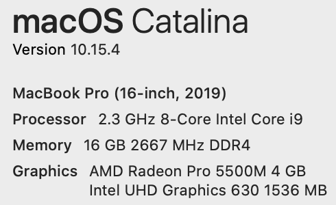

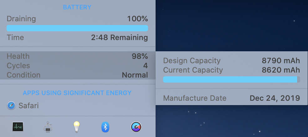

Hello I would like to know if it is normal for an end November 16inch MBP with 29 cycles of charge to get already 3.2% of Battery degradation ?

So I think this pretty much explains everything.
This is the second MacBook Pro 16" I've purchased directly from apple.com. The first one, with exactly the same specs, have exactly the same issue which is battery degradation. Well, to be specific, there is a difference between the two situations: the first one took about a week to drop from 100% battery health to 89%, while the second (just received 12hrs ago), COMES with a 89% battery upon open box. I bought an AppleCare+ for $379 because the battery experience I had with my previous MacBook Pro (13" Mid-14'), but I certainly did not expect to have such issue this early, especially with the 11 hrs battery life as advertised. I already tried the triple PRAM and SMC resets method suggested above, but so far, nothing happened. Does anybody have similar experience with the 89% factory battery? Should I return this as well? :C

I had the similar issue (90% battery health out of the box). Try to uncharge your battery to 0% then charge it to 100% and keep it with power cable plugged in about two hours. Then reboot your Mac and open coconutBattery. It helped me to increase battery life from 90% to 100%.

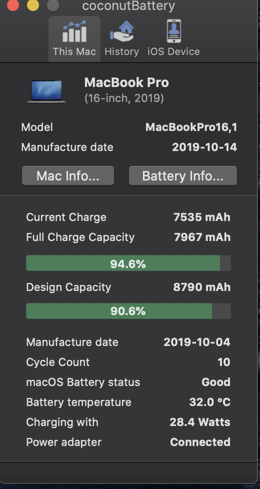

So I got a good news! After using the method @SNPR suggested, which is to drain the battery to zero till the machine shuts itself down, and charge (overcharge) it for an extra 2hrs after 100% "fully charged", my MacBook Pro 16" was able to restore its capacity from 88% to 97%, according to iStat Menus. I haven't decided if I'm going to do that again just to try to hit that 100%, but I'll keep y'all updated if find anything new. Big shoutout to SNPR. You made my day 😀

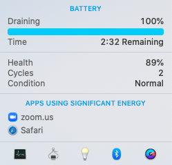

I have tried both methods : SMC reset and battery drain to 0 and full charge + 2 hours
Result is worst !!! Now 95% of capacity with 31 cycles (before 97% with 30 cycles...)

I know that but a user here (SNPR) wrote on this that doing this solved its issue Battery helth from 90% to 100%... So I made the teste and I do not think that just one time to 0% can destroy battery at this point. I wonder if there is not a bug in Catalina battery health calculation...
