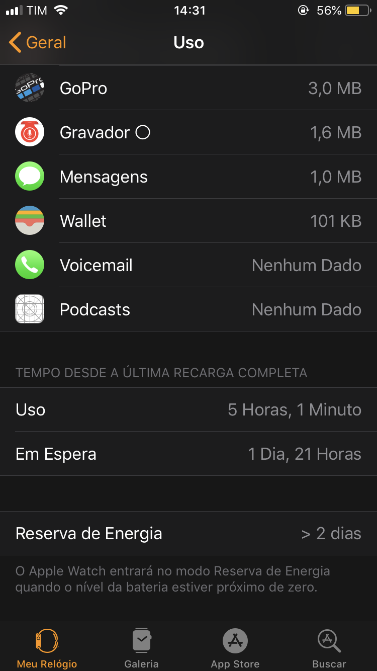

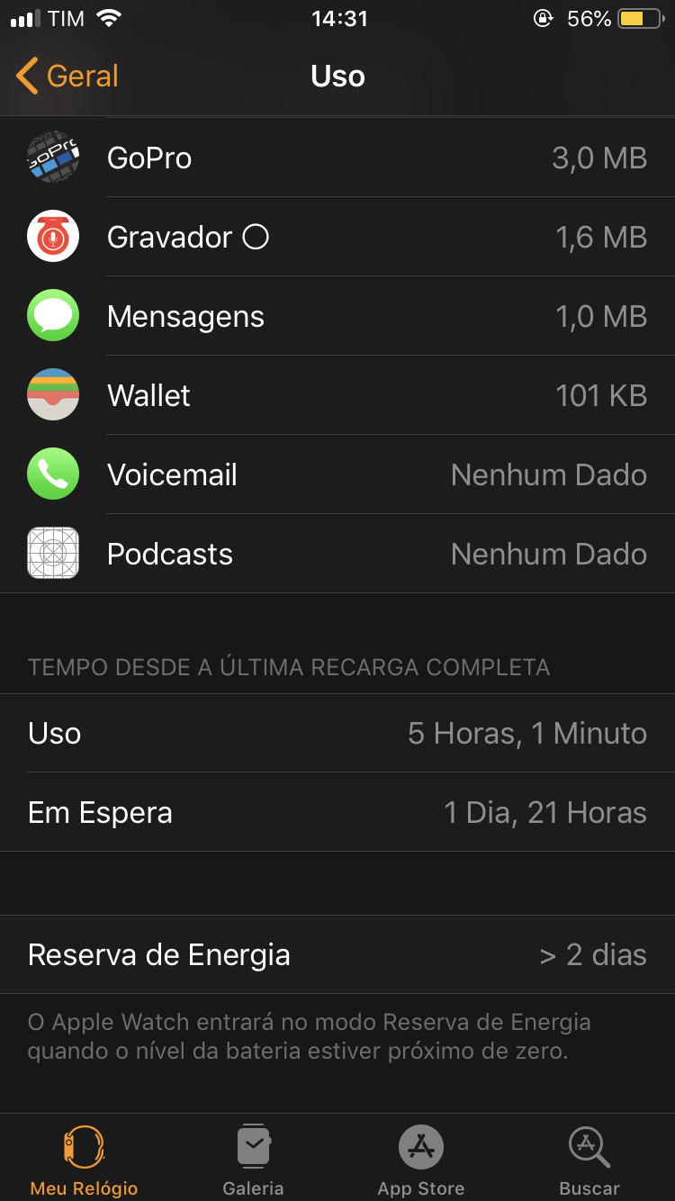

Hello. I went to the assistance and as I expected, they didn't exchange my watch. According to them, the battery is normal. However, they suggested me to charge the watch with iPhone charger. So, I removed the heart rate complication and charged with iPhone charger. The result was much better. I usually get 1 day and 8 hours in standby and after that, I got 1 day and 21 hours with light usage.
