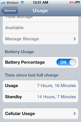

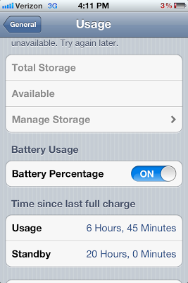

Here are my before and afters
BEFORE
AFTER
