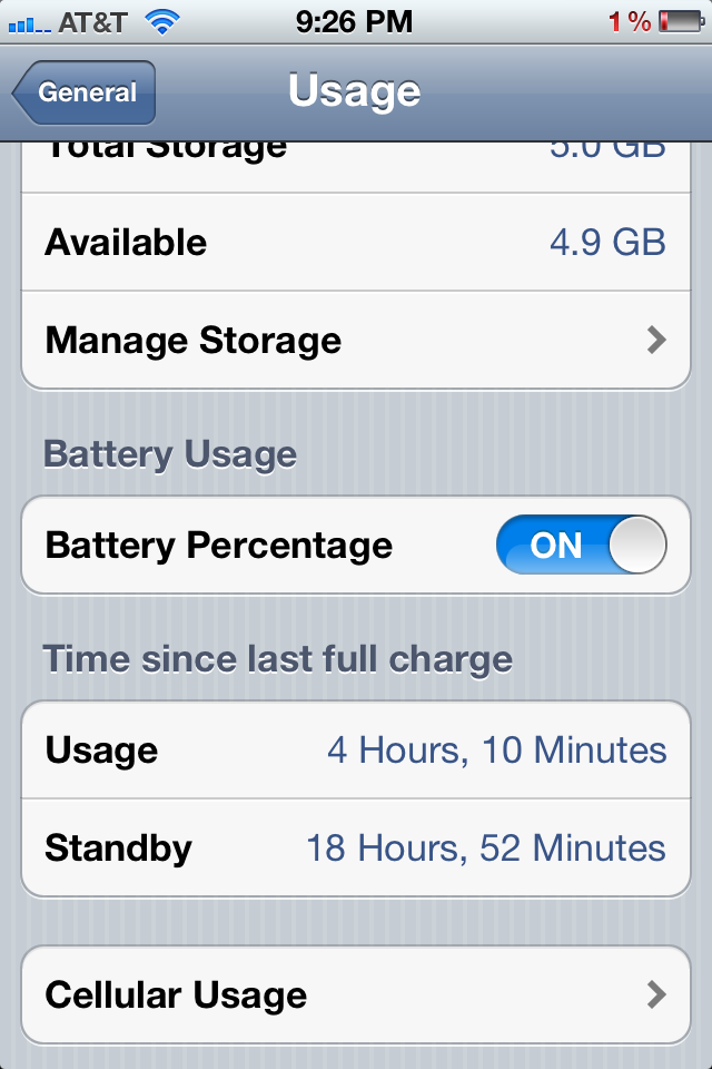

The pictures below are my difference in battery.
The first (left) is after my first complete discharge, minutes before the phone died.
The second (right) is tonight, at 18%, minus about 30 to 40 minutes standby from charging.
-William
